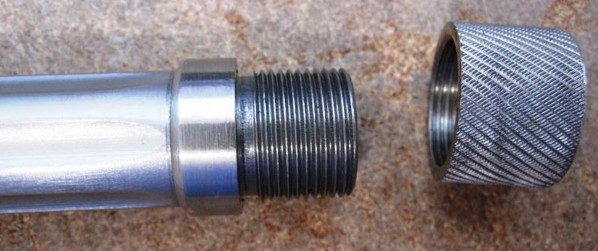

I'm looking to have my T3x Superlite in 300wm cut down to 22" and threaded so I can use my Griffin Paladin on it. Any advantages one way or the other between threading 9/16"-24 vs having a stepped shoulder machined like this to allow for 5/8"-24 threading?

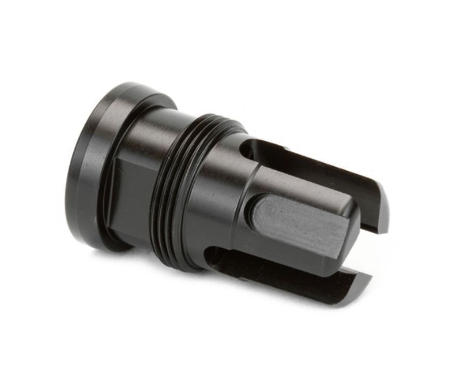

If I go 9/16"-24 I'm limited to the steel flash hider where as if I go 5/8"-24 I can get the titanium brake.
It has to mount my suppressor so there's only so many options. The only real option for 9/16"-24 is the steel flash hider. 5/8"-24 does offer some more options. I'd go with the ti muzzle break. I'm sure the one ounce savings with the ti brake would be offset by the added material to create the shoulder so that doesn't really matter. Do the 5/8"-24 threads with machined shoulder offer an advantage in regards to accuracy and/or durability?

If you are sticking with the factory super lite contour and cutting it down I don’t see how/why a step up shoulder is possible?
Obviously the 5/8 would be the stronger choice.
Sticking with the factory super lite barrel though I think the 9/16 is your only option. You can’t step a shoulder up to where the material doesn’t exist for you to do so in the first place.
The Tikka sporter barrel is too thin to thread 5/8x24 and have a shoulder, even down to 17”.

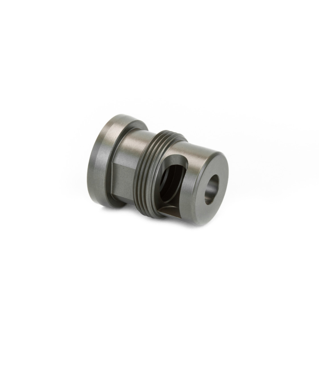

Slightly different than you since I have a tbac ultra 7. I sent my t3x lite to Thunderbeast to have them mount one of their face mount brakes. Uses the face of the muzzle as the shoulder. Threaded 9/16 underneath.

I just bought a SilencerCo hybrid 46m with their BOGO deal and will be getting an omega 30 as the freebie. I’ve had the tikka for a few years and would like to keep it and make something work. Just seeing what options are out there. I really like that TBAC muzzle indexing solution with the brake.
