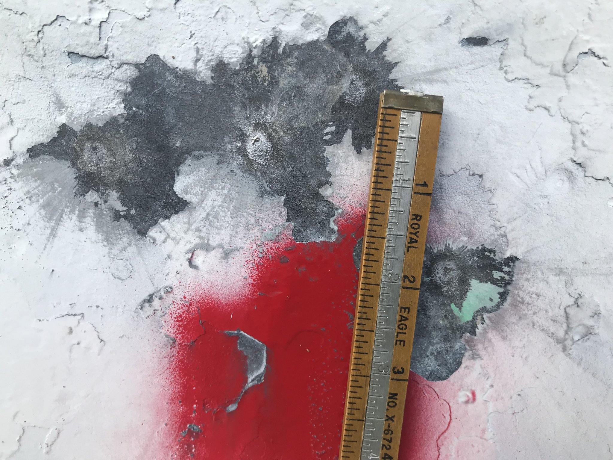

    Did some testing with Alpha Munitions New SRP brass. Same load, never touch the seating die etc. so jumping extra .040” over my original seating depth. Here is a pick of the results. 5 shots at 740yds.
    Nice shooting
    What powder/velocity/barrel. My math says that's around .007 per 100 rounds, a bit on the quicker side of the spectrum. Cant argue with results on the target. I'm primarily interested in learning if the cooler powder/lower pressure theory has substance to it regarding barrel longevity.

    I run special short chamber so that could be part of it. H4350 3120fps with 41.6gr. Bartlien barrel. This is also with hard match use. 200-300 rounds per weekend. Have 2 big matches and a 1 day match on it.
