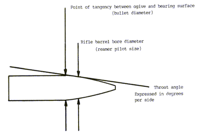

Thats the thing though the minute variations between bullets profiles arent minute with respect to what we are trying to measure. And its not directly at the start of the bearing surface that the bullets are first touching nor where we measure either.
Finding the point where the bullet goes from floating in space to tangentally touching to jammed at the maximum diameter is exceedingly difficult so we dont do it there.
Depending on the shape of the nose where they actually touch the lands can result in a different reading than where another different bullet design touches, hell even the same design can have a significant variance in between lots. You have a curved bullets ogive interacting a linear plane of the lands and getting a reading from a location thats different from the tool used to seat them.

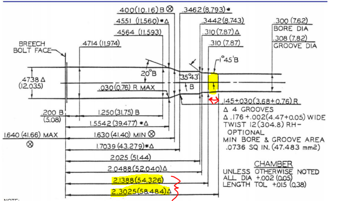

The grooves are .308, the bore is .300 in a 30 cal barrel. There is .008" of difference between the start of the lands and the full profile of the lands and that .008" of difference is spread over .1637" (2.3025-2.1388) in a saami spec chamber with a 1.75° leade angle. And thats text book, not even accounting for real world deviation. And that bullet doesnt touch at the .308 max diameter, it touches somewhere further forward and down smaller on the nose than that.
If the lands were 90° perpendicular square to the bore instead of angled and the bullet were a cylinder rather than a curved surface so that the did contact at the max diameter then same then the same caliber/same location thing would hold up. But thats not the case.
Now, thats not to say that the coincidence of having one bullets reading end up close to one another is an enigma, its just far from a sure thing.
