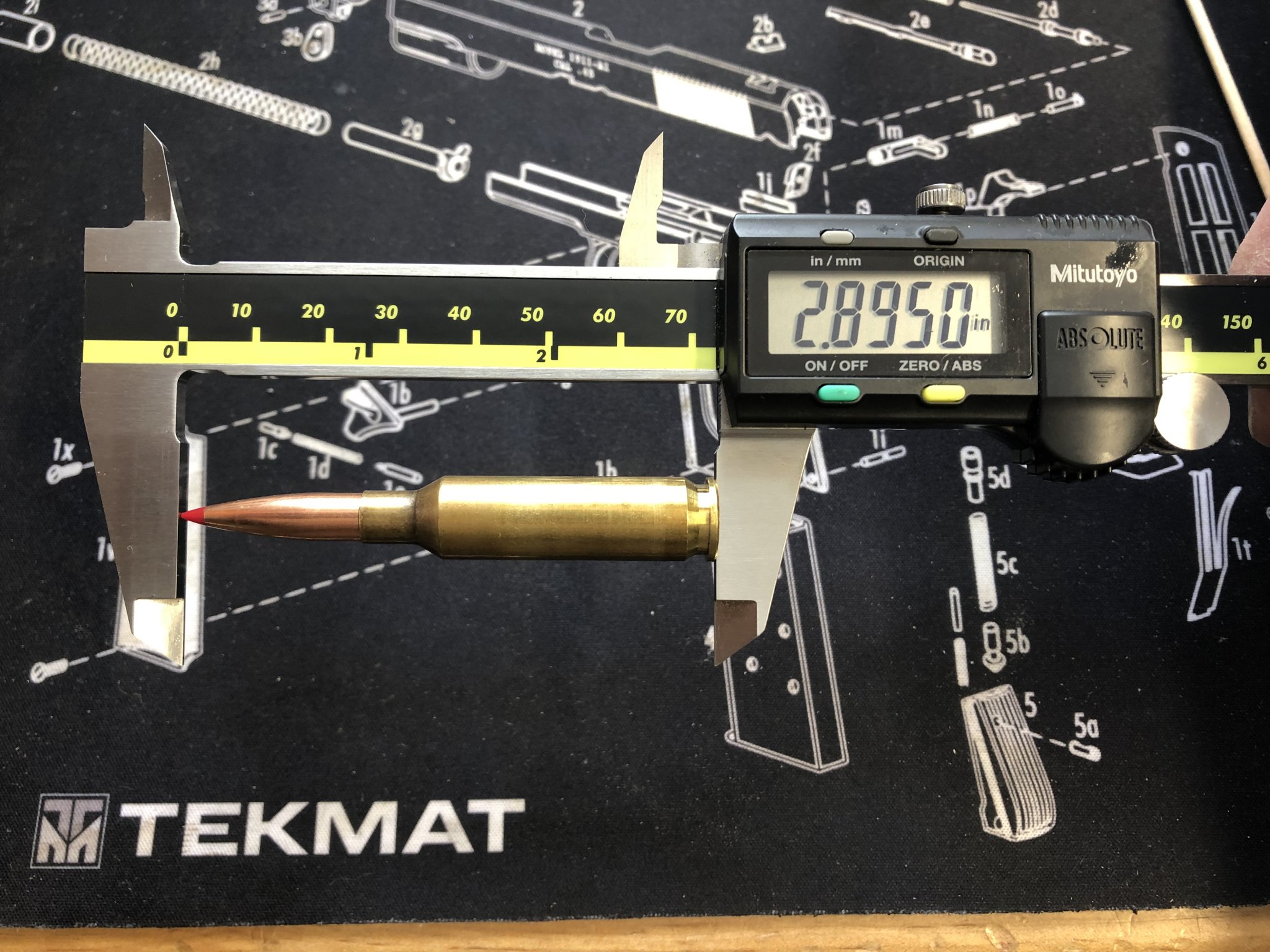

My Tikka has a ridiculous throat. 2.940 to the lands with the 143 ELD-X. It shoots just as ridiculously well though, so I struggled with changing things. I opted to a .170 freebore reamer from JGS and a 26” Bartlein tovreplacevthe sliw 20” factory barrel. The thing about freebore is, ifvthey actuayfolliwed saami it probably wouldn’t be so bad... but I’m pretty sure these super long throats aren’t saami either. If I can get down to the 2.870 or shorter my CTR mag should feed better.

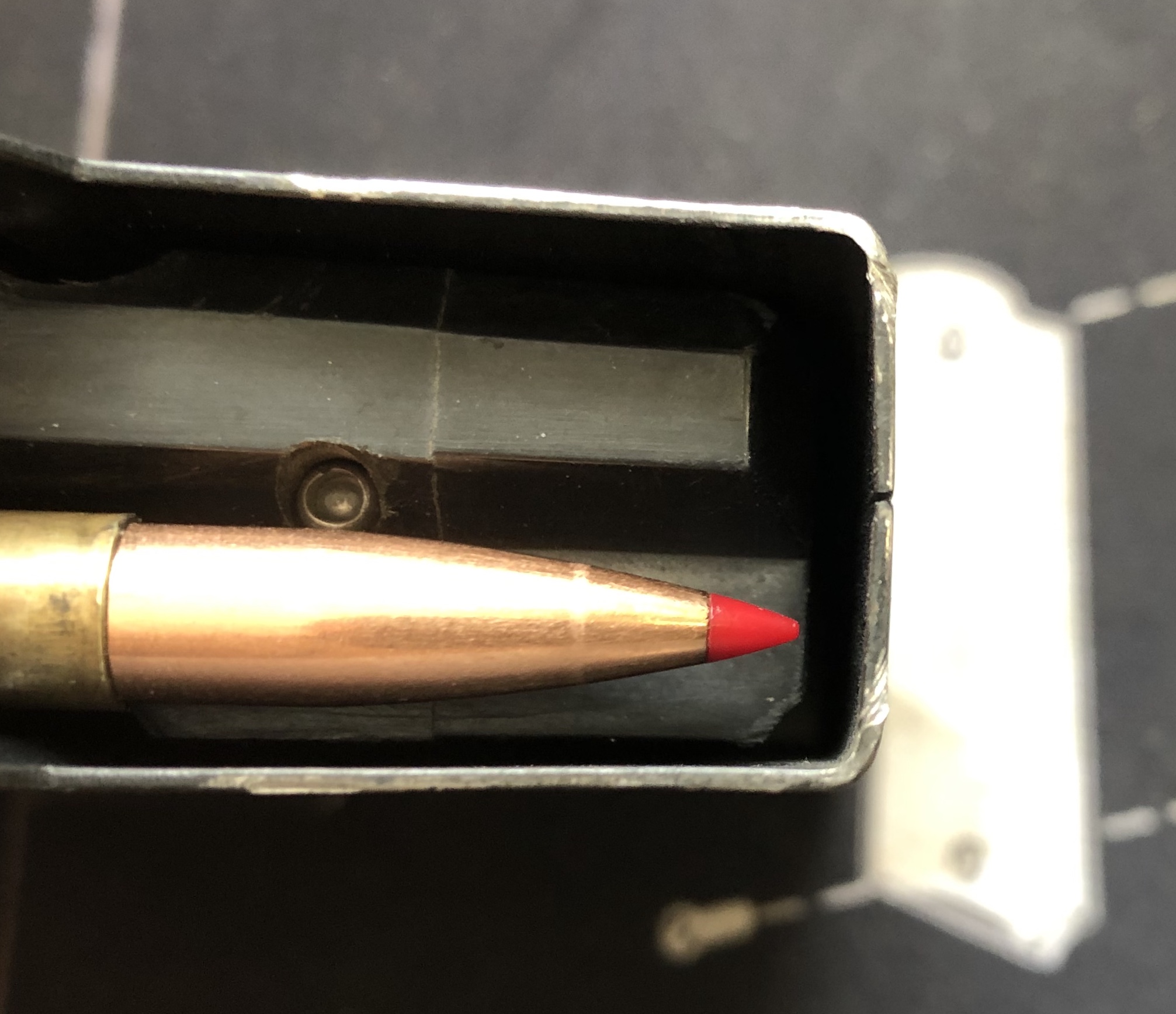

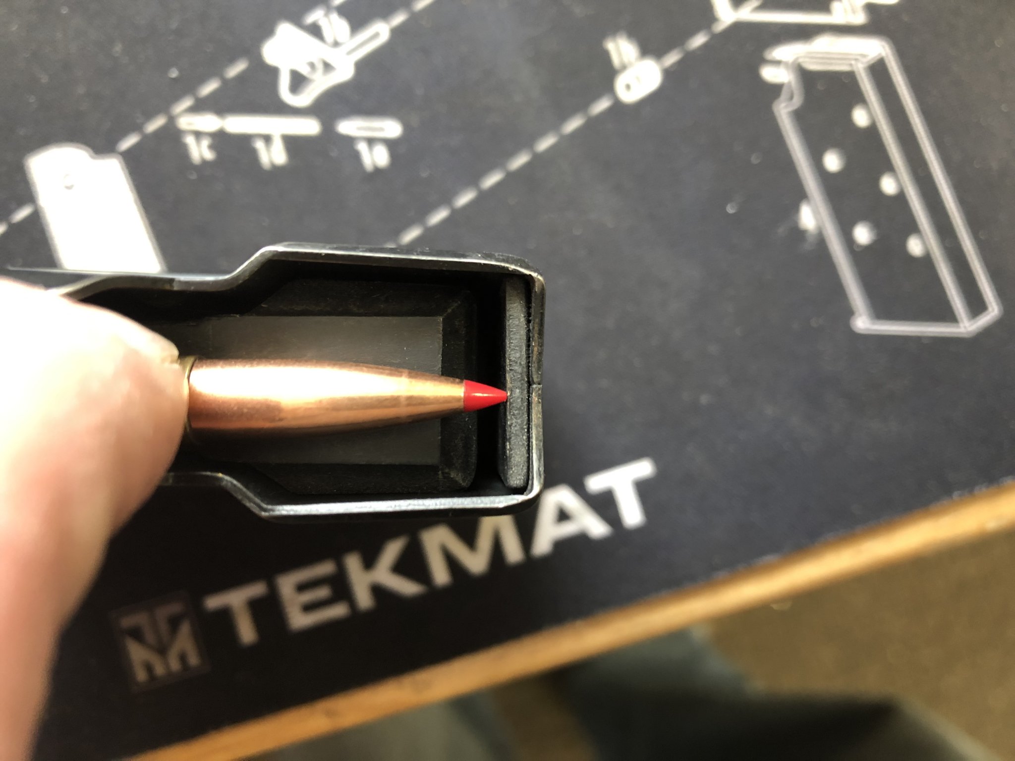

I had all the parts handy so I made a dummy. With my saami reamer, touching comes in at 2.895. That’s about .005 long for my AICS mags(unmodified). So with some jump they’d work, but you’d only have .025 to chase. These mags vary a bit as well. 2.895 fits easily in an AW magazine, which is what I use.
AWmag
AICS mag
Edit: Is there a reason you want to run the 147? Unless you’re handloading, I don’t think the factory ammo really makes those worth it IMO. They end up being pretty much identical to the 140 downrange.

Well I decided to go with the 147 eld hitting lands at 2.81. Got some of those loaded as well as some 140 vld. And was happy that the 135 Berger factory ammo fed without issue and did not contact the lands. So we'll see how the Hawk Hill #2 at 22" does here soon hopefully.
Got to range today. The shorter throat sure shoots well. The very first 3 rounds were the Berger 135 Classic Hunter factory loads. Very low ES and very accurate out to 500 yards today. It makes an easy factory choice if I decide to just buy factory. This Hawk Hill 8 twist chambered in a weeks time by shaenrifles.com is sure shooting everything well.

Here's the data I have recorded base to ogive
600 rounds: 2.2280"
1,000 rounds: 2.2358"
New box ammo: 2.1960"
2.228 - 2.1960 = 0.032" jump
2.2358 - 2.1960 = 0.0398" jump
Working backwards, the math is bang on for a 0.030" jump when new.
The 140 ELD, like the other ELDs, don't mind a jump. Shooting factory ammo and jumping .070" it shoots great in my rifle. Used a tuner to tune harmonics and got it to 1 hole 5 shot group so the bullet jump is not an issue. Most load to the .030-.010" as they can and like being closer. I load mine at .020" off because I can. So not sure what to say but I would say no your rifle was not a SAAMI .199 freebore chamber. What rifle is it?
