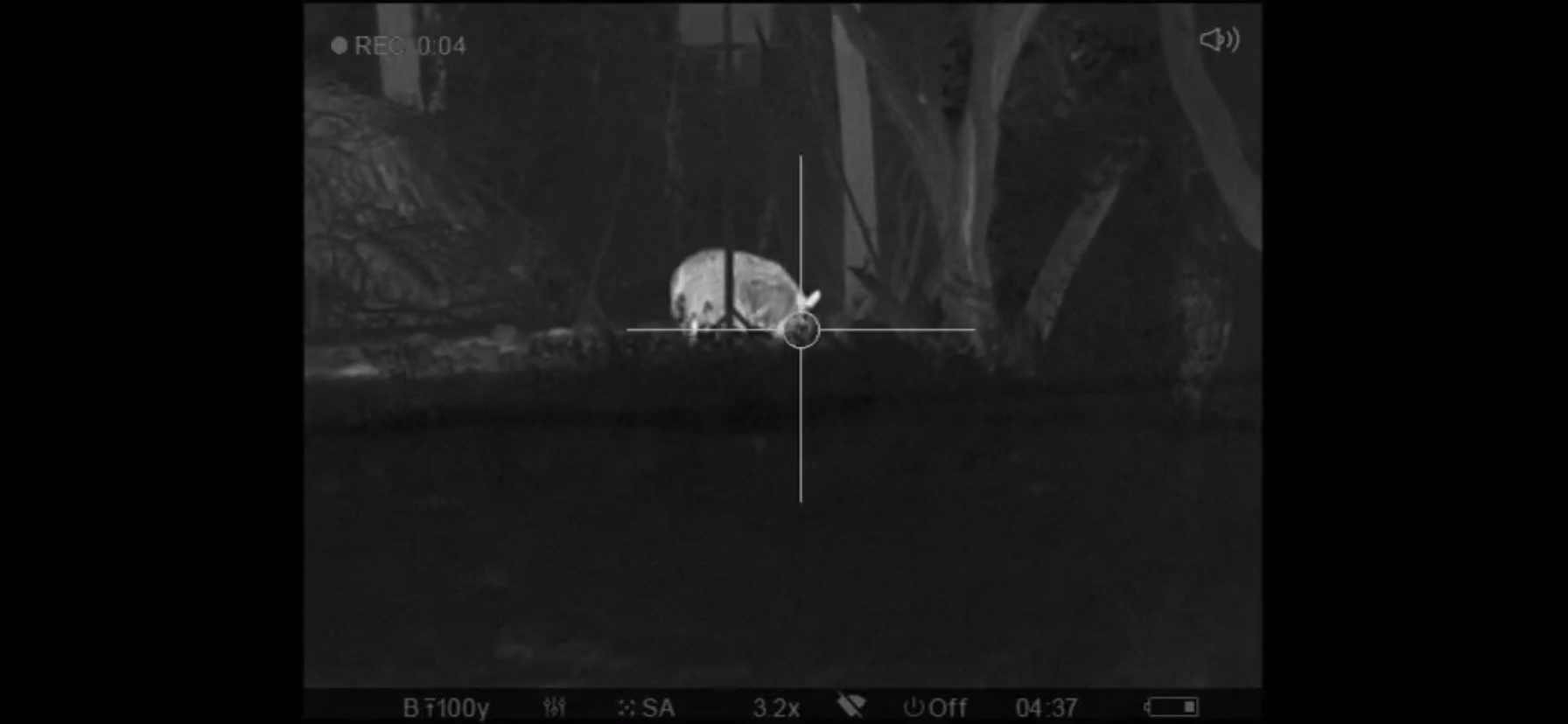

    Sounder at about 50 yards through a Trail XP50 at base magnification (1.6X).

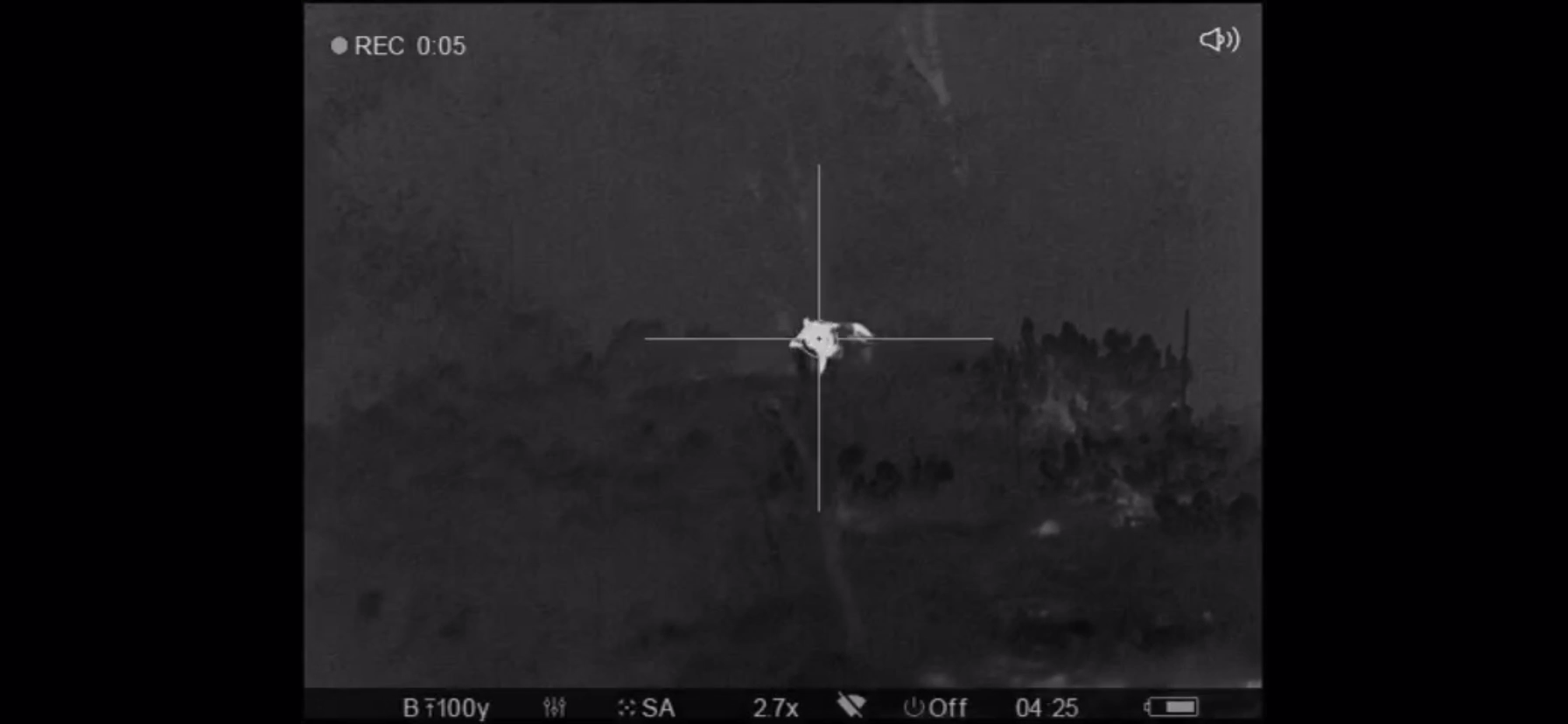

    Large hog at about 65 yards through a Trail XP50 at 3.2X.

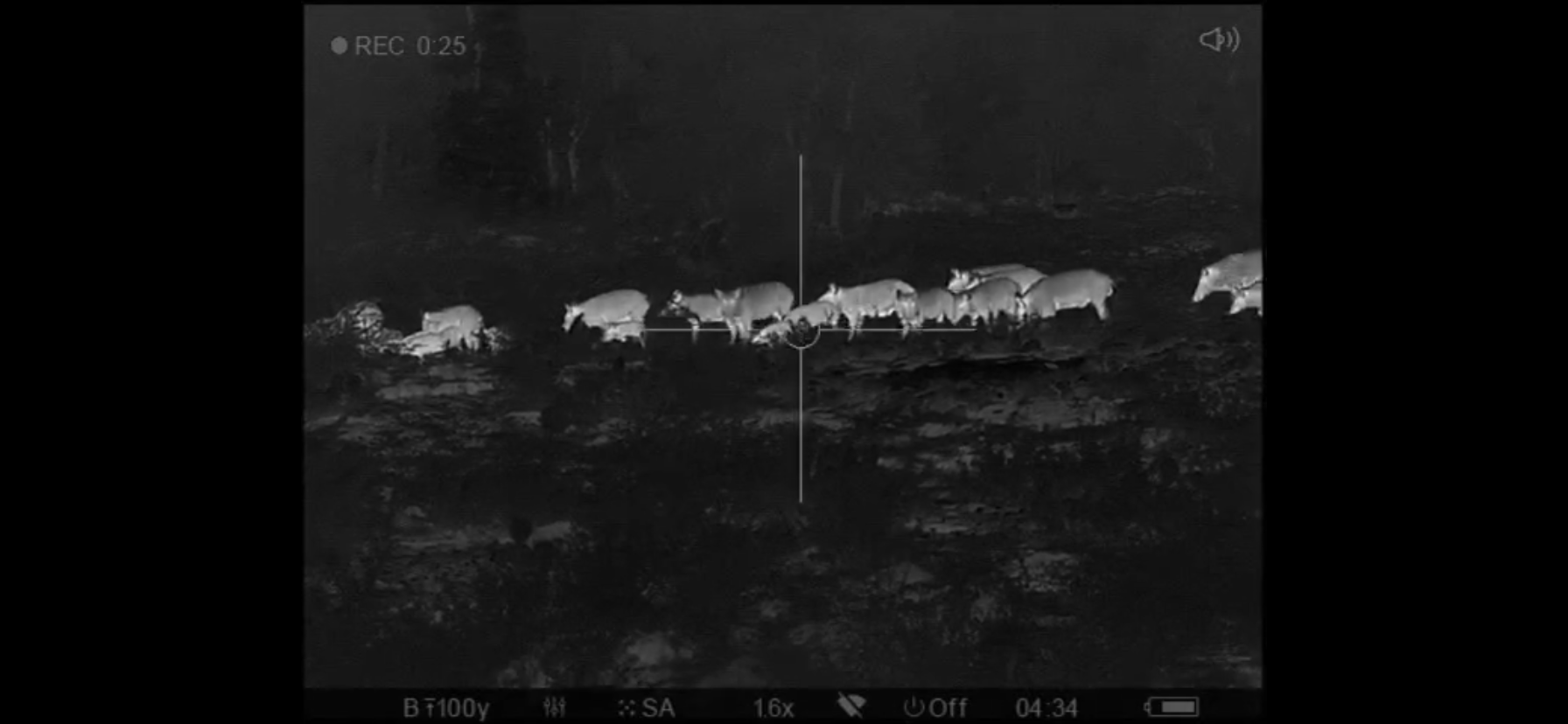

    Hog at about 90 yards through a Trail XQ50 at base magnification (2.7X).
    I can download some at farther distances if anyone is interested. I’m pretty sure I have hogs out to 4-500 yards through both of my Trails. If I don’t have it I can get it.

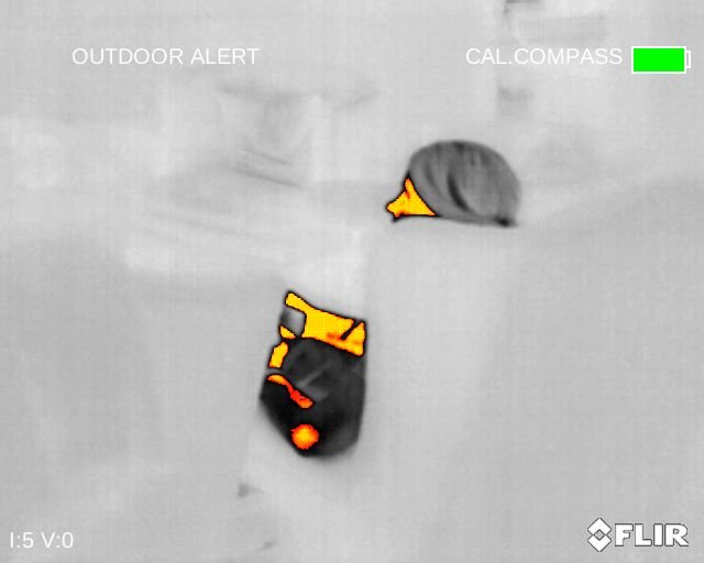

    My wife, maybe 3 yards. Internal temp was about 70 degrees, low humidity.

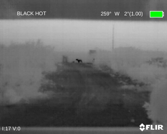

    Same Flir Breach, deer is about 100 yards, low humidity, ambient is probably 40-50 degrees.
