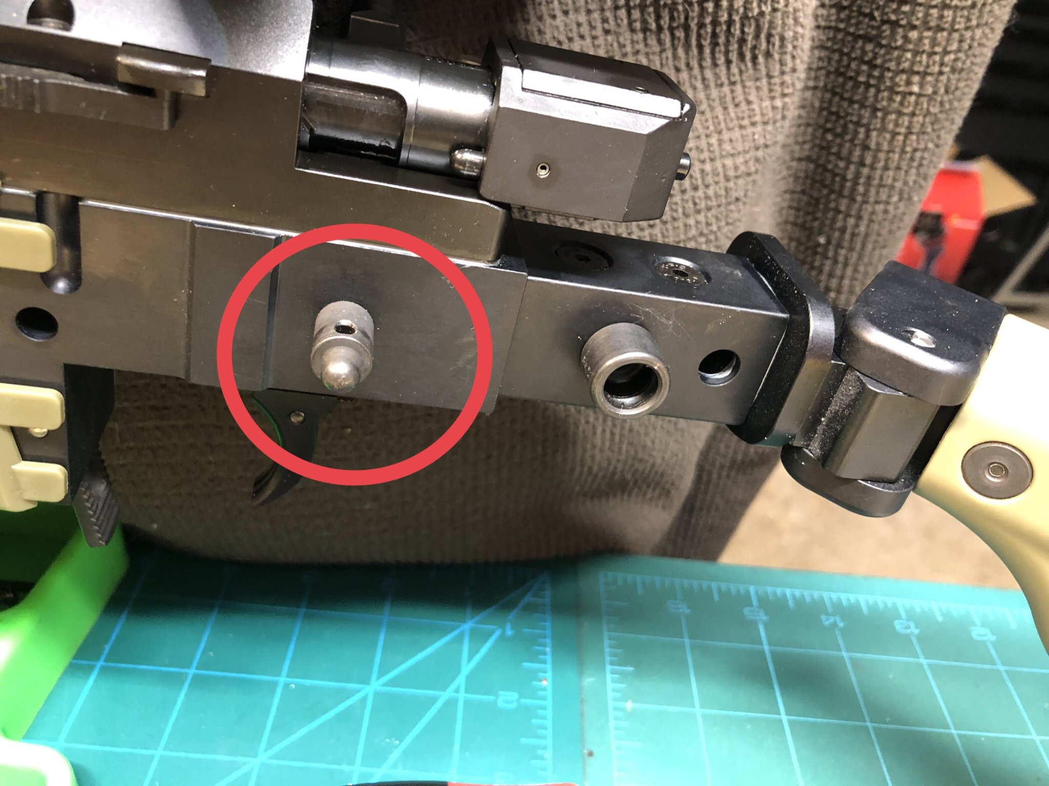

Question for you @samb300. I’m guessing the left hand AT thumb rest won’t work on a right hand action unless I can get get this “locking point” off of the chassis? I got the AX versions attached no problem and then noticed this was in the way when I started working on the AT thumb rest installation.
Can this piece be removed or is it bonded to the chassis? It didn’t seem to budge when I tried sliding a hex key through the center hole and tried unscrewing it. I didn’t want to “gorilla” it so I stopped after it didn’t budge with moderate force.
Question for you @samb300. I’m guessing the left hand AT thumb rest won’t work on a right hand action unless I can get get this “locking point” off of the chassis? I got the AX versions attached no problem and then noticed this issue when I started working on the AT thumb rest and realized that there was an issue.
You need to remove the trigger pack to access that male locking stud. You can use a LH thumb rest on the RH AT, you’ll just lose the ability to lock the folding stock closed.
Understood and thanks! I’ll have to look up how to remove the trigger pack since I’ve never done that before.
ETA: I just realized that removing the trigger pack looks a lot easier than a Rem700 trigger swap
It’s two SS cap screws with a 4mm Allen wrench, when you put it back in they’re 35 in-lbs
Thanks - I just saw your YouTube video on the AO chassis and watched the part where you pulled the trigger before debonding the action. It’s way more simple than I had anticipated. Thanks for your help!
ETA: got the thumb rest installed with no issues in about 5 mins after getting the trigger pack and that locking piece out
