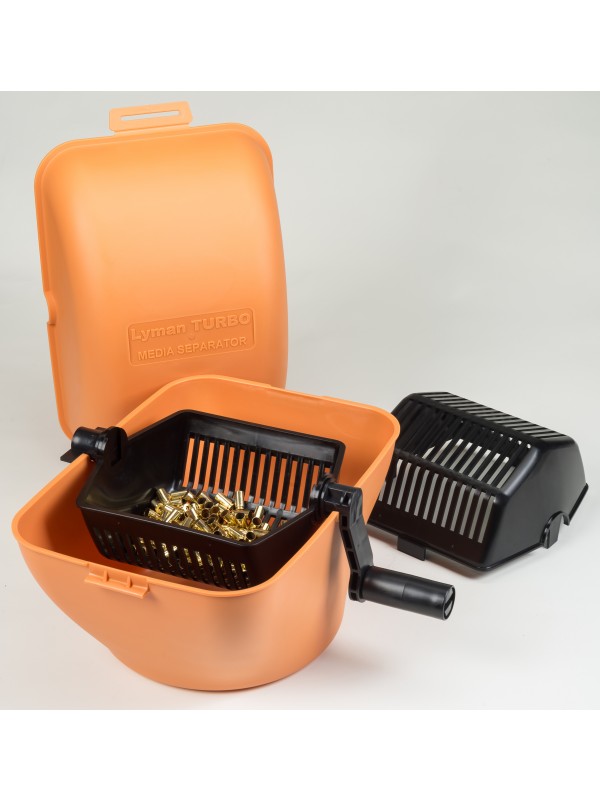

you'll need one of these also to separate the pins. i use the lyman one but you can pick whichever.
forgot to mention the separator :). Good call!

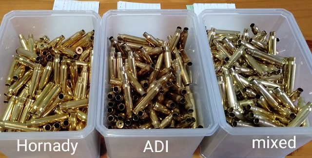

these are the sorts of results you should expect. mixed bucket has Federal and Winchester brass. i also use a towel to dry them somewhat before putting them in the lyman dryer for an hour.
disclaimer: individual results may vary :ROFLMAO:

With the pins, I find I don't even need the magnet. I just use a Frnk. Arsn. sieve type separator over a 5 gallon bucket and hot water. Hot water seems to make the pins come away from the brass whereas cold water makes them stick to the brass. I believe temperature affects the surface tension and film strength of the water.

For the most part, I have eliminated the use of SS media and in doing so do not need the separator. The brass with an 1/8 tsp of Lemishine, and a 'shot' of both Dawn and Armor-all Carwash with wax using hot water will make the cases look like media tumbled yet the primer pockets will still be be a bit dirty. A pass in prep over a brush on the prep center fixes this. I setup my Thumler's and drying dehydrator to cycle for 2 hours, the lowest time setting u have in a outdoor lighter timer used for this purpose.
