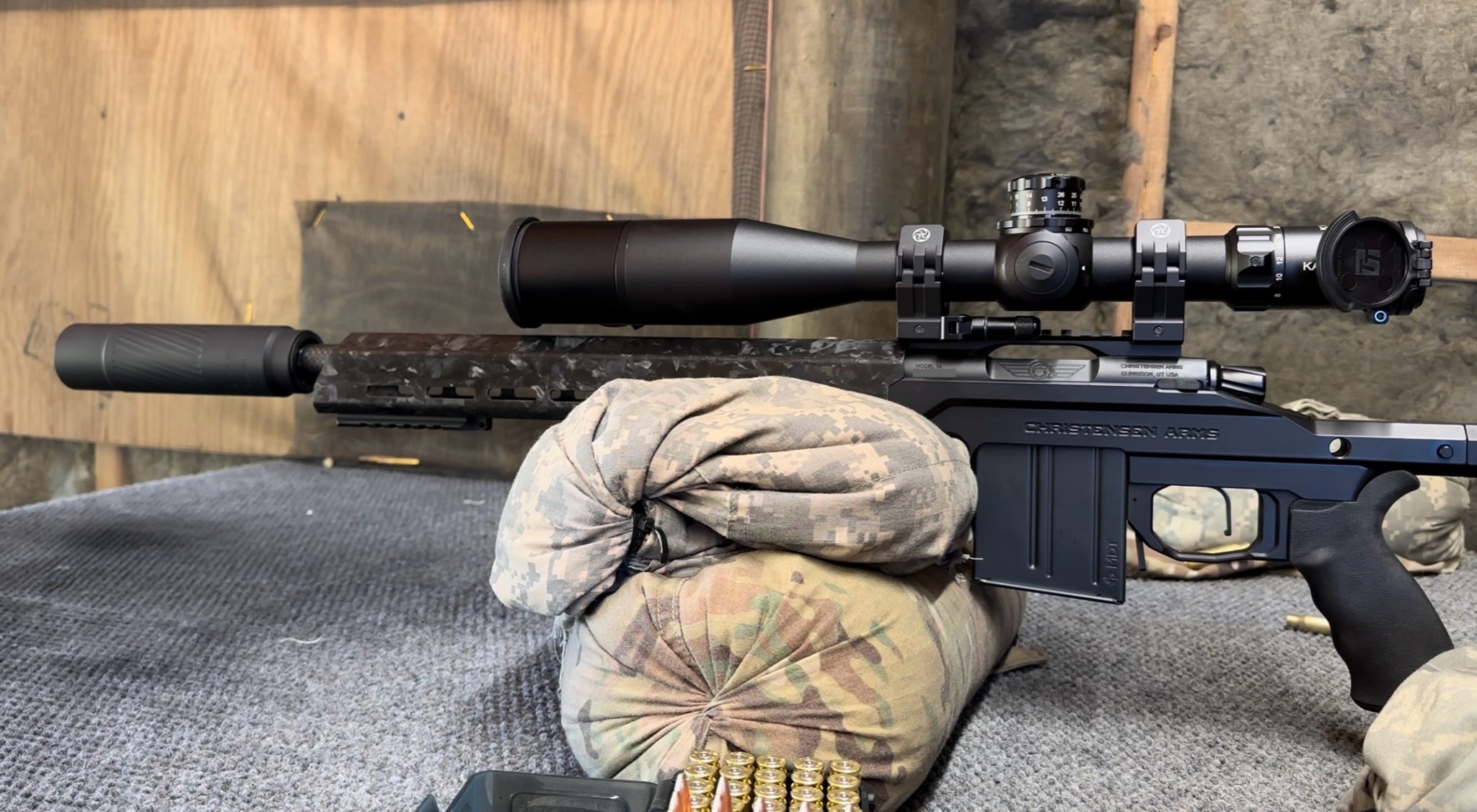

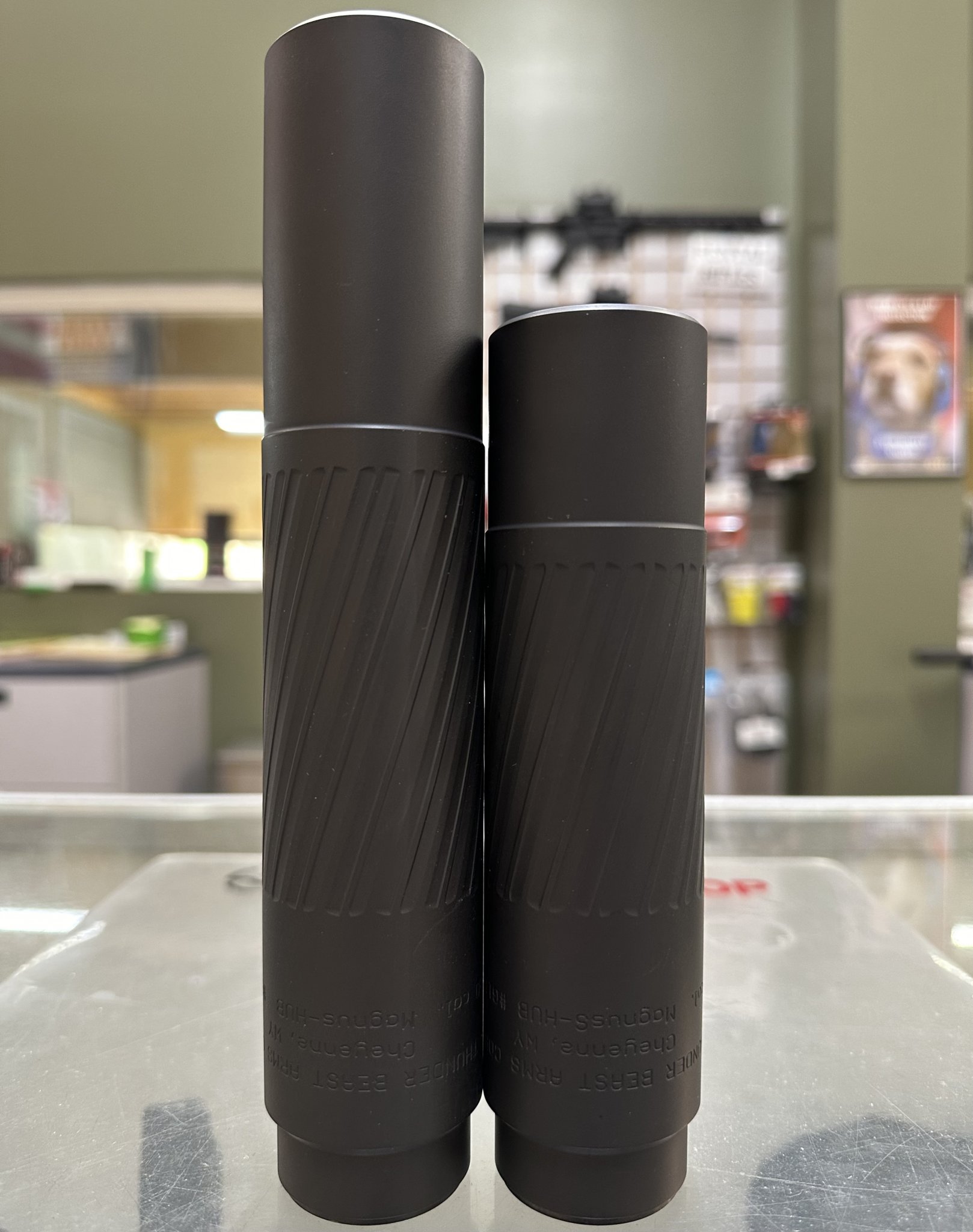

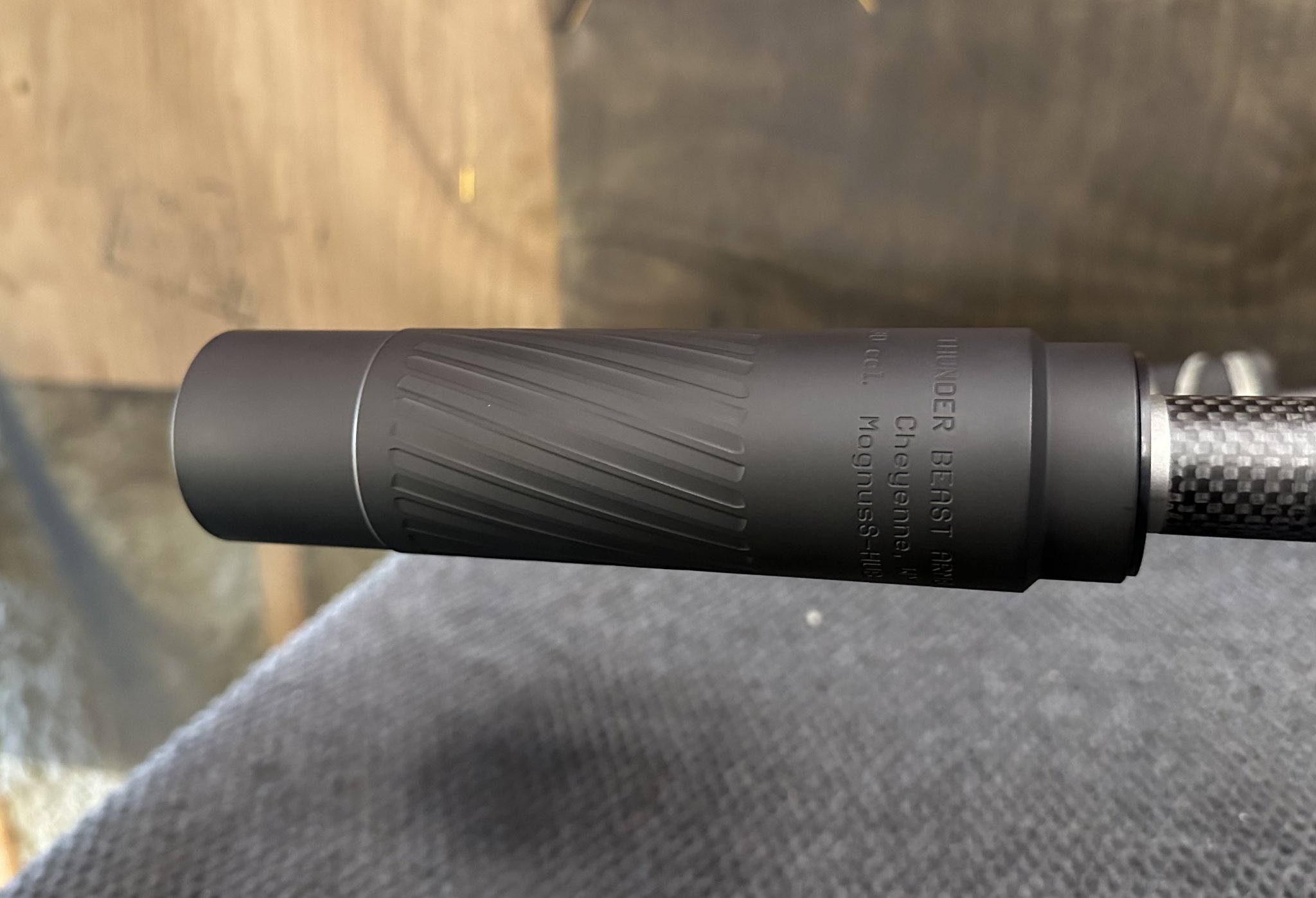

Magnus CB 7 Mag 155 solids at 3050 22” barrel
ML-135.8,134.9,134.7,135.5,137.3 Avg-135.6
MR-137.8,134.1,137.4,133.9,135.1 Avg-135.7
MR/ML Avg- 135.7
SE-126.6,128.3,125.8,127.7,125.9 Avg- 126.9
Dominus CB 7 Mag 155 Solids at 3050 22” barrel
ML-140.9,143.2,144.3,141.5,142.7 Avg-142.5
MR-141.3,144.3,144.9,143.0,143.6 Avg-143.4
MR/ML Avg-143.0
SE-131.6,133.5,133.9,131.5,131.6 Avg-132.4
Nice video. I'm a big 7mm guy. I have a custom 22.5" 7mm RemMag built off an A-Bolt II action. It's pushing Berger 168 VLD's at 2,931 MV with an ES of 3, and and an SD of 1. When I get a Magnus, that's one thing it will be ran on.
