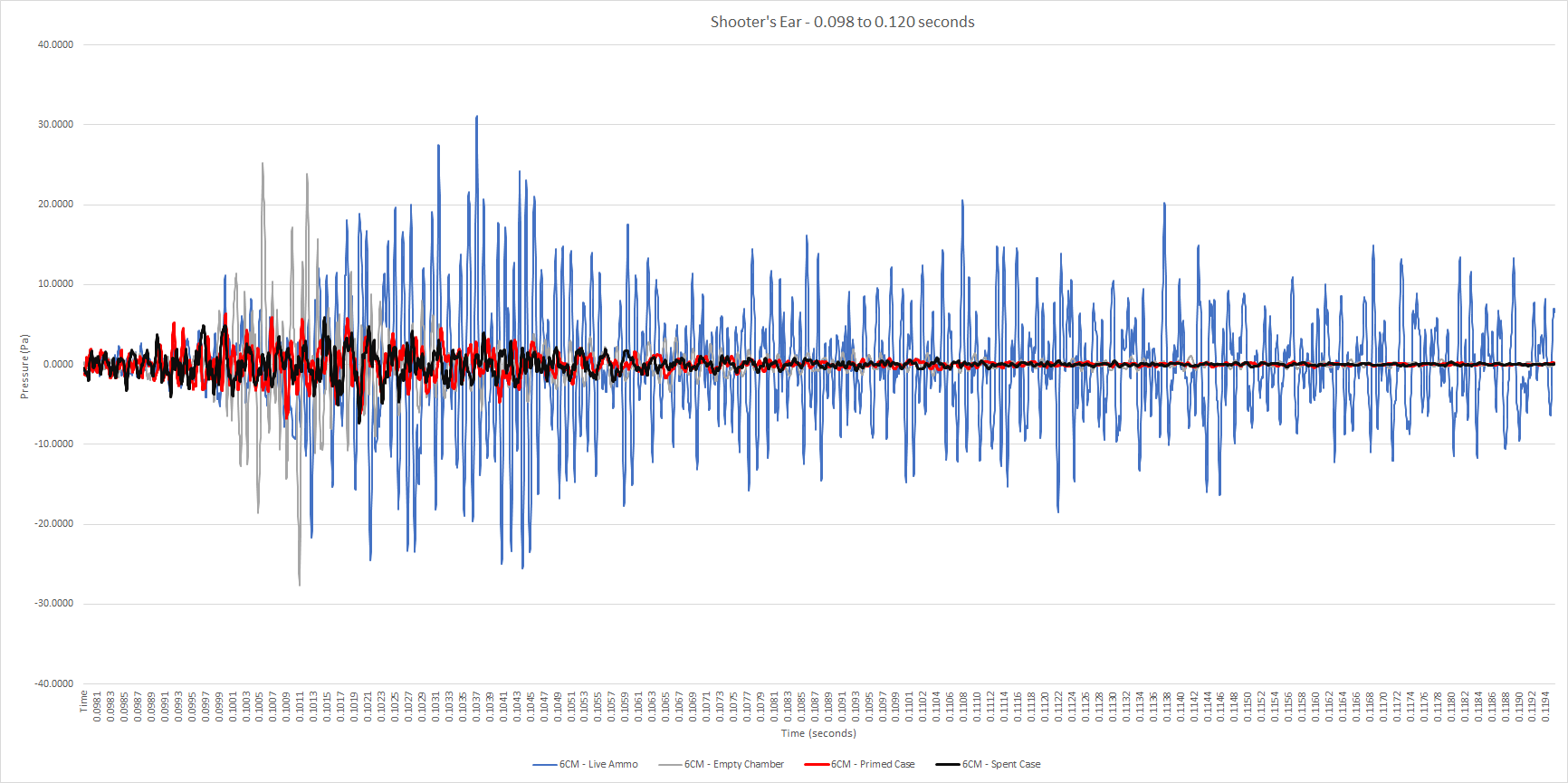

We also collected shooter's ear waveforms for a primed (cci BR2) case and a spent case. Here the Shooter's ear waveform in Pascals for all 4 shots.
Peak values are:
Live ammo (blue): 123.8 dB
Empty chamber (gray): 122.8 dB
Primed case (red): 110.5 dB
Spent case (black): 111.3 dB
The empty chamber is louder because a resonance is occuring from the firing pen bottoming out in the bolt. When the firing pin strikes a primer that impact deadens the resonance of the firing pin assembly. That resonance occurs immediately after the firing pin bottoms out.

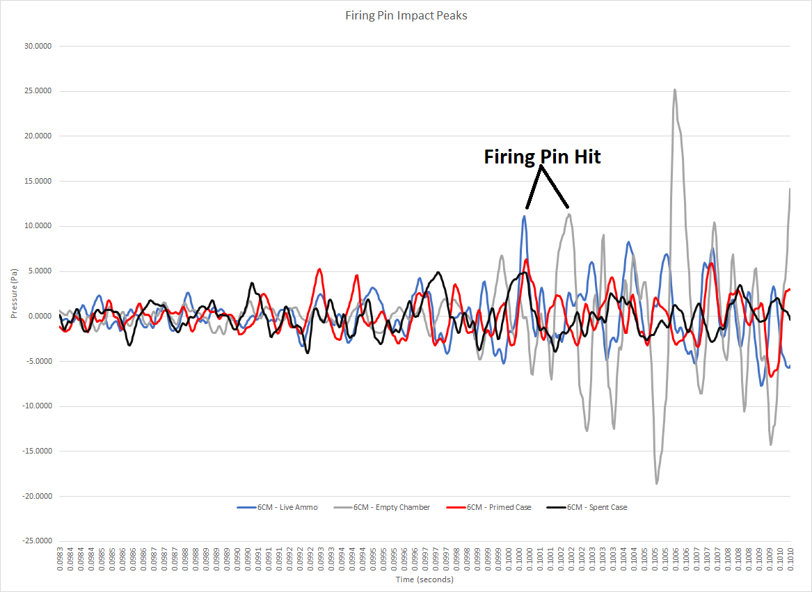

If we zoom in a litte further we can see peak values for the impact/ignition. The firing pin impacts are noted on the plot. Live ammo, spent case and primed case all hit at roughly the same time. The empty chamber firing pin bottoms out in the bolt later because it is traveling slightly further to bottom out withough a cartridge there (about .25 milliseconds later). The plot also shows how the resonance for the empty chamber waveform begins immediately after the firing pin bottoms out.
The values for the impact/ignition on the cases are:
Live ammo (primer and powder ignition): 114.9 dB
Primed case (primer iginition): 110.5 dB
Spent case (Firing pin hitting a dead primer): 107.8 dB

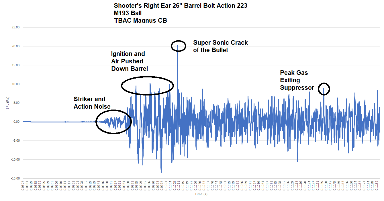

@Lawnboi,
Spun my 223 barrel on and got numbers shooting the Magnus today. Ammo was M193 55gr. Barrel length is 26" which puts the MV at 3350-3400.
With supersonic crack
Mil Spec: 133.2 dB
Ear: 121.6 dB
Ignoring the supersonic crack
Mil Spec: 124.1 dB
Ear: 114.5 dB
Will post a waveform shortly that shows the action noise and supressor report at ear (ignoring the supersonic crack) are roughly the same with the action being slightly higher.
