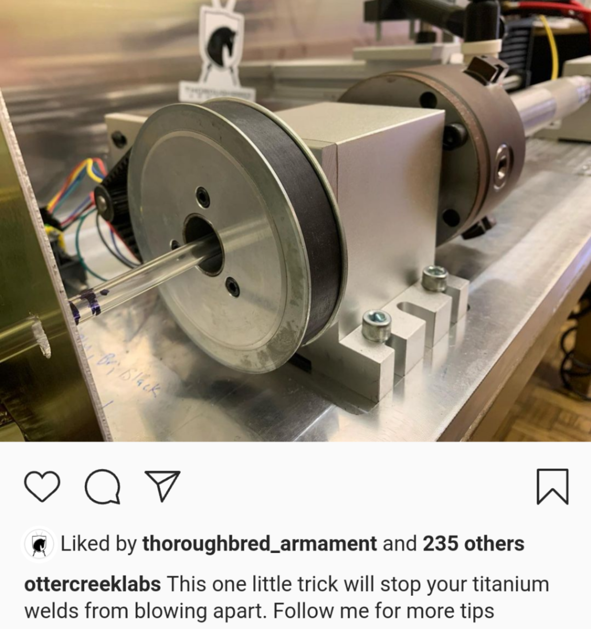

This is still the greatest suppressor meme of all time and I will stand by it
