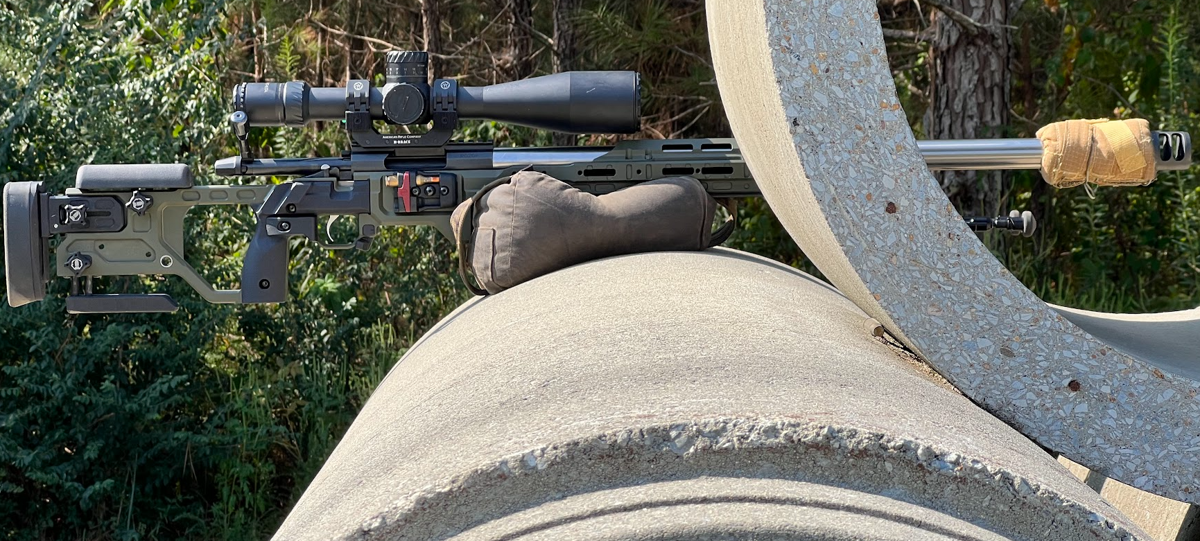

I have an ultra 9 6.5mm CB I use for long range on my MPA 6.5CM switchlug for prone and bench range fun. That is with a 26" MTU profile and I don't have to carry it or get into weird firing positions. Absolutly love it!
I also have used that rifle for PRS, but swap to a 24" Sendaro profile with the MPA break, fresh zero, reset turret stop and leave it for the duration of competitions.
