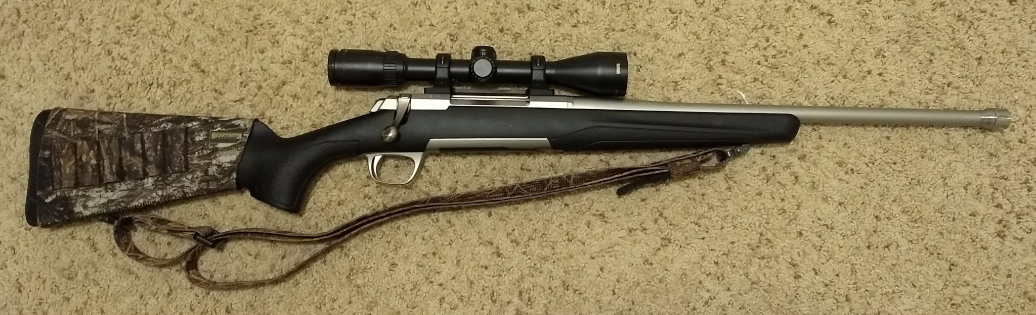

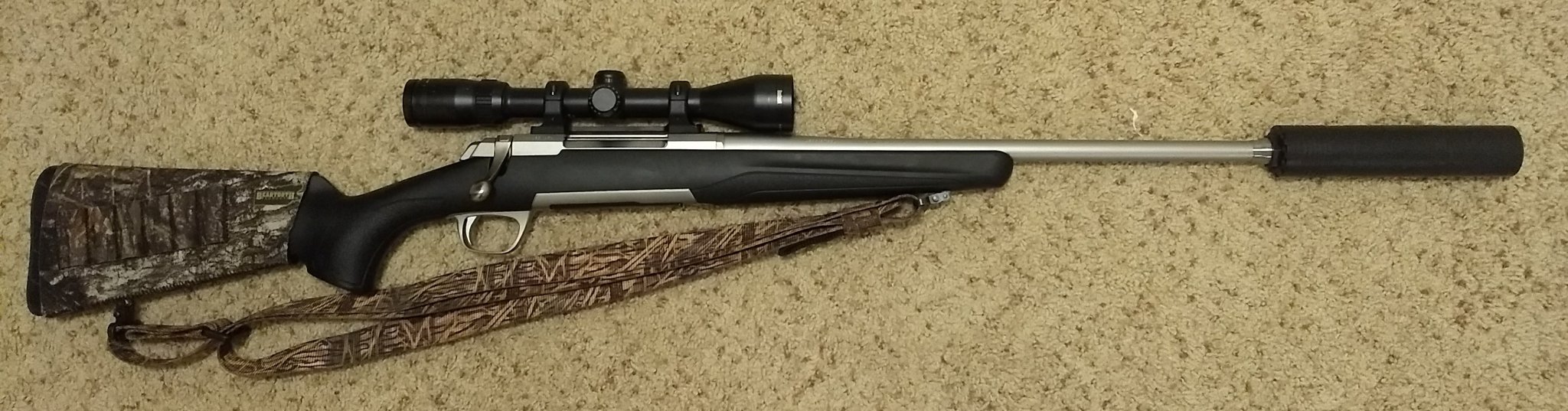

Here are some pics that may help with visualization of your project.
That's a Liberty Sovereign, so a hair less than 7 inches added on when it's mounted.
As for the suppression level, keep in mind that the muzzle numbers aren't really the most important for a recreational shooter/hunter, the at ear numbers probably are.
I had an opportunity to do an impromptu metering of my setup on a B&K 2209 at the range one day (thanks to a certain generous local suppressor manufacturer). My statistically shaky sample of a few shots each showed ~142 dB a meter away from the muzzle, but ~135 dB at my ear.
A bit over the "hearing safe" threshold at the muzzle, but good enough for me at the ear. I'd guess with the higher volume of higher pressure (at the muzzle) gas in your 7mm Mag and the larger differential between suppressor bore and bullet diameter, your setup would be louder. The at the ear numbers might still be good enough with a 7 in can to opt for the shorter length... or maybe not, just something to consider.
