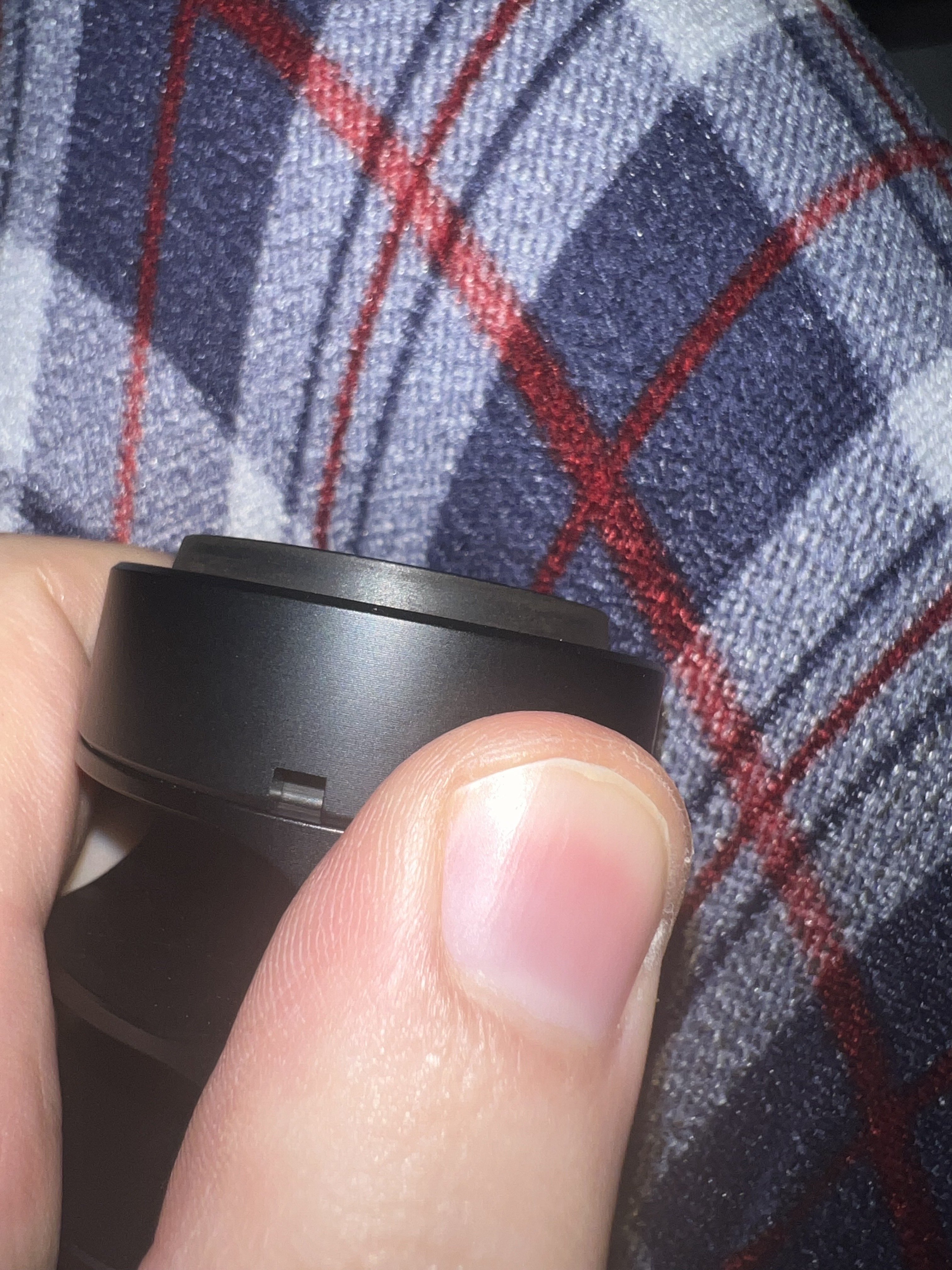

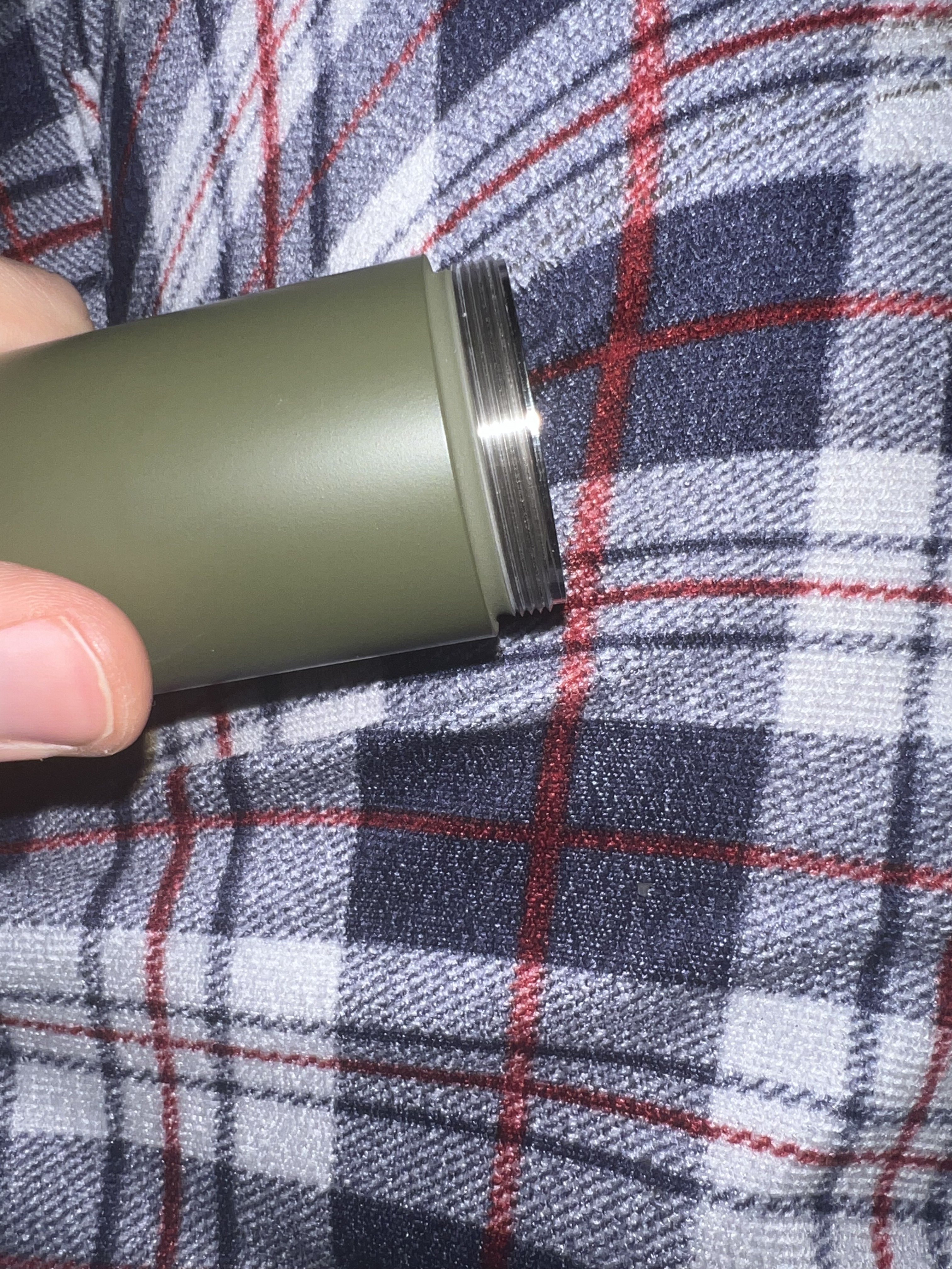

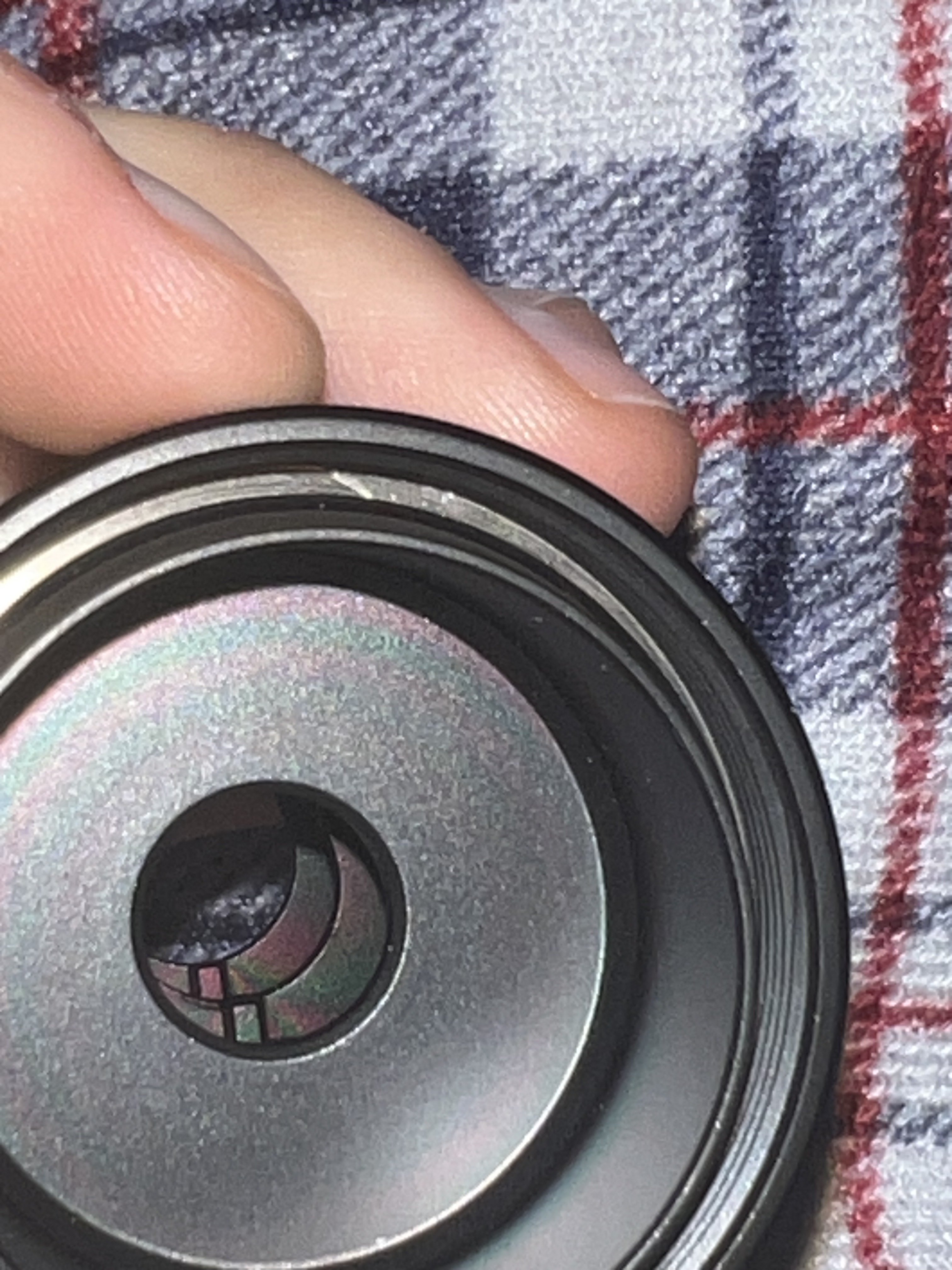

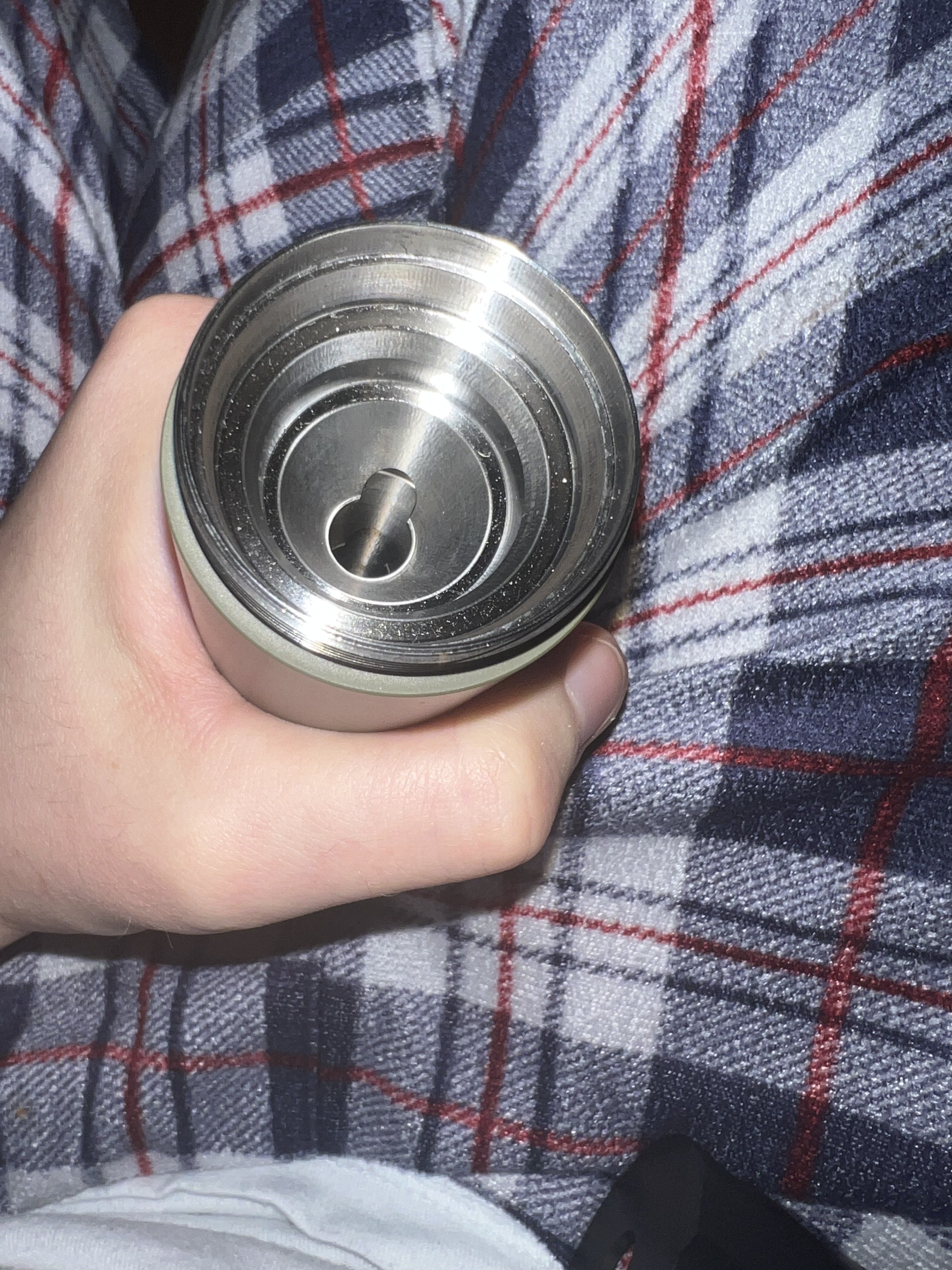

Theres a taper inside the end part of the can, with external threads.
For the brake section, it’s a solid piece with this tapered male end that goes inside the suppressor to lock it. Then a loose collar that’s inside the brake section threads over the outside of the suppressor. You would have to replicate this male and female taper section.

Checking with some local forums to see if anyone close to me has one.

Since we can access that tapered shoulder to clean it. What about just an endcap that screws onto the threads of the can? Would make machining pretty easy. if for some reason you wanted to protect the tapered shoulder. And separate insert could be slid in. Then put the end cap on to lock it all in place. Personally id be fine with just a end cap and would clean the shoulder when i needed to put the RR back on.

Well, I don’t feel comfortable with just threads, it should interact with the taper but also it’s a nice feature to be able to leave the cap on but take off and install the brake as you please while maintaining the cap. Another thing, removable caps is also a good features especially the DA caps. It’s gonna cost a significant amount anyway you might as well go out.
I imagine this would be something you could torque on or perhaps use a light layer of rockset to leave on and forget.
If we get 15 guys in on this, reverse engineering the taper per person will be minimal in terms of cost too. Anyone that is interested in something like this, please reach out to other guys to get them in on a group buy. The more the better.
