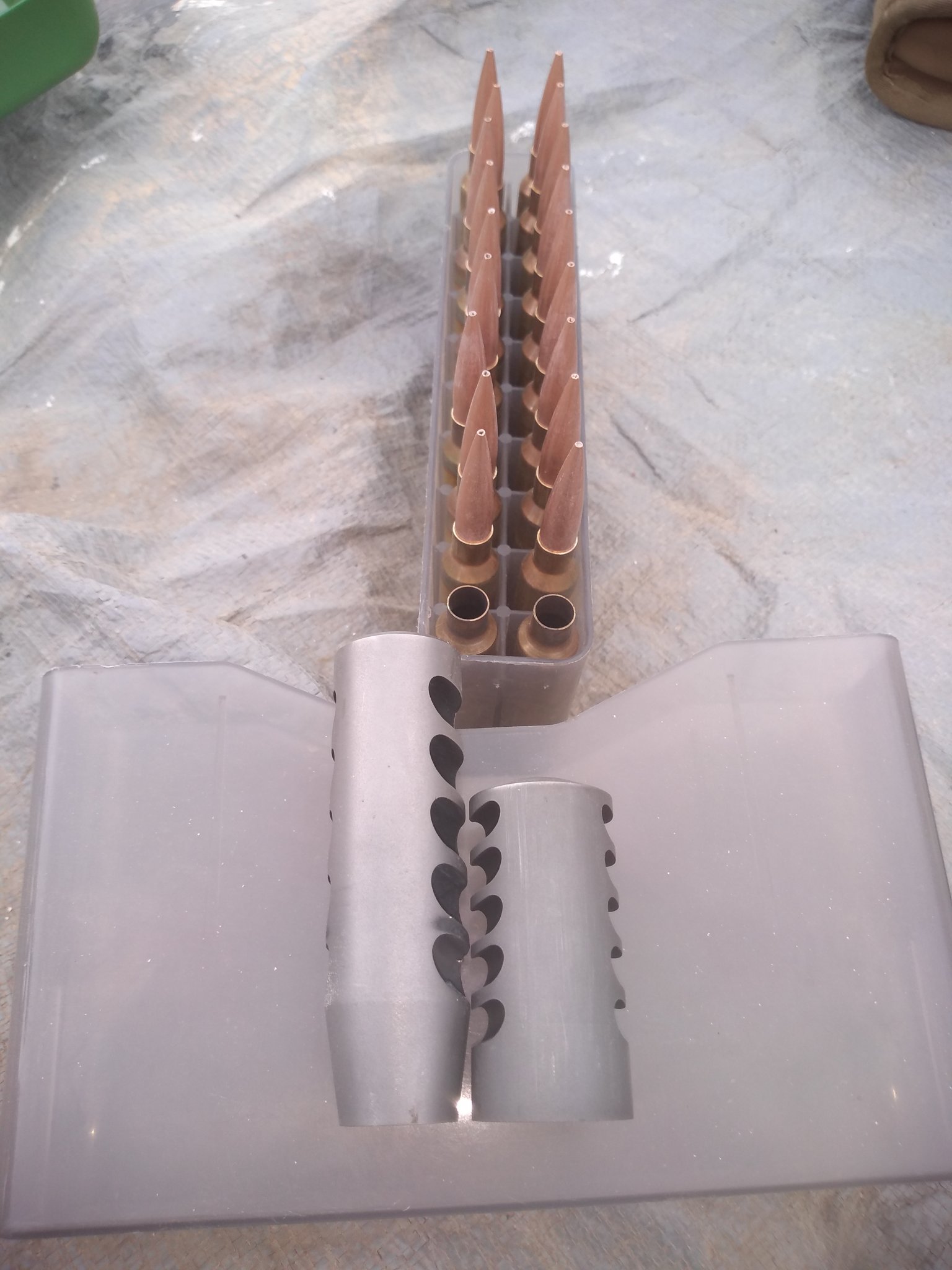

I just had the opportunity to try out a new Brake from Salmon River Solutions, its the Titanium 5 port Pro model.
It's .99" diameter and mates up really well to a 1" CF barrel.
I screwed it onto my new 30 Sherman mag ( basically a 300 PRC Improved) that only weighs 9.25 lbs scoped.
I'm shooting 215 Bergers for fire forming with Max PRC loads
It's only 2" long and weighs 2 oz but it's extremely efficient.
I compared it to my 5 port Beast brake that's 3" long,and the Ti Pro reduced the recoil slightly more than the already excellent Beast .
More importantly it doesn't direct the concussion back in the shooters face like the Beast.
My wife put a few rounds through it tonight and was hitting steel at 680 yards.
The rifle didn't even move when she shot it!
I'm really impressed with this brake, I've used a bunch including a Terminator T3 and the Ti Pro is just as efficient without the length, extra weight, and rearward concussion.
Plus Ken's a good guy and local to North Idaho

Comparison with the Ti pro (right) and the Beast brake
