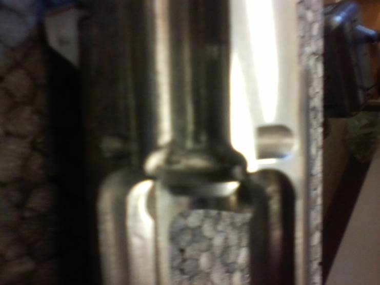

Since there are likely some welders in this discussion, can anyone tell me how difficult this welding job would be.
The picture isn't real crisp but the magazine cutout and the trigger cutout intersect on both sides. I would like to have the gap welded up but I prefer to find someone with the right welder and the skill to do it so it wouldn't require any machining to clean it up. The slot is about .060" wide and about .125" tall.
Any DC stick welder could be used as a rig machine. .. in the right hands. I have used my Lincoln vantage 300 to do a few handles as well as a synchro wave 250. Both easily handle the job.
