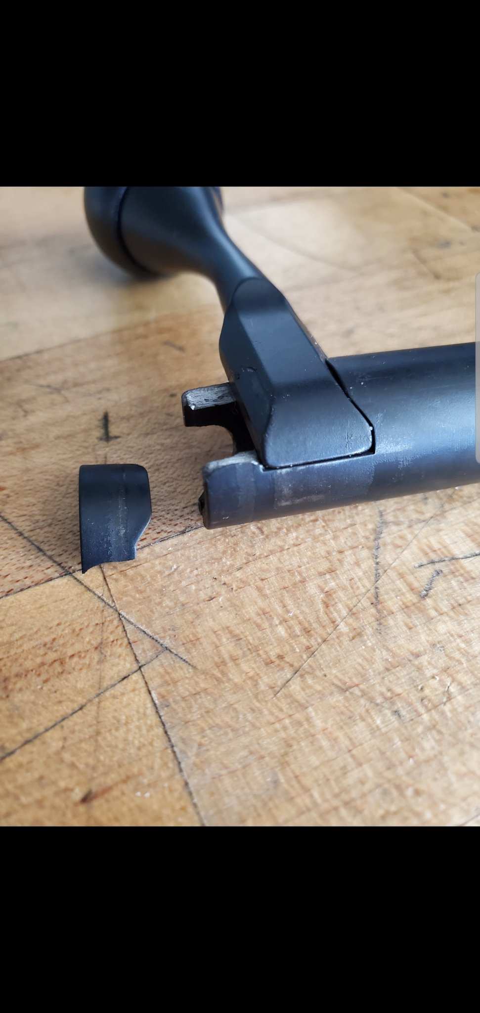

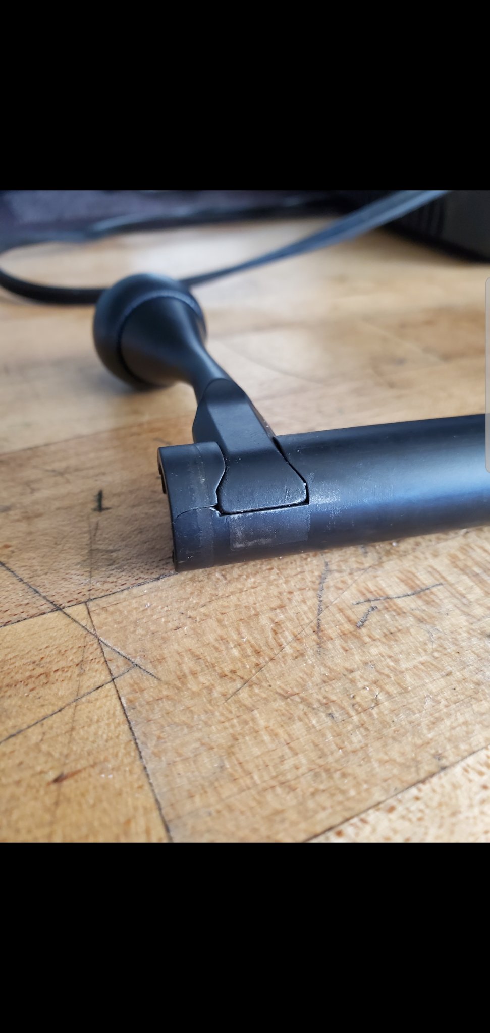

    I did an oooooops with my rifle and broke it. Factory Tikka T3x Tac A1 teflon coated stainless steel bolt.
    Anyone able to TIG this sucker back together?
    That looks like a canadate for micro TIG welding which means probably expensive and best/safest to get another bolt.
    Here's a micro TIG welding company: https://www.blackdiamondprecision.com/
    Josh is on Instagram @aceofmicrowelding I think he's also does a little shooting. Might contact him via the website or Instagram.
    Bummer what happened.
    Reactions: clcustom1911
    Here is my opinion on it.
    I'd clean it all up, use at least 1/16th tungsten or smaller and weld it up. I'm not sure how much I'd bevel it. Probably none because it's not that thick, if you have too much push through your going to have to clean that up. You definitely could weld the handle to the bolt also. It would make it much stronger.
    It's really not that big of a deal if someone is proficient with a tig. A mill would def make clean up easier. Baldwin Gun Works could fix this I'm sure. I really dont have time to mess with it, but if you cant get anyone else send me a PM I'll hook you up
    Gonna be kinda tough to service the bolt with the handle welded in! I'd get a new bolt installed. Might even try to get Tikka to do it under warranty. It looks like the bolt is cast. Maybe there was a nasty spot in the casting. I wonder what the OP did to the rifle to cause that.
