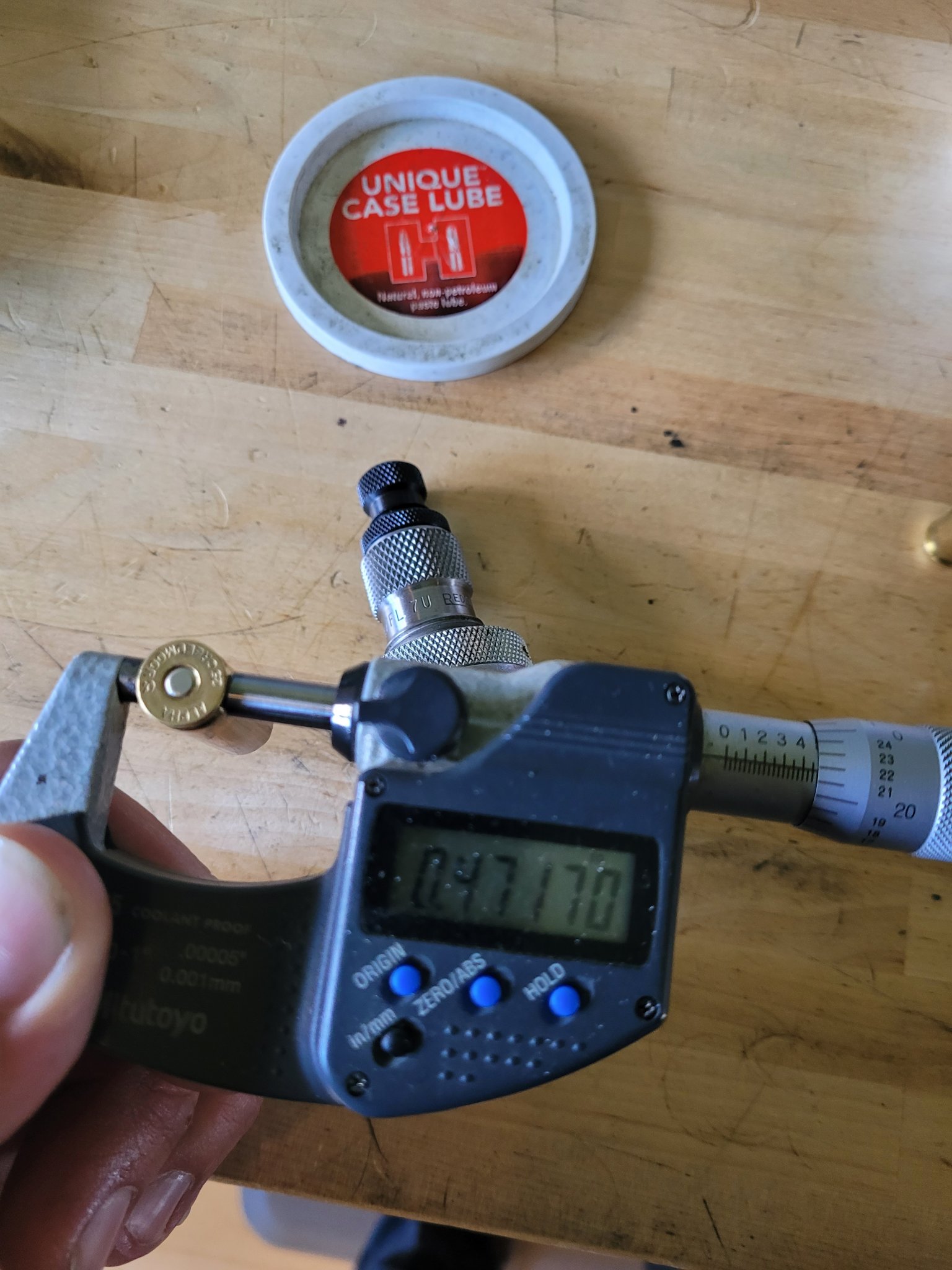

So here's a case measured after sizing through the Redding type S fl die.

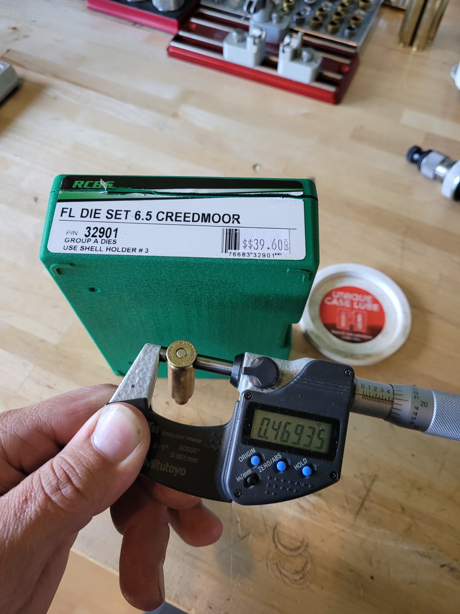

And here's a case sized with the rcbs dies I just picked up this morning.
The base of the RCBS measures 0.459 inside. Way better sizing than the Redding.

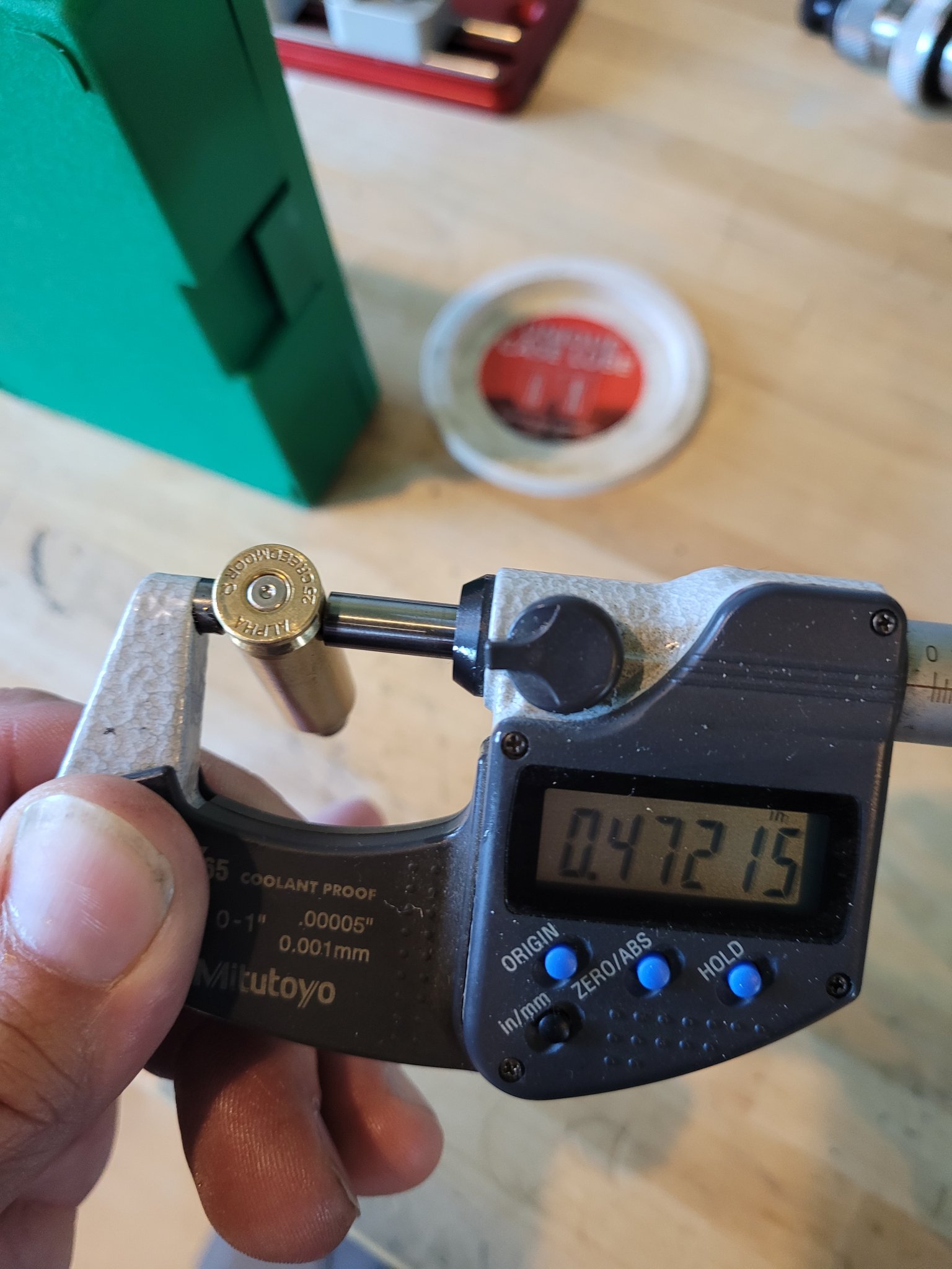

Here is a fired case for reference.
SAAMI spec for 6.5 Creedmoor is .4698" on the brass at the web and .4708" on the chamber. I doubt your RCBS is .010" under SAAMI but your fired brass does sound blown out at the web. I don't think I'd want to keep sizing the web back .003" from fired, perhaps consider a body die instead. I would normally suggest contacting Redding but their CS is pretty underwhelming.

No it isn’t. If it were you would destroy the cases you’re sizing.
You're so right man! I just shot 12 of the new sized cases and they extracted perfectly, guess what, sized em again and they're not destroyed! You'll break a die before you break a case web. I have very tight custom small base dies in 300wsm 300 norma improved, 300prc, 6.5 prc and they all size without damaging cases. I load for 15 different chambers from 223 to 338rum, everything big and small between. You're experience may vary, but this is my findings, I'm not going to respond to any more of your posts because obviously the only things possible in your mind are what you've done or observed yourself.
