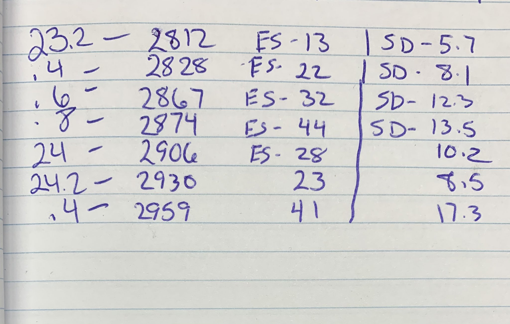

    What are you guys running? I’m using 77 smk and 8208. 23gr had a 1/4” group but the sd and ES were crap. Weird.
    have went up to 23.8, but groups have opened up with crap numbers.
    Seating them at a COAL of 2.361, which is about .02 off
    I run 22.9 with my 22 inch bolt gun..

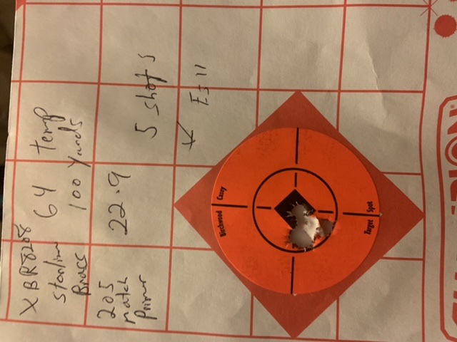

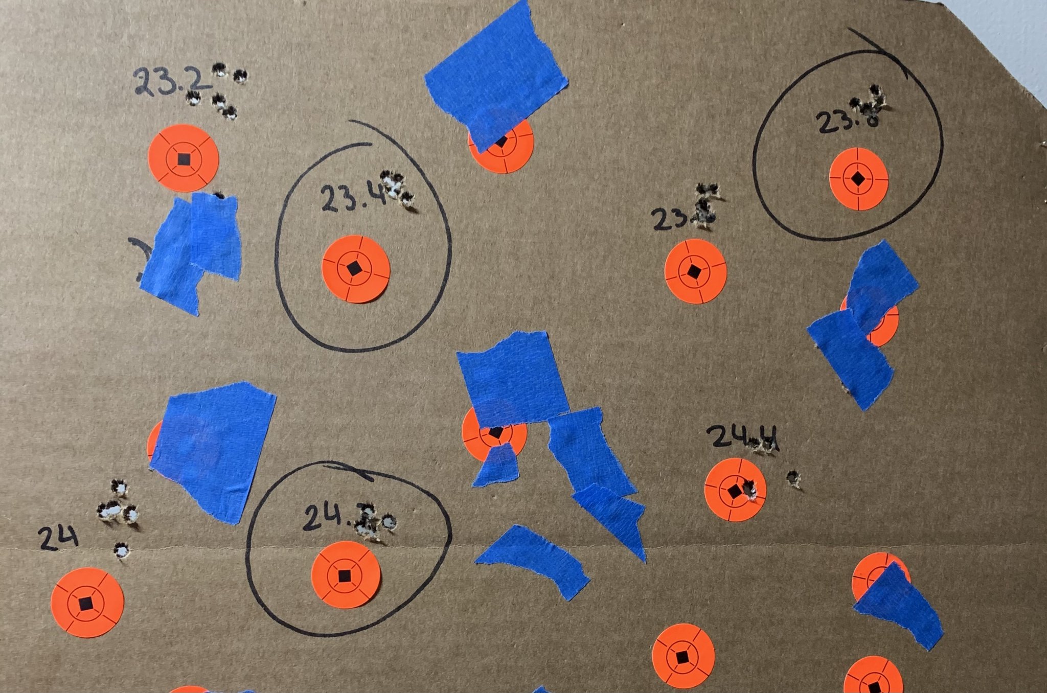

    Shot this morning, shooting .4-.7” groups loaded all the way up to 24.4gr of 8208, but damn SD 12-20 and ES of 36-71... depending on the load.
    Do I need to mess with seating depth or what?
    I think you found the sweet spot that we all have found. 23.5 of IMR 8208XBR. I know this will be difficult in 2020, but try some other primers to see where your SD / ES goes. Brass can make a difference also, but I'd try the primers first.
    Those CCI 450’s could be a source for your high ES & SD’s, the 223 Remington doesn’t require a magnum primer, nor is IMR 8208 XBR slow enough to require a magnum primer for a complete burn of the powder.
    I ran some federal match SRP on a bunch and didn’t really walk away with anything better.
    I had a load with the cci450, 23.4gr of 8208, only chronod 5 rounds but I had a 19ES and a 8.1SD, with a group measuring .298. I’m gojng to go back and revisit that. My intentions with this rifle were for a 500 yard max match... after a while, I’m going to get another batch of lapua brass and a box of 80gr smk to try. I have 900 of the 77 smk currently

    Overall a pretty good selection of components. Looking at your data and group photo 23.5gr would be my load choice going forward.
    Another seating depth to potentially explore might be slightly under typical AR mag length around 2.248in. Although your groups look quite good already.
    As for lowering the SD & ES how consistent are your charge weights and also the neck tension on your brass? I know my SD's & ES's tightened up nicely when I got my A&D balance and started using an expander mandrel after running my brass through the bushing die. YMMV.
    I’m using a rcbs chargemaster lite, and my expander mandrel should be here tomorrow so I’m going to load up some more and try. Hoping for a little better numbers with more consistent neck tension

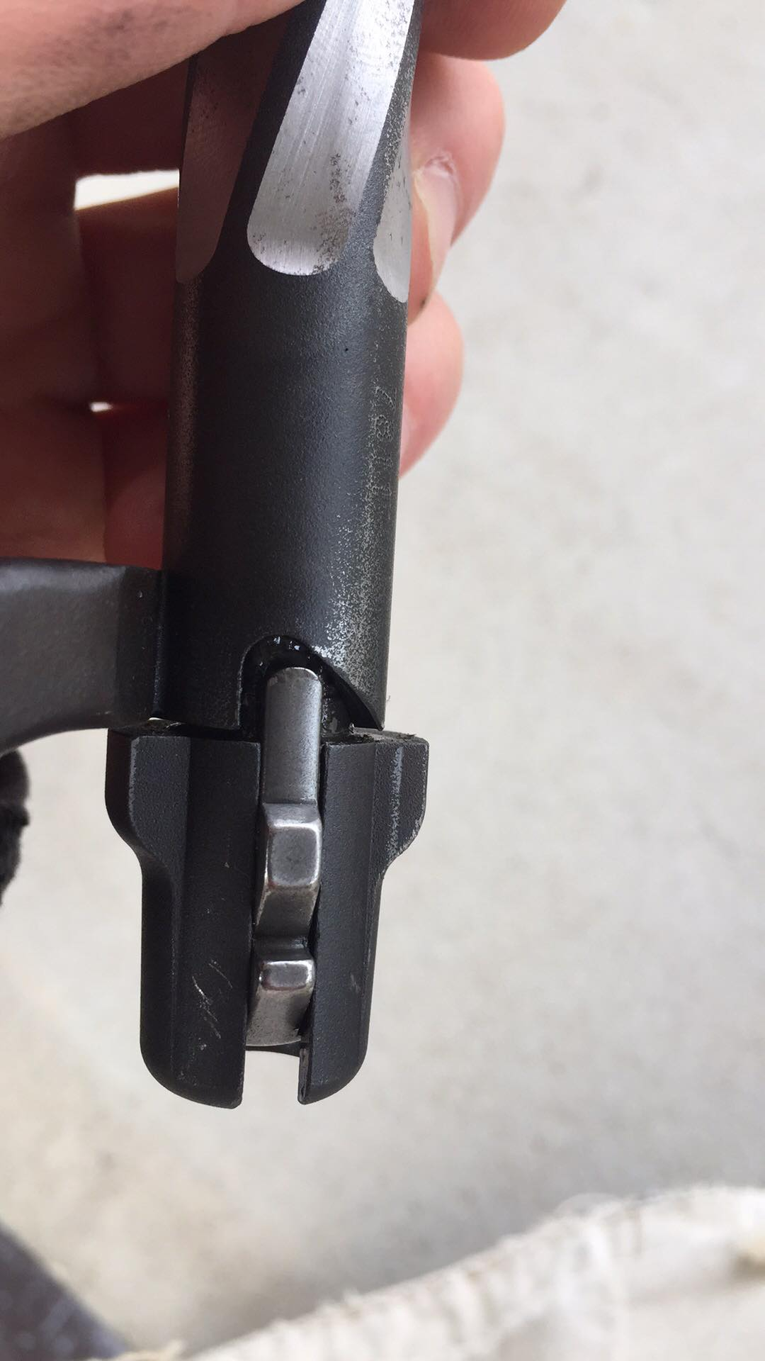

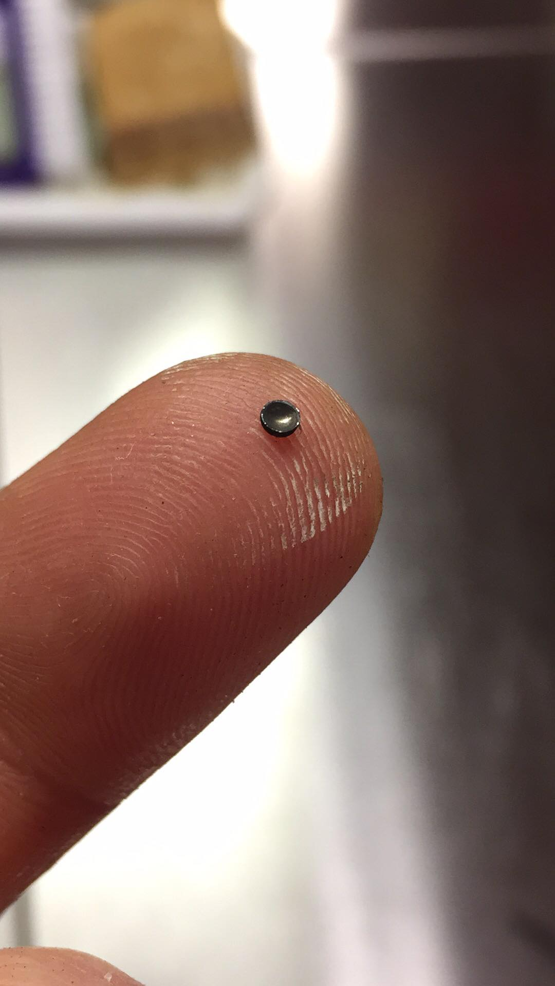

    You are right... but if you start to try to push a standard 400 primer to performance pressures you are much more prone to get primer punctures.
    And mine havent gotten any worse since going to a primer that doesnt leave little discs of primer in my firing pin channel. If your spent primers show you any cratering then dont go to 400s.
    Reactions: Steel head
    I should have noted that with the federal match primers, I was showing signs of pressure issues with them on the same load that the 450 was fine with

    If you push a standard 400 primer to performance pressures, and the primer gets punctured, maybe the primer isn’t the problem . That would lead me to believe that the pressure’s way to high .

    Your load of 77SMK over 23.0gr 8208 is a known accuracy load so that should not be a problem.
