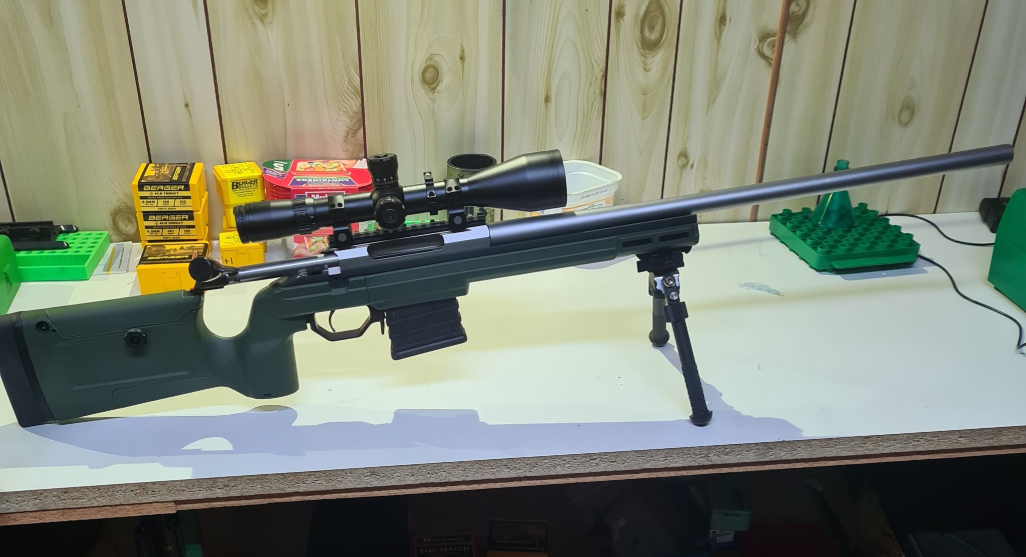

    Hello everyone
    I just got myself a KRG Bravo stock for my Tikka T3x Stainless Varmint 223.
    Have got a MDT Polymer 223 magazine and it feeds nicely.
    Now im just wondering if its worth rechambering this factory 1-8" Tikka barrel to 223 AI? Or would I be better served going to a 26" and 1-7"?
    I want to shoot the 75 ELD M's around 3000-3100 if possible and use it as a longer range varmint rifle to 500yds or so.

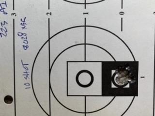

    I have a similar setup, Tikka T3x 223 in a Bravo. I went with a PVA 223AI barrel, 24” shouldered prefit. It is faster than than the factory barrel, more accurate (especially as it heats up), and has a threaded muzzle. I recommend it, Maybe even on sale this weekend. 80gr SMK, Lapua brass, 24.8 8208XBR, CCI450, 2.455” OAL.

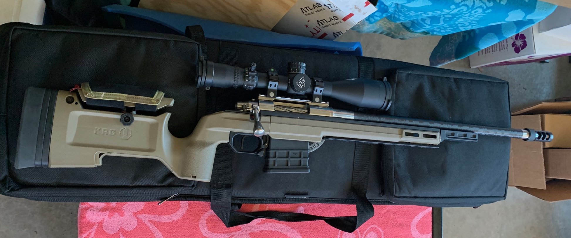

    Right now I’m getting a T3x made up in 223AI with a 26” 8 twist barrel throated specifically for the 75g eld-m’s loaded for the longer MDT mag length and am hoping I will have enough horsepower to hit a node at or north of 3,000.
