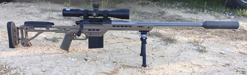

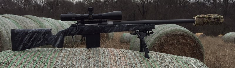

photo75544.jpgphoto75545.jpg I have a Tikka T3 and a Stiller TAC both in 6.5 Grendel. The actions had 223 bolt faces that were opened up.
Both run and shoot fantastic!
