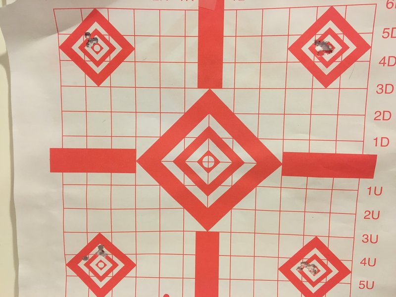

    Mine loves the 55gr Vmax with varget for the PDogs. 75gr ELD and varget for the 1000 yard Steel targets.
    here is a target a few months ago where I was testing seating depths with the 55Vmax after noticing some throat errosion from 4000 rounds down the tube. All five shot groups.

    Thats some great shooting!! How are the 75's performing group wise?
    Running 25gr of CFE223 and 75gr ELDM (seated a .01 off the lands). Looks promising, but there's still some room to move up in charge weight; still a work in progress...
