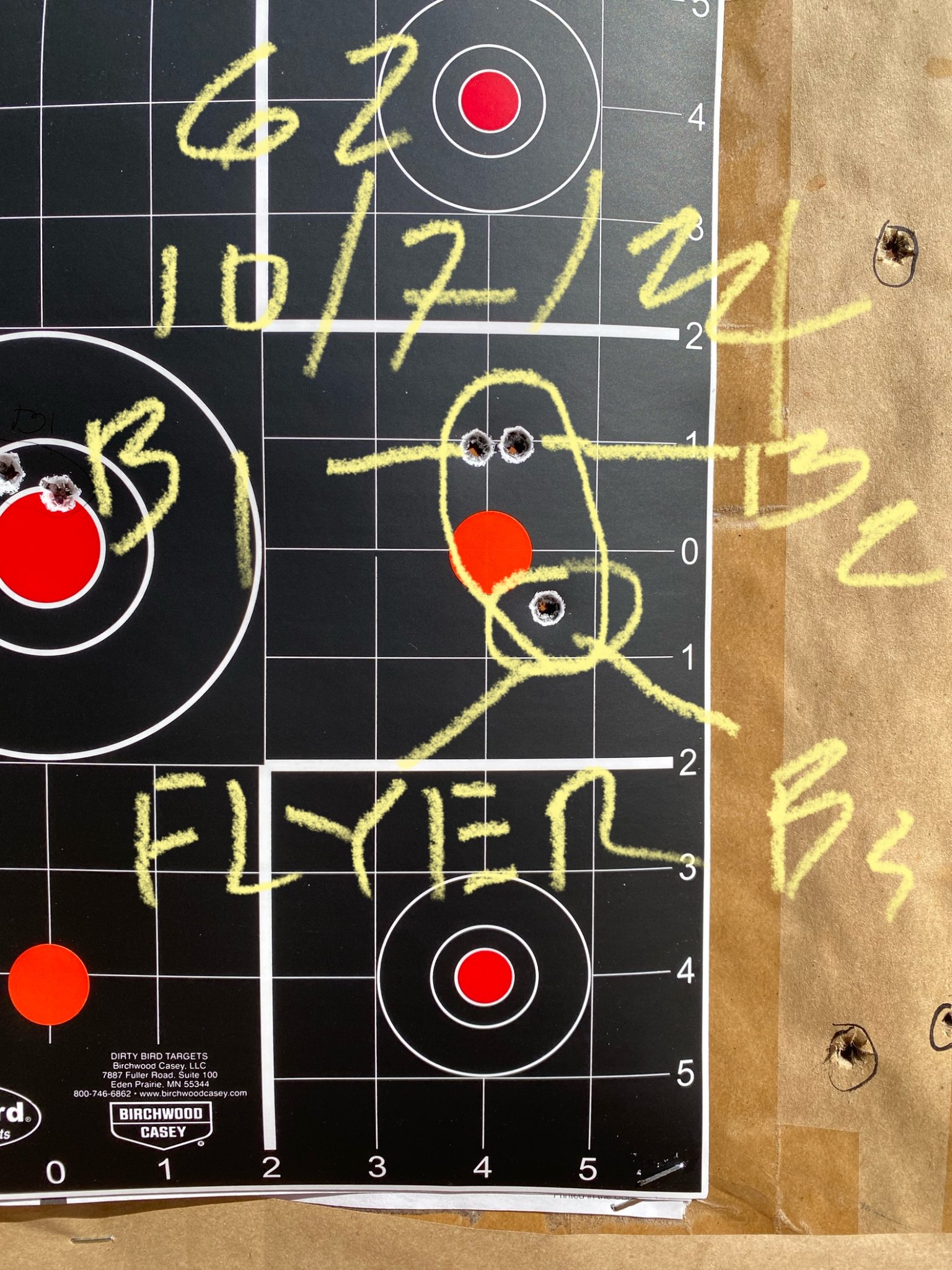

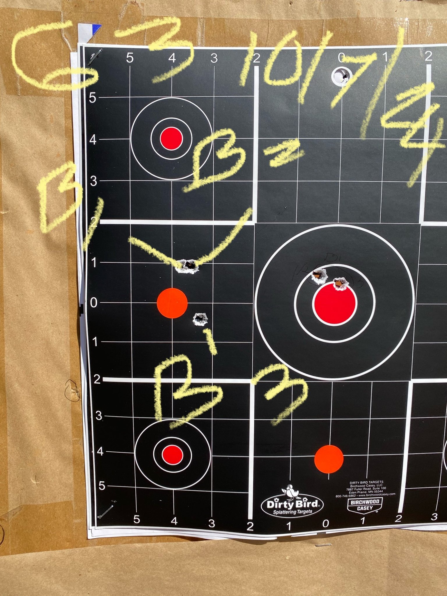

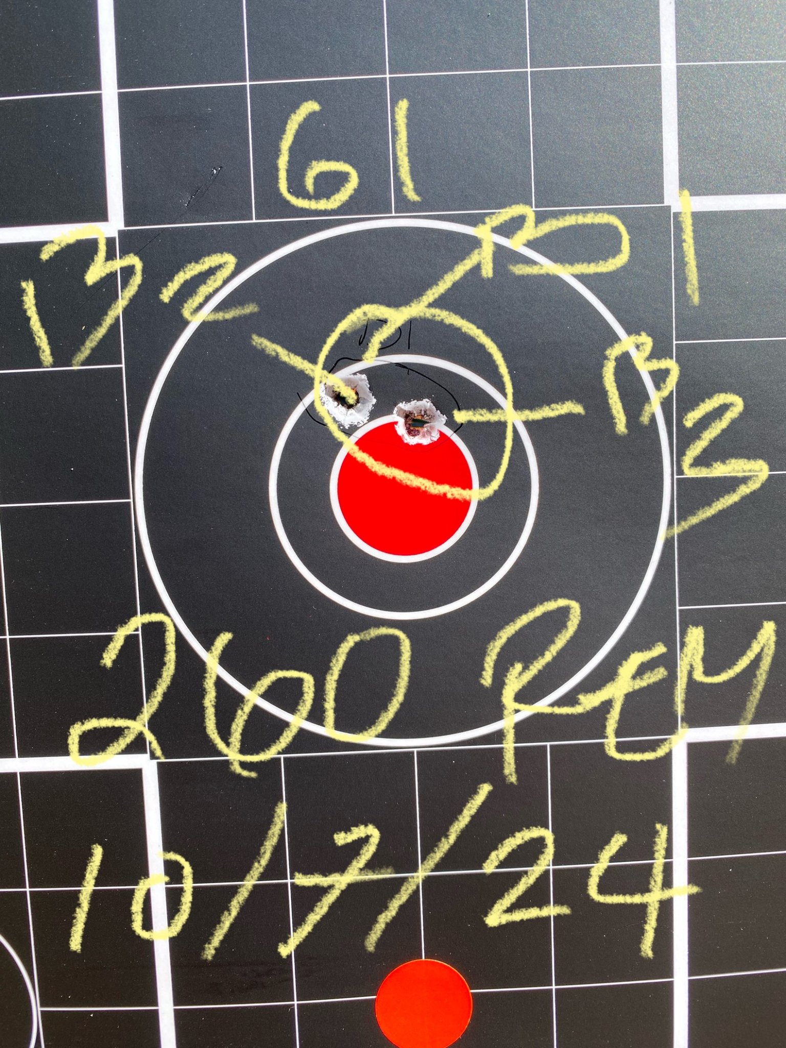

Issue: All three shot groups have a flyer (3rd shot). The first two shots from all groups are always right next to each other. One group in particular had the first two shots in the same hole. Each group consists of 3 shots. I'll be using the rifle mainly for long-range hunting (100-600 yds) and sometimes target shooting to 1K. All cases were NOT trimmed as it is still under the maximum chamber length (2.0655"). No pressure signs on all of the groups shot. The reloading recipe I'm using is from Nosler. The maximum power grains is 46.0 but I'm still way below that. Their recommended powder charge is 44.0 for the most accurate load. The case length in their recipe is 2.036". I'm using my chamber length as a guide vs their recipe.
Group 1: The first two shots (B1 & B2) were the same hole. 3rd (B3) shot was 0.47" center to center.
Powder Grains: 42.0
Group 2: 1st and 2nd (B1 & B2)shot are 0.20" center to center. 3rd (B3) shot was 1.49" away.
Powder Grains: 42.5
Group 3: 1st 7 2nd shot was the same hole (B1 & B2). 3rd shot was 1.3" away.
Powder Grains: 43.0

Please note that Case Identifiers match up with Bullet Identifiers ie. B1 is using C1. What is causing the flyers? I can shoot up to 600 yards with my 6.5 CM (Sako TRG 22) and group a shot at 2".

Yeah I’m thinking I’m probably not consistent with my bipod pressure and shoulder placement. I always blame myself first but when I call my 3rd shots, they go the opposite way. I’m scratching my head on this.
