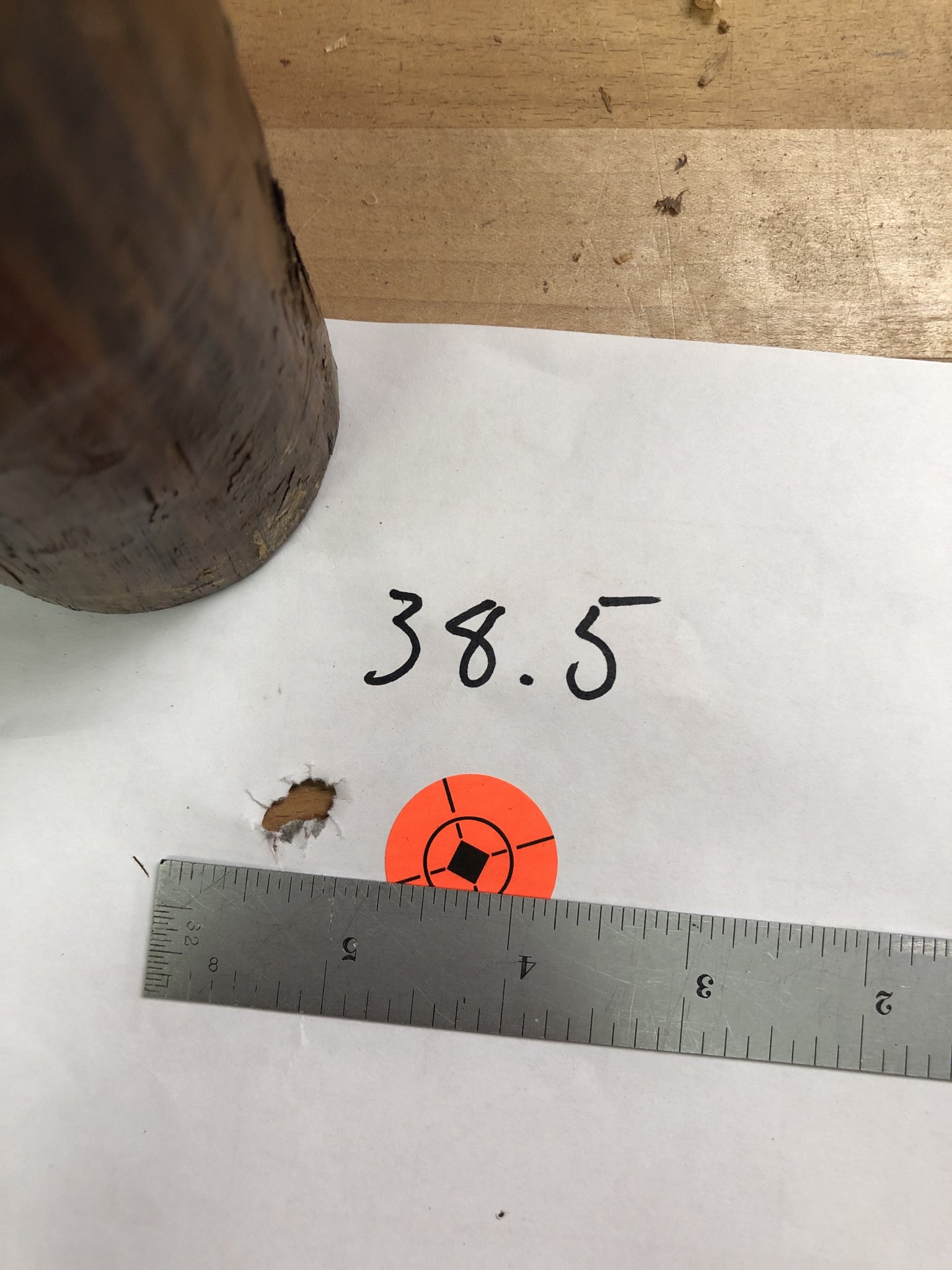

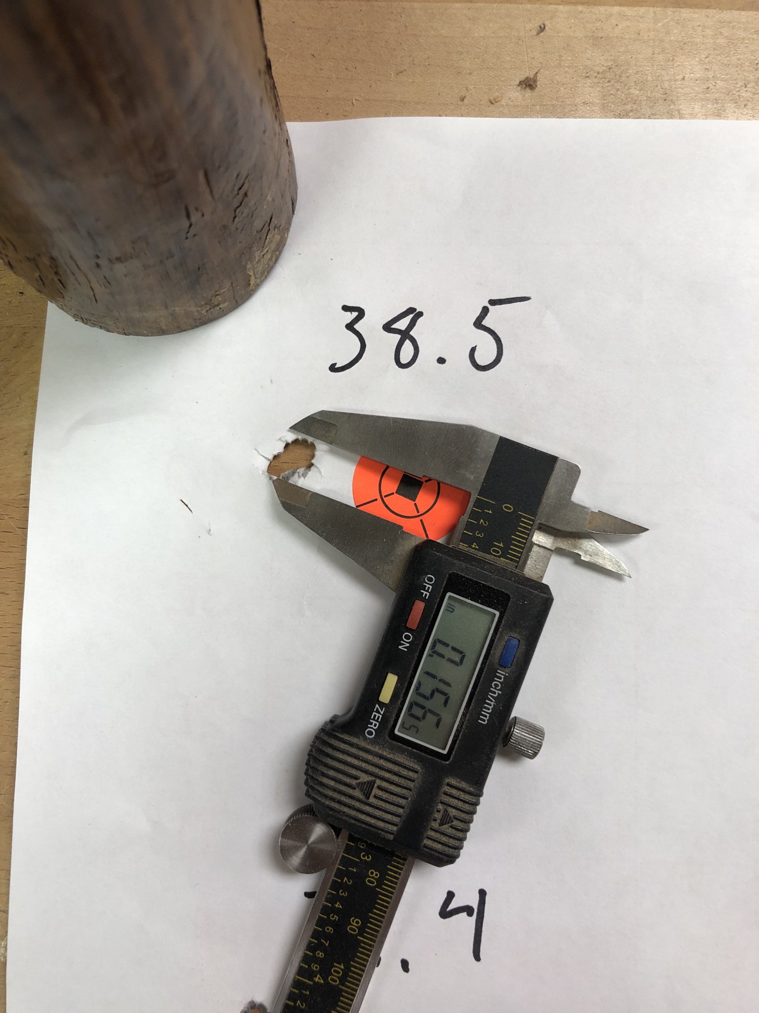

5 rounds 38.5 g of Varget behind a 123 ELDM. Not a screaming fast load but with this kind of accuracy I don’t really care. It will get me out to 1000yards. I still need to work up a 140g load but I think this one is a winner for the 123. I shot 5 groups like this with the largest being .3”. Average of the groups was right around .25. Man I love this rifle.
