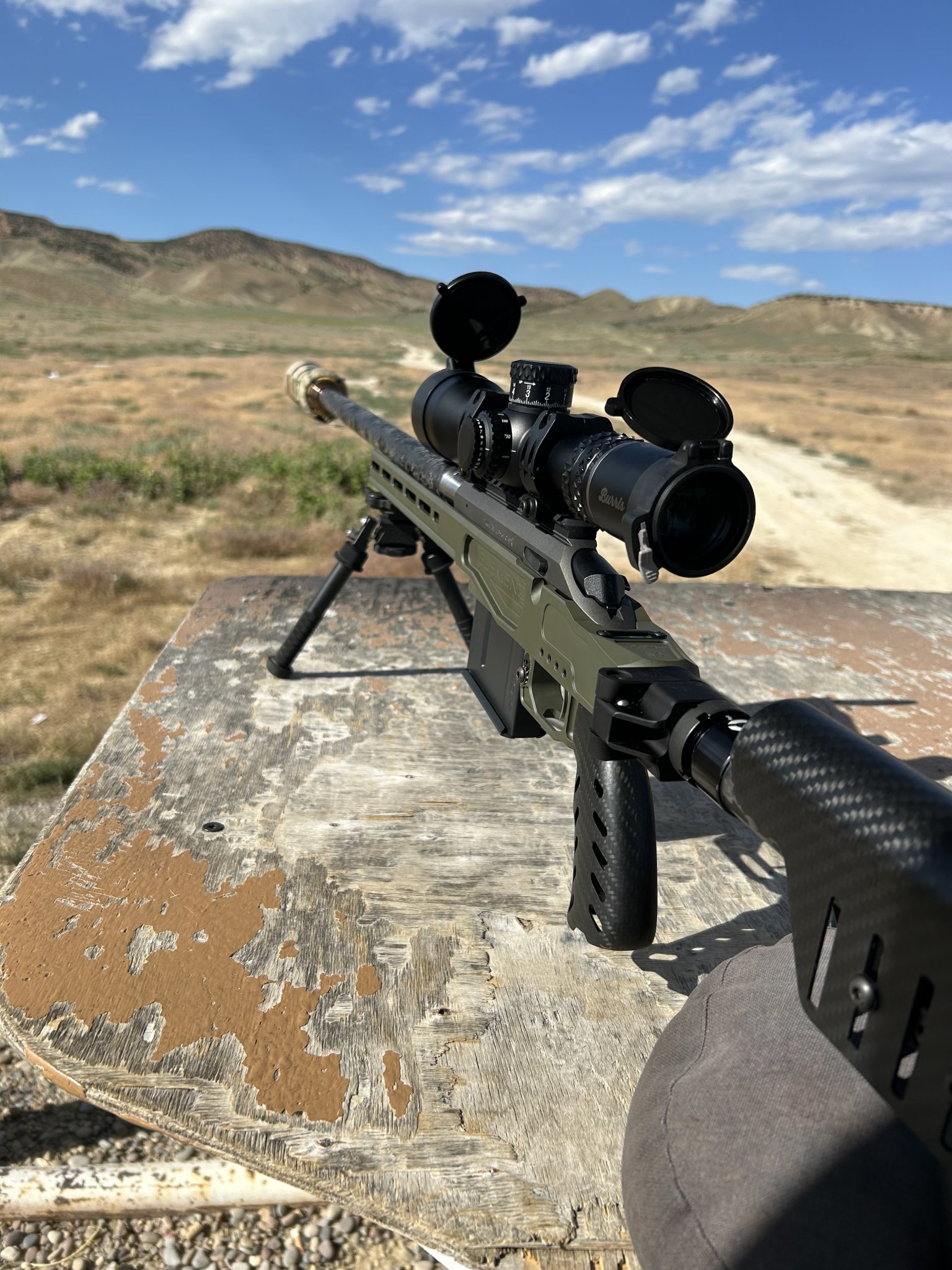

Factory 180’s at 2950 in 24” proof barrel. Popped my barrel off with a 32 or 33mm (I forget) open end wrench buffered with electrical tape. I used a viper vise for both removal and installation.
My XLR Chassis takes the MTD 3.56” AICS mags, coal is ideal.
I'm guessing it's because the length of the PRC and the Tikka action at 3.56. Should work, Waters mags work real well, but they aren't cheap. They are smoother than either the factory or AICS for my 7 Saum.

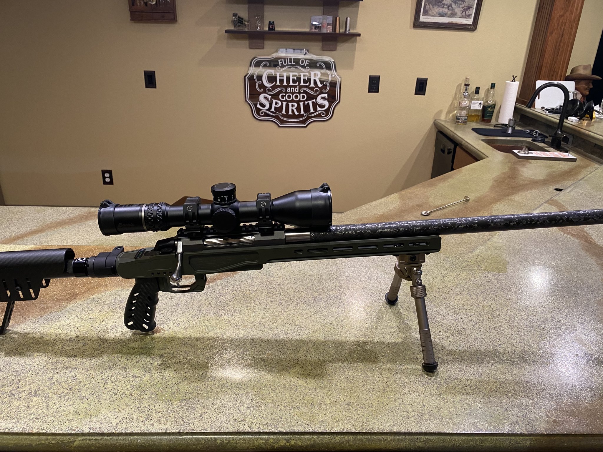

I built a 7PRC on a Tikka earlier this year. MDT HNT26 stock and a 22" CarbonSix barrel.
Haven't shot it much but getting 2875 fps from the factory Hornady ELD-X.
I'm using the 300WM MDT AICS metal mags at 3.56".
