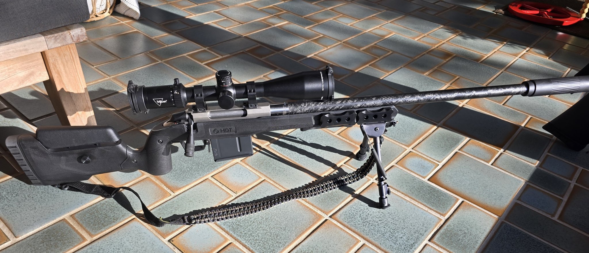

I used my barrel vice and internal action wrench to swap barrels on two different actions on Wednesday.
6.5 CM barrel off my CTR action -> .284 Winchester carbon wrapped barrel on
26" 6mm CM barrel off Karen's T3X -> OEM 20" 7mm-08 threaded barrel from J & A Outdoors on for deer hunting
