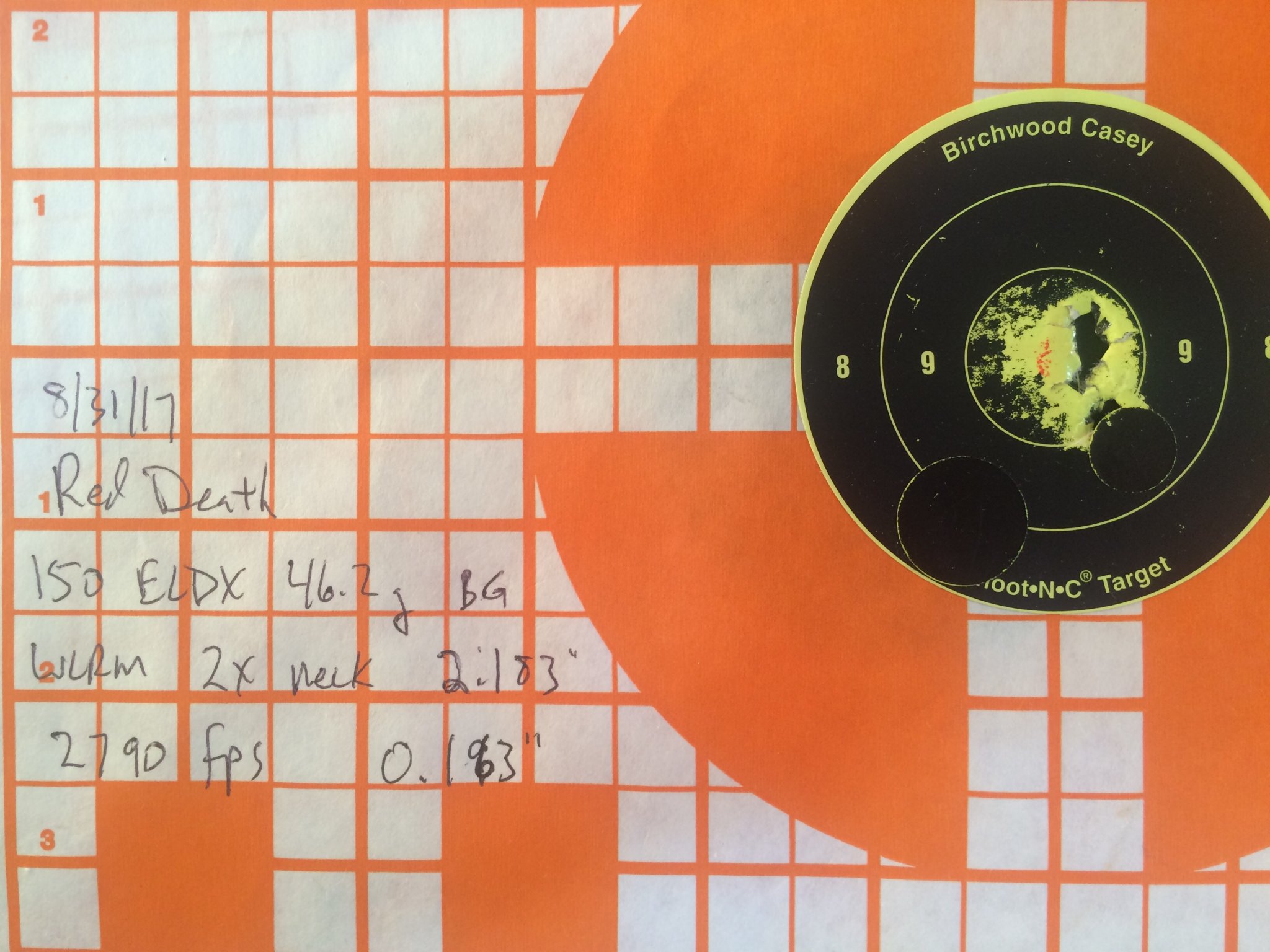

    dump those 150's for 162 eld-m.
    lose about 100fps but gain .1bc
    I thought about it but I don’t kill past 550, maybe 600 yards.
    At what distance does the improvement in bc overcome the loss in velocity?
    And how does the M construction compare to the X? I use the 162 ELDX with great results in my 7mm Rem Mag.
    When I first considered transitioning from the 140 Partition to the 150 ELDX I called Hornady for load data. The tech I spoke with told me they developed the 150 grain with the 7mm-08 in mind.
    P
    P
    Don't do it the eldm is pretty damn explosive
    I did the math. Out to 600 there isn’t much advantage over the 150 and I already have a great load.
