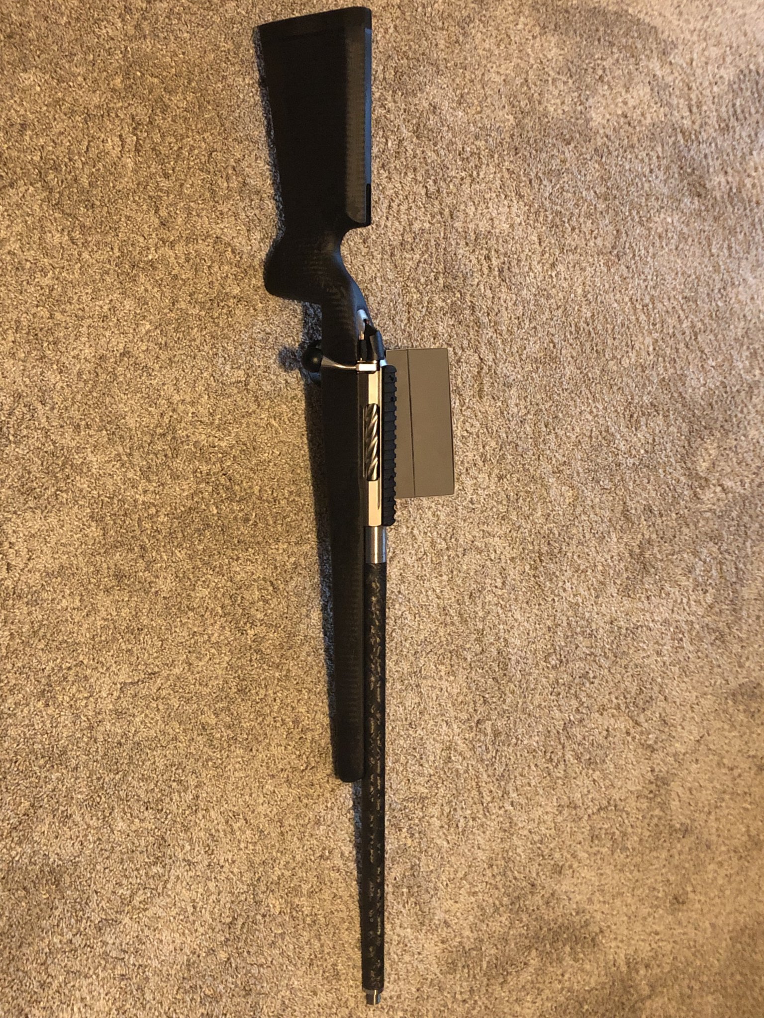

Finally received my Proof 7 PRC prefit for my Tikka T3x action. Is there a shop that you can rent action wrenches and barrel vises from?
