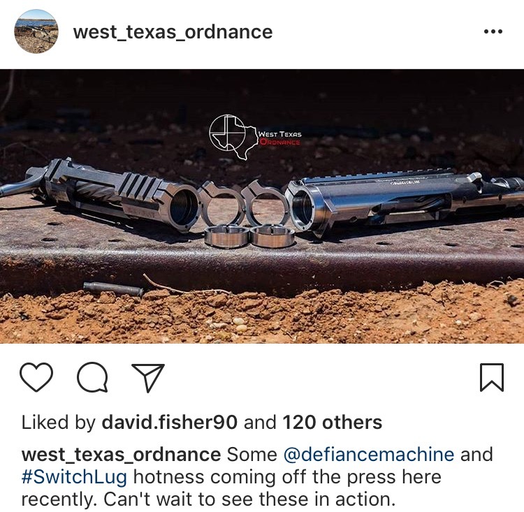

I don't think the Switch Lug from Texas Ordnance will fit on Tikkas
I don't see why not, if you look on Instagram they have pictures where they do not include the "lug" in the Switch Lug system so it is just a threaded collar with the Allen screw
This is what their website says:
"Lugless Switchlug made to interface with actions that have a recoil lug integrated into them. For integraded actions, the face of the action will be machined for two pins, concentric to the bore line, and then the lug simply slides right on! The Switchlug IL also retains the 30 in/lb torque setting.
These actions include:
Surgeon 591 & 1086
Defiance Deviant
Big Horn TL3
The Up Coming Curtis Vector"
I don't now if Tikka action has enough space for drilling the holes you will need to fix the nut. I will try to ask them and post.

I was wrong dannySH I just received an email back from West Texas Ordnance:
Branson,
The SwitchLug is not compatible with the Tikka action. Designing one specifically for Tikka's is a future possibility, subject to the amount of marketplace demand. Thanks!

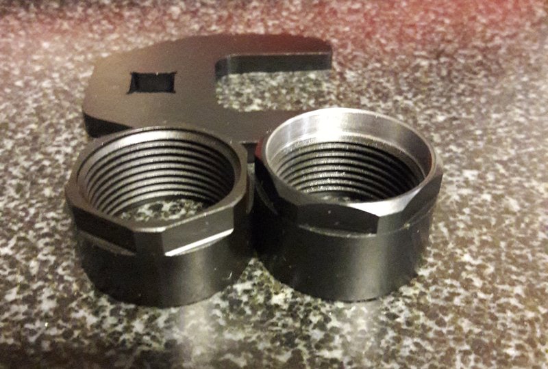

The updated barrel nut that is mentioned above is now on hand. For existing customers that want to change it out I will swap it at no additional cost past returning the old one.
Here's a picture showing the 2 next to each other. Note also that the crowfoot wrench is modified to make it more resilient to crooked installation forces. Previously it worked exactly as designed so long as it was held in plane. It was not possible to over-torque the barrel nut. Now it will be so a torque wrench is HIGHLY recommended but there should be less tendency for crooked torque application to "potato chip" the crowfoot.
Anyone that is looking to swap out their existing nut simply shoot me an email and I'll get you setup.
The website has also been updated to show the difference in a photo and to have a call-out box that stipulates which barrel nut length is to accompany the barrel at the time of delivery.
