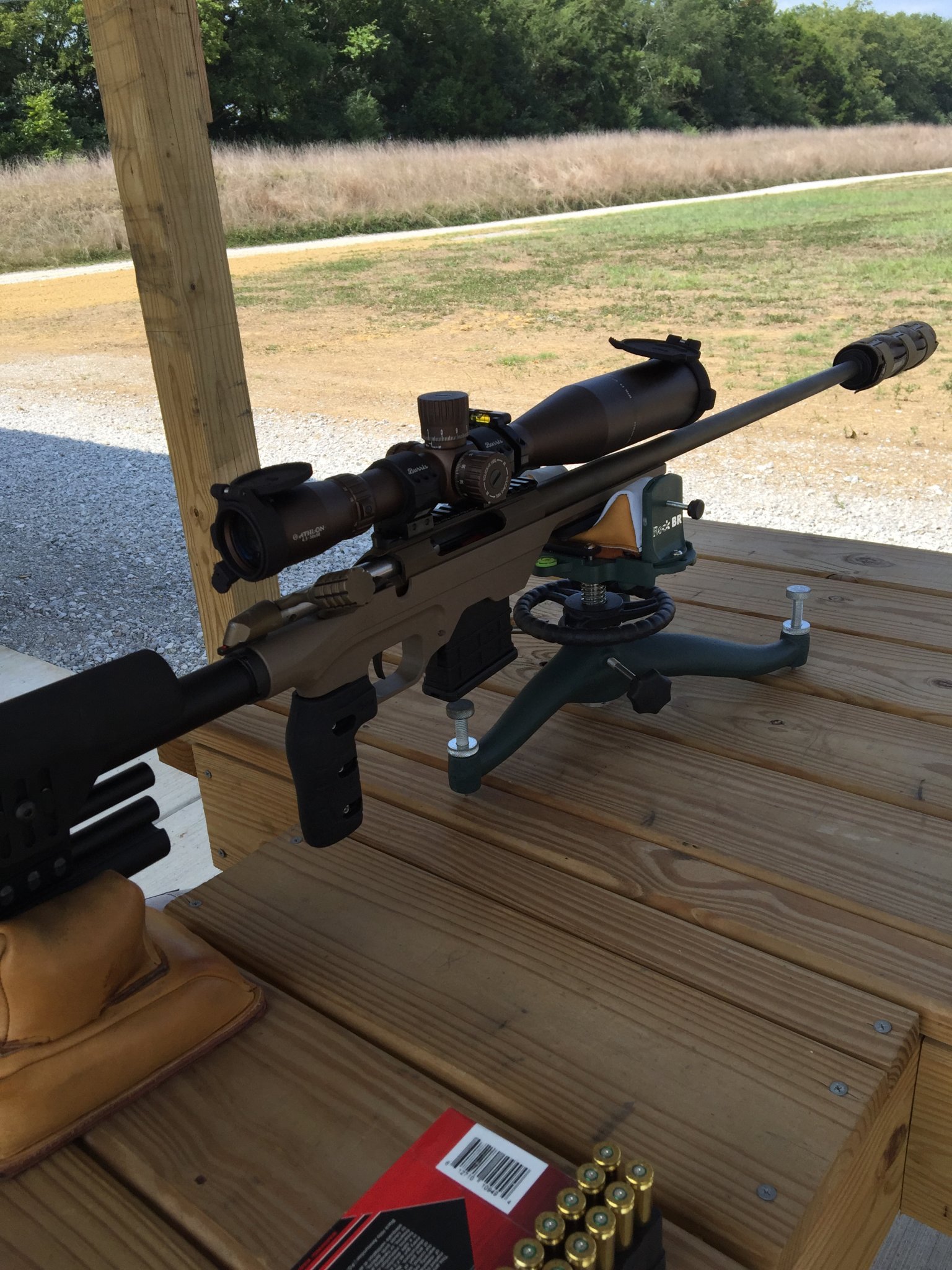

I had a Tikka 3X in .308. It was very accurate. However slower then a turtle. Had a new barrel put on and it made a new shooting rifle. I’ve heard that Tikka barrels are on the slow side.
