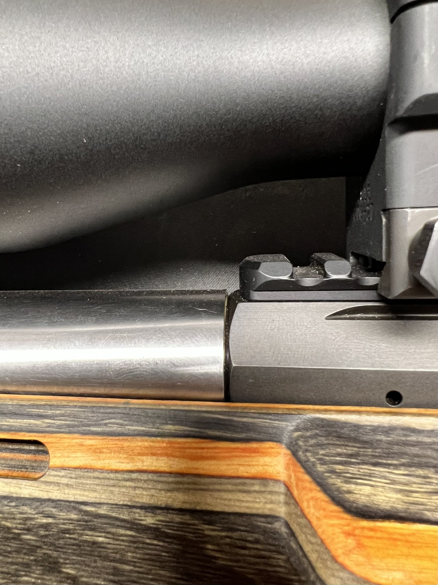

Bringing this back as I just dropped my Tikka off for a straight taper face lift. The gunsmith said he's been truing up the face of Tikka actions for straight tapers to remove the rounded off portion of the face, which makes it look much better. However, doing so will take you out of the pre-fit realm as the headspace will not be the same as factory.
Not that I'm a big pre-fit kinda guy, but it makes me second guess if I should give him the green light to square the face.
I'll post a separate thread as well, just wanted to get opinions here too.
I mean it pretty much wrecks any resale that the action would ever have because of the reason you stated. But if you never plan to sell it then it doesn’t so much matter… do whatever you feel like.
The bottom line is Tikkas really don’t need to be trued other than for aesthetic purposes, and even if you’re not a big prefit guy, having the ability to run one is always a benefit.
Personally I’d never notice the difference between having a 1.200 straight taper and a 1.250 straight taper, so squaring the face has always been a non-starter for me.
This is just what I was looking for. Thanks!
Just called my gunsmith and told him to leave the action as is 👍
