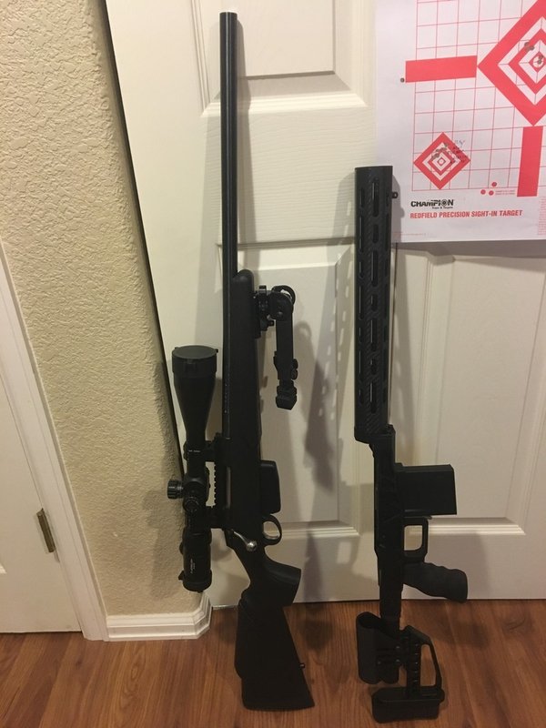

My W3 KRG is pretty heavy, keep that in mind when looking at different stocks. The good part is I can put it back into the tikka stock and hunt with it if I want.
My 20" CTR likes its new home in the XLR Element. It is very comfortable and I have had no issues yet but I am only at 200 rounds with this set up.

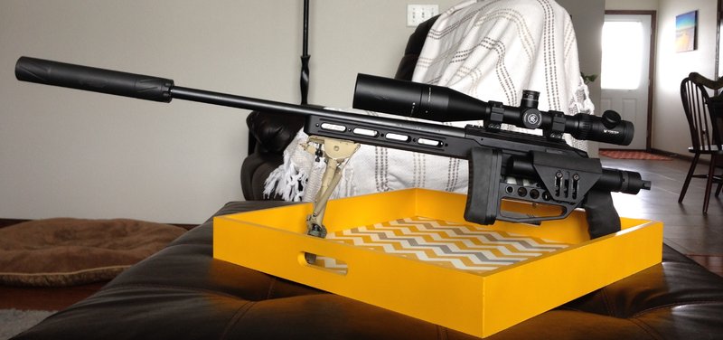

Mine sits in a Wombat Ordnance chassis. Looks exactly like an AIAT -same functionality. Cheaper. Other than purchasing and using the thier product I have no allegiance to the company. Left and right hand tikka CTRs in Wombat stocks are in the picture

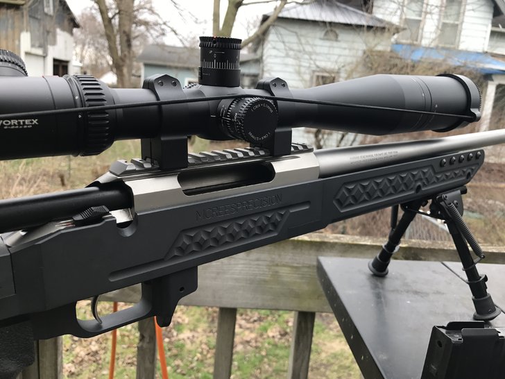

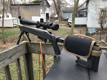

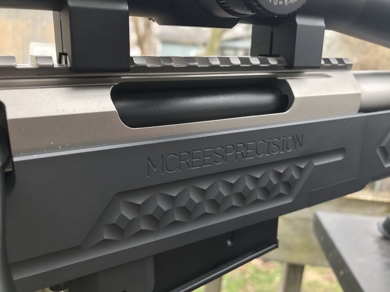

I have a MCree and love it. In fact going to put my 110FCP 338 in one soon.
