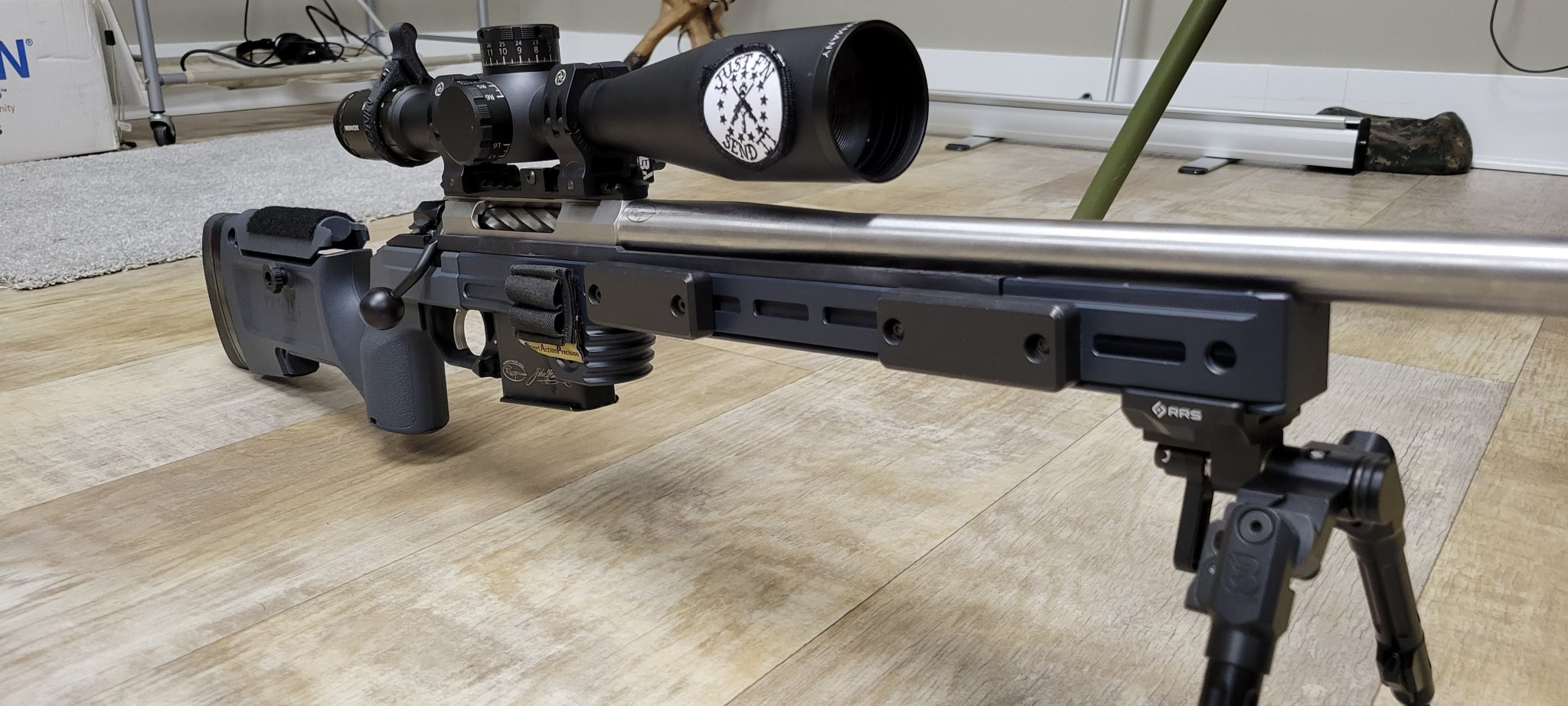

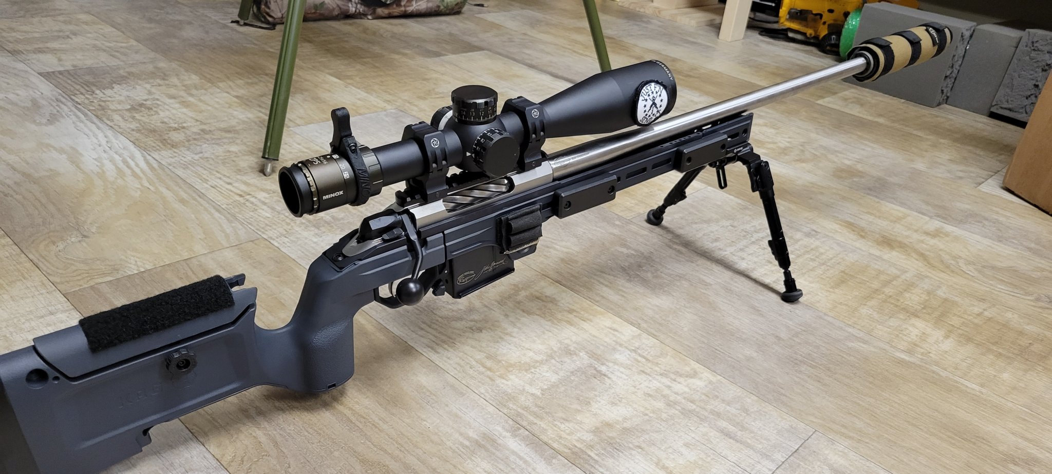

Bravo with the Vision fore end FTW.
This is my hunting rifle that I am so tempted to shoot a match with.
View attachment 7831228View attachment 7831234View attachment 7831235
I didn't realise this was an option, how do you order the forend only?
My biggest problem I have with chassis is I don't tend to like all the stabby bits when carrying the rifle and most of these come from the pistol grip and butt, the Vision forend and Bravo assend is a nice solution to this.
Reactions: BLKWLFK9
