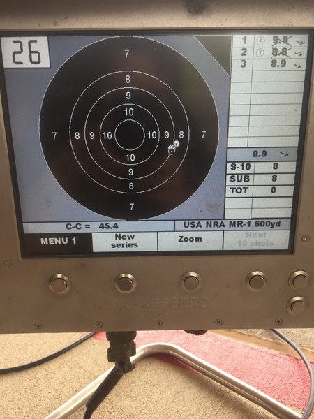

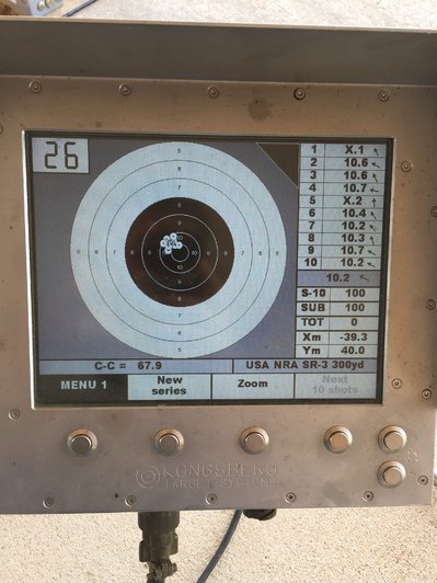

24" CTR 6.5CM shoots Hornady 129gr SST super performance at ~2950fps. She is a sub-MOA gun for sure.
3 shot group at 600 yards was 45.4mm = 1.79"
10 shot group at 300 yards was 67.9mm = 2.67"

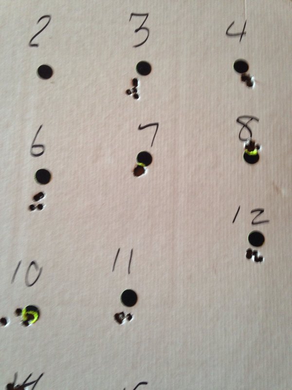

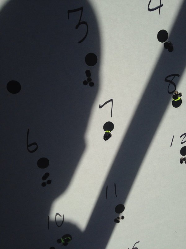

So, here are the results from my last outing with a 20" CTR in 6.5 cm (although I've put mine in an XLR chases and spent $10 to upgrade the trigger spring). All are 5 shot groups off a sandbag at 100 yards. Scope is a SWFA 12x.
.40"
.60"
.60"
.50"
.70"
This is 25 consecutive shots, not a bunch of cherry picked groups. Ammo was Hornady factory match (not sure exact weight of bullet as a variety of ammo).

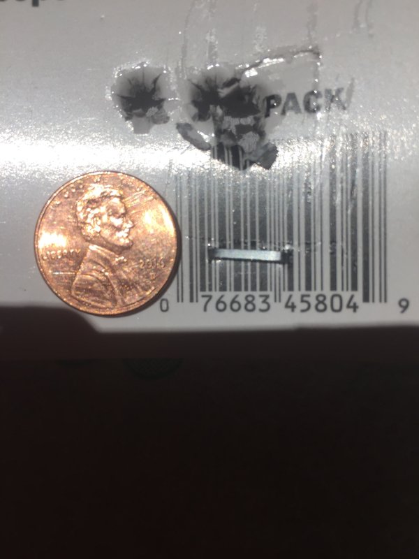

I've seen a CTR T3x 24" SS 6.5 shoot a one hole group with the Hunter 143 Eld-x's. All the rounds touched, but they did string a little horizontally. The barrel is a little thin for competition. It was in a brand new master piece arms chassis. It had seen 800 rounds down the barrel. The action and trigger were a lot smoother/lighter than my same gun/model.

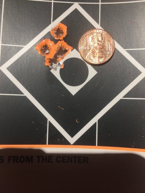

This is a three shots group at 100 yards testing my new load with my 6.5 CM CTR 24" SS on a Manners T6A.
Not sure if it's me or the rifle but recently I've been shooting a lot of .5" and sub .5" 100yrd groups out of my 6.5 20" CTR. ALL of my groups in the last 100 or so rounds have been under .8" using 140gr ELD Match.
