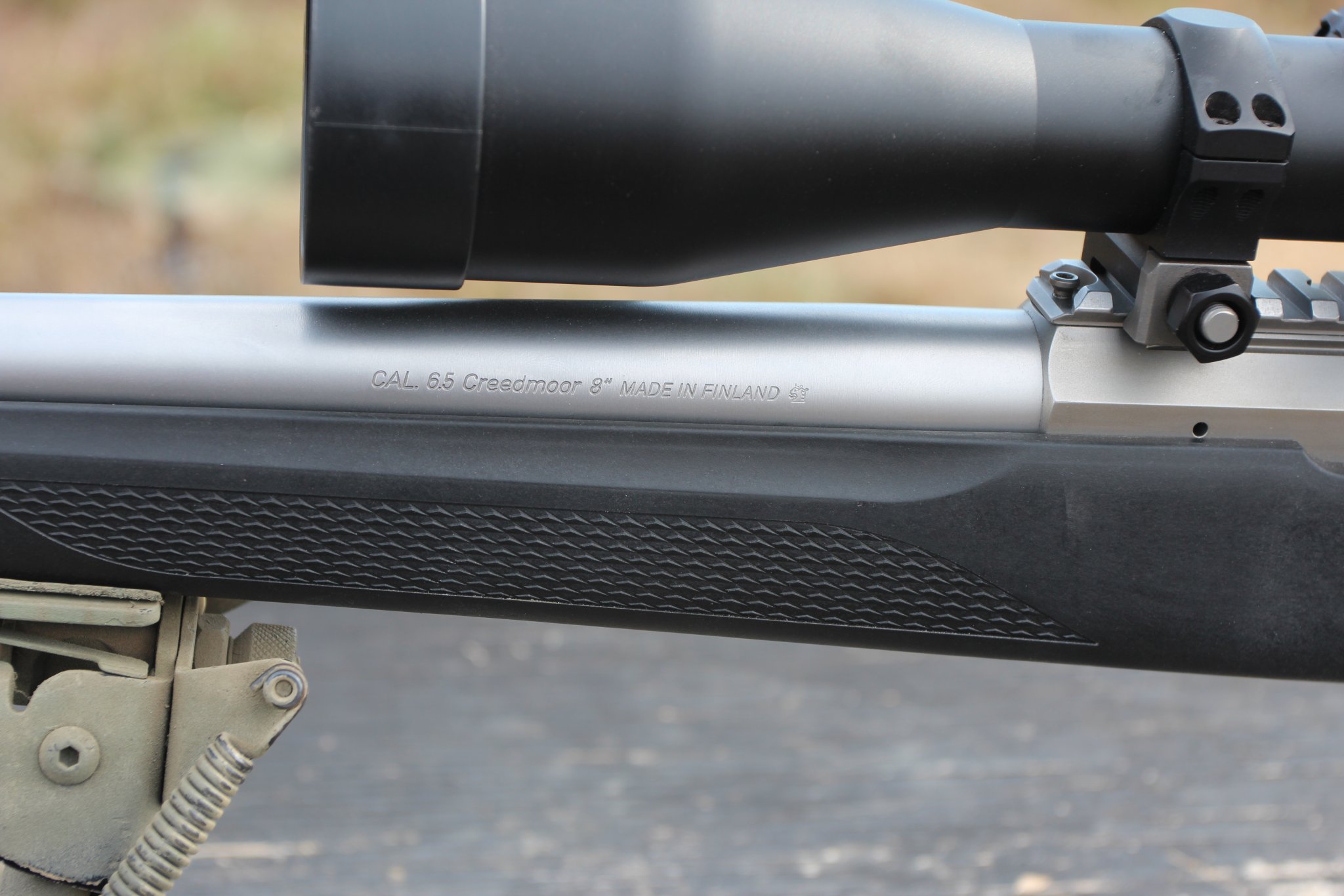

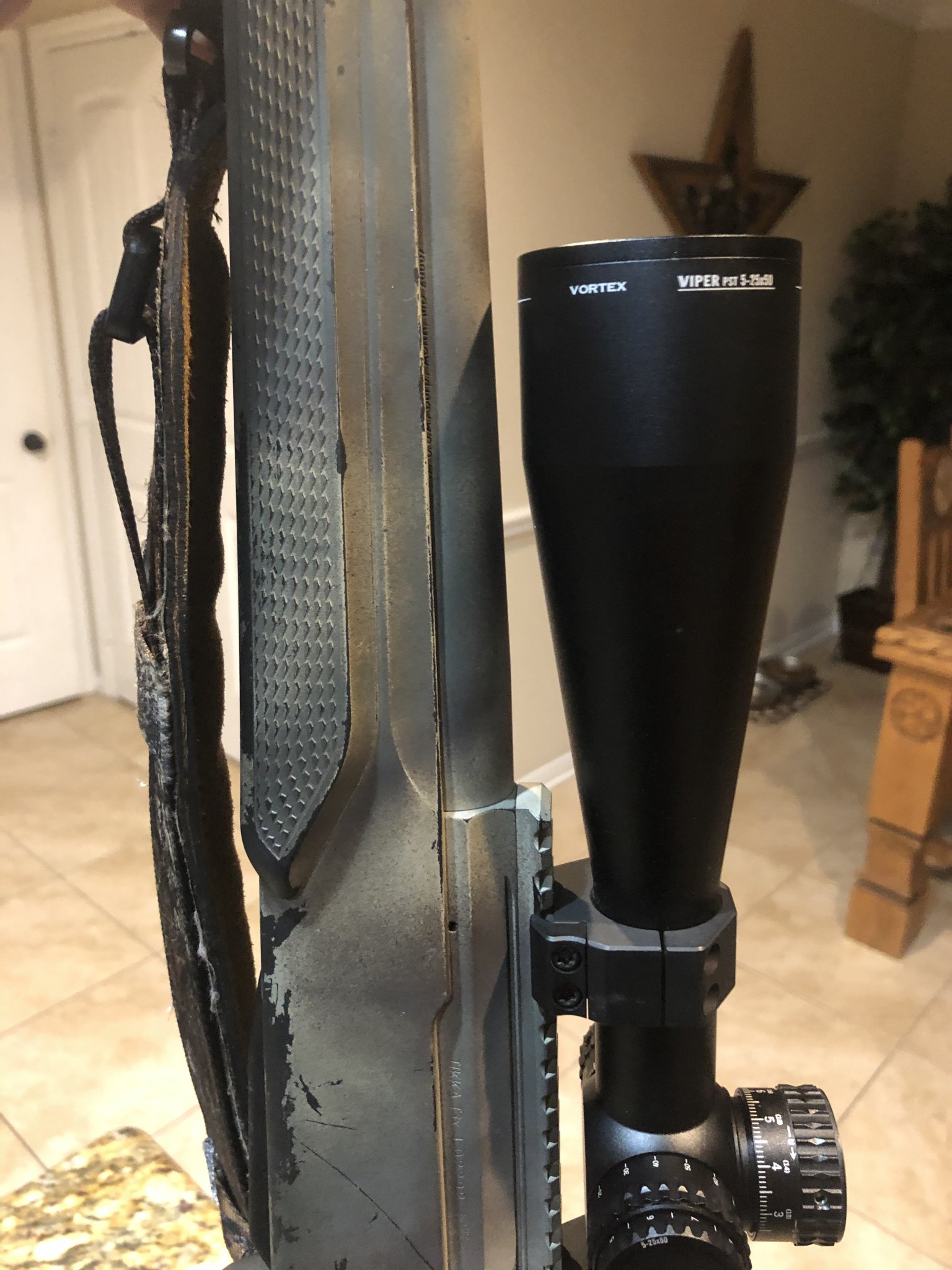

Do not go lower than a .97” ring on a Tikka. The scope bases are much shorter than Remington 700 and clones and savage as well. You have to go up one size. The .91” may work but you will be cutting it close. I wouldn’t do it.
.97” and 50mm objective.
It’s a Mountain Tactical 20 moa rail. Anything with a built in recoil lug should be good. Area 419 seems to make good stuff that people like.
