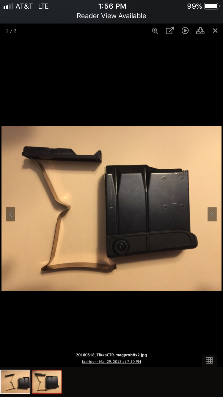

Easy suggestion is pull the mag spring on all your mags and check them against these pictures. If they already match, you know it's not that. If they don't you're not out any money to fix it. There might be something else wrong but you will at least knock one out.
