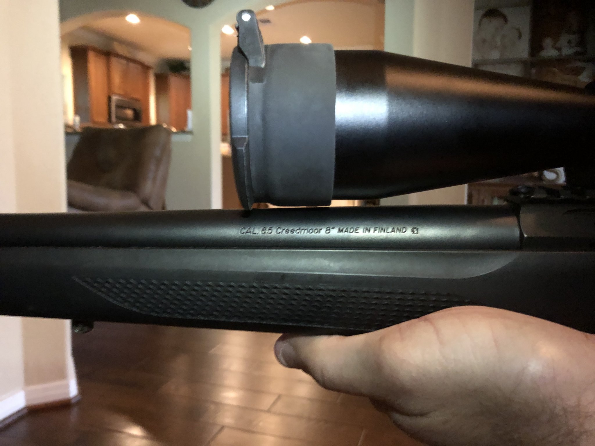

I took this for you OP. This is a 50mm objective with .97” rings.
Very helpful! Thank you.
