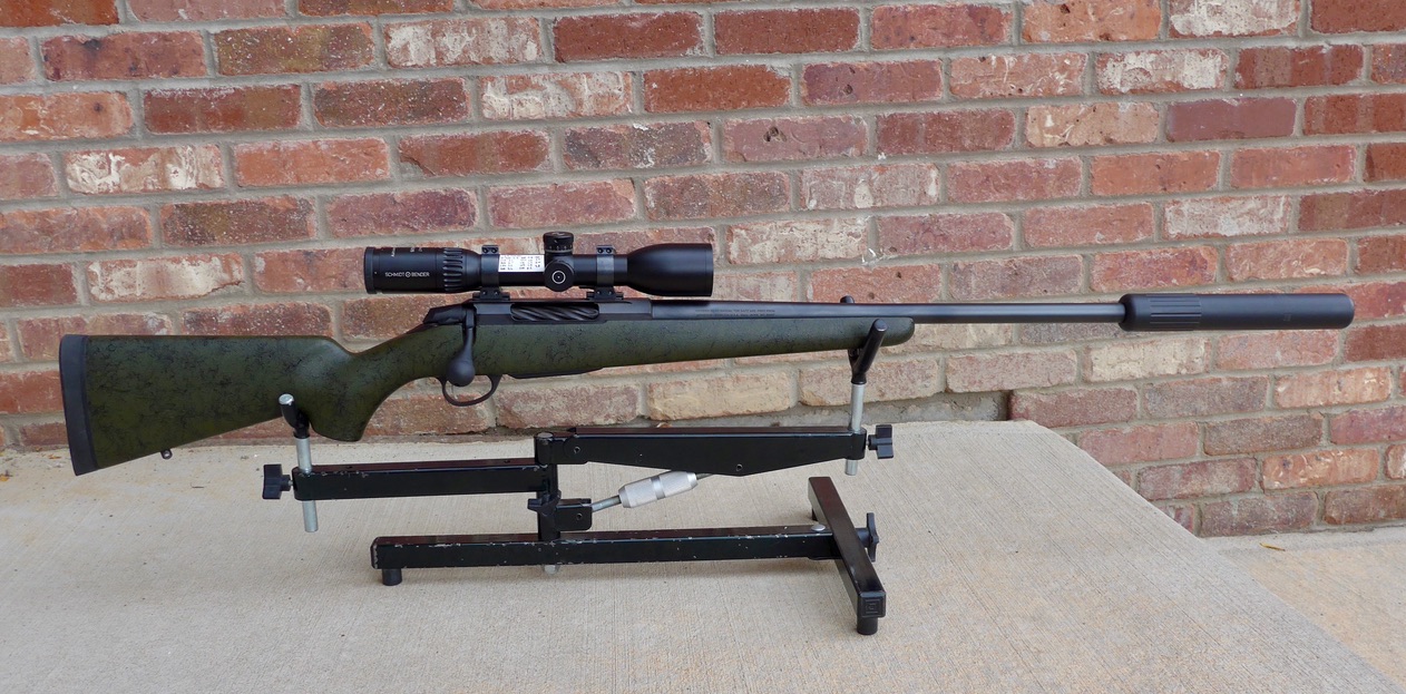

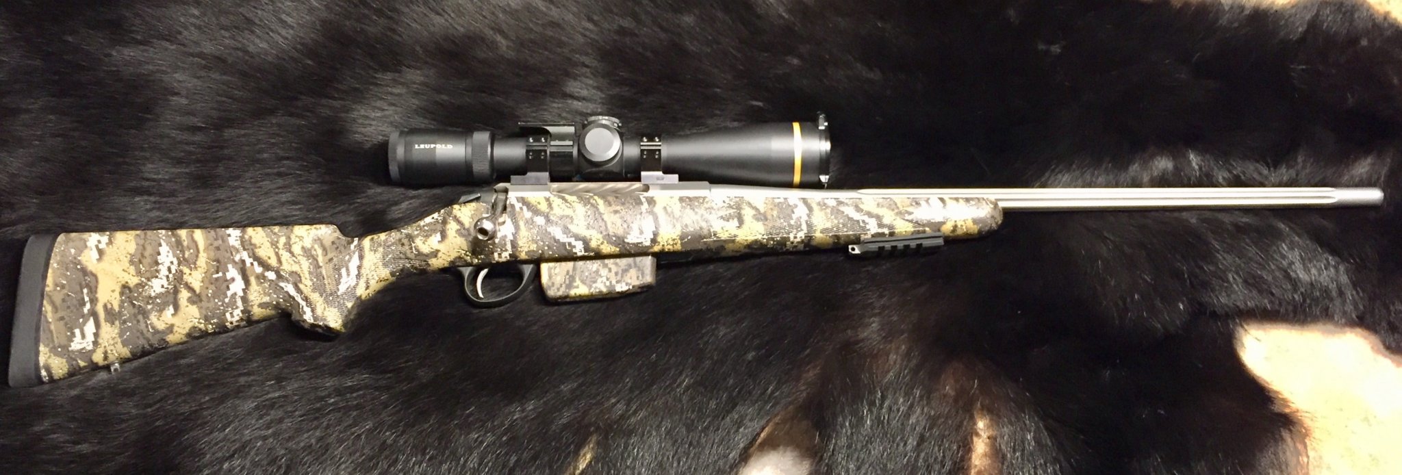

Get a CTR and drop it in a regular B&C stock or any other tikka stock. A little of inletting with a socket and emory cloth and you will be good to go. My rifle is a true do-all and only weighs a bit over 7 lbs without the supressor and with a Leupold 2-7 on it. I ditched the rail and use Talley removables, so I can use any of 4 scopes depending on what I am doing that day. You will need a magazine retaining spring though and those are not easy to come by.

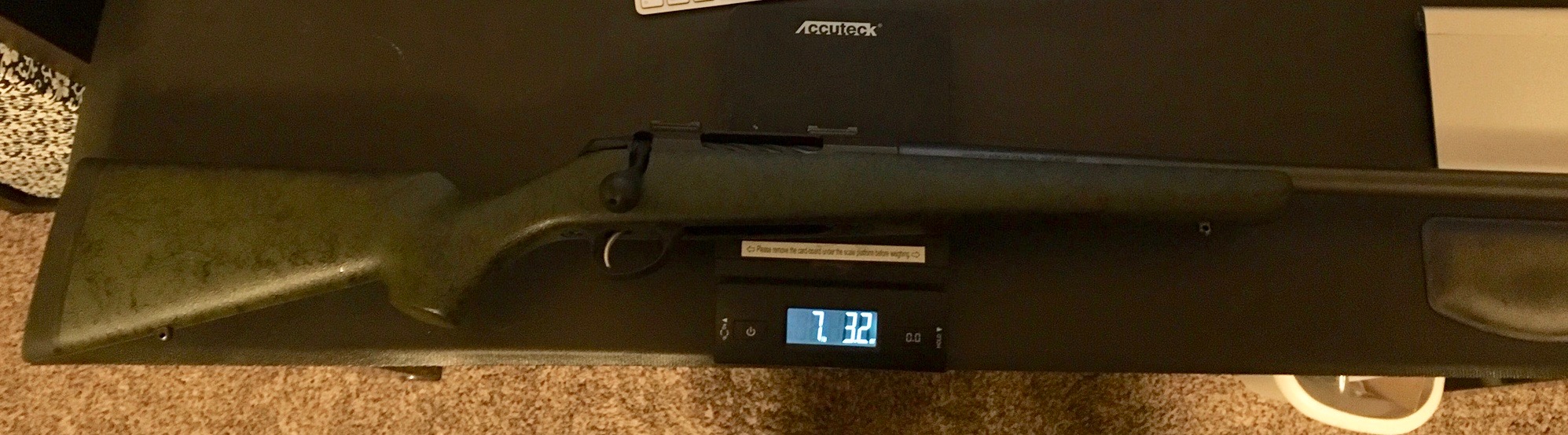

The rifle looks awesome Roggom. Thanks for the idea. Where is the weight savings coming from? Is the factory stock pretty heavy? Approximate cost to complete everything?
Do you know what the rifle weighs naked - no scope or suppressor?

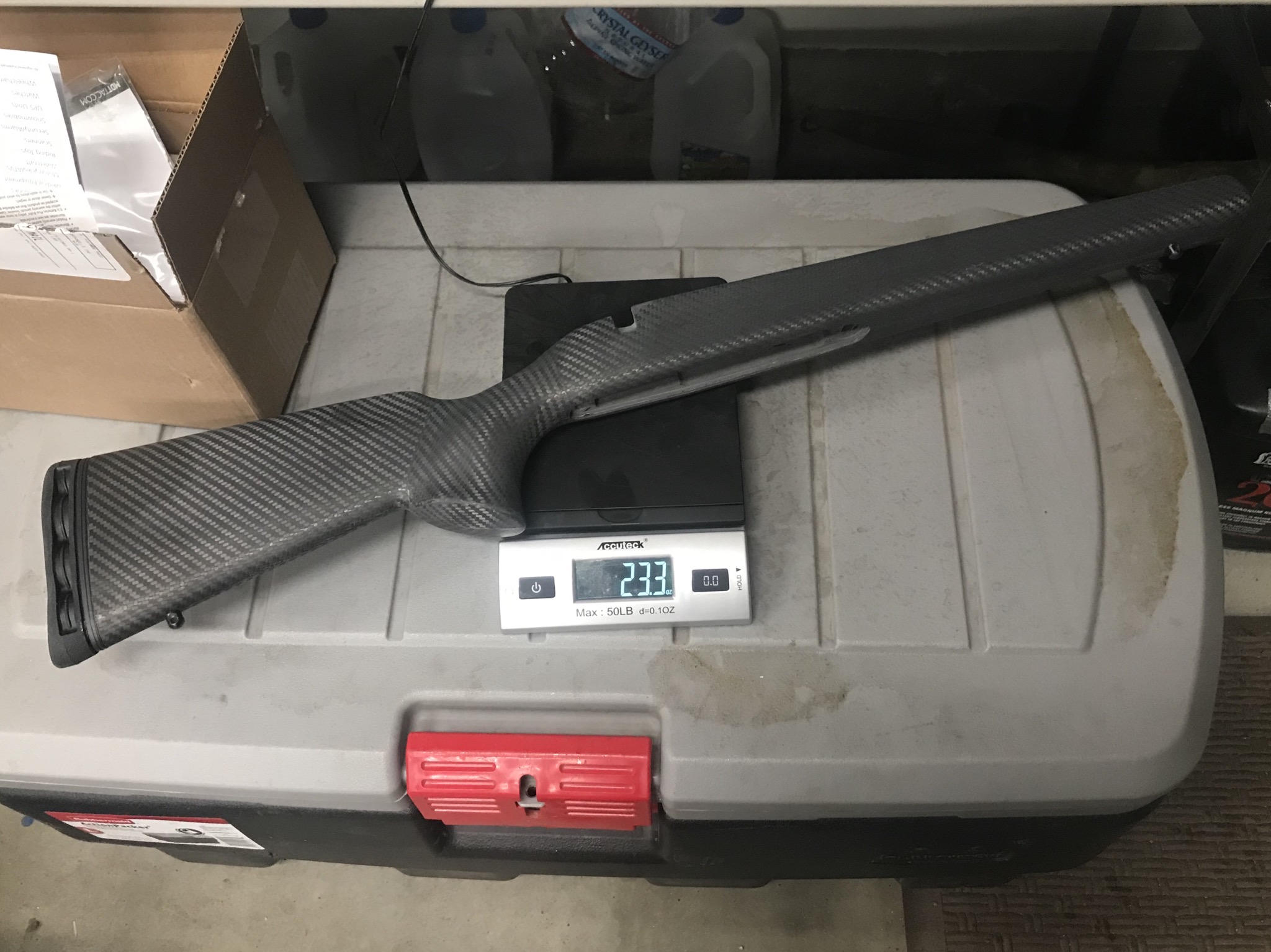

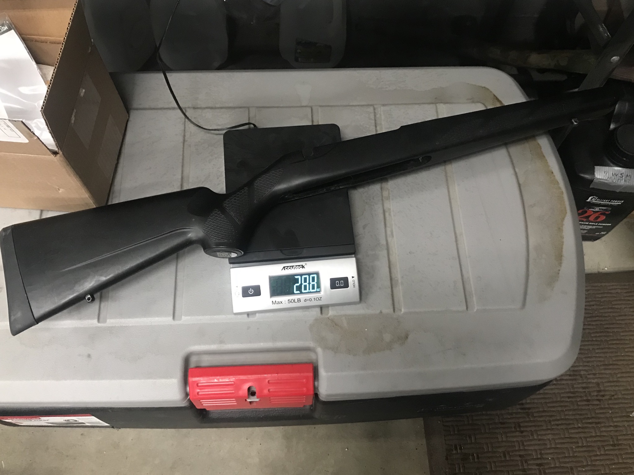

While I can’t find the pic of my CTR stock but I recall it being roughly 32 oz before bottom metal.
The 6.5 superlite I have with the 24” barrel is 6 pounds 5 oz with a pic rail.
Putting the CTR in a lighter weight stock will drop it roughly 1/2 pound plus swapping to standard T3 lite plastic bottom “metal” and mags instead of CTR will save ya another 4-6 oz. Taking the 0 moa rail off the CTR and putting sportmatch rings on will save ya another few oz. Bascially the CTR can be taken down closer to 6.5-6.75 pounds (in 20” model). Compare that to the 6.3 pound 24” with a pic rail superlite in OEM stock. If weight is truly that critical.

mine weighs in at 7lbs 3 oz without scope or can.

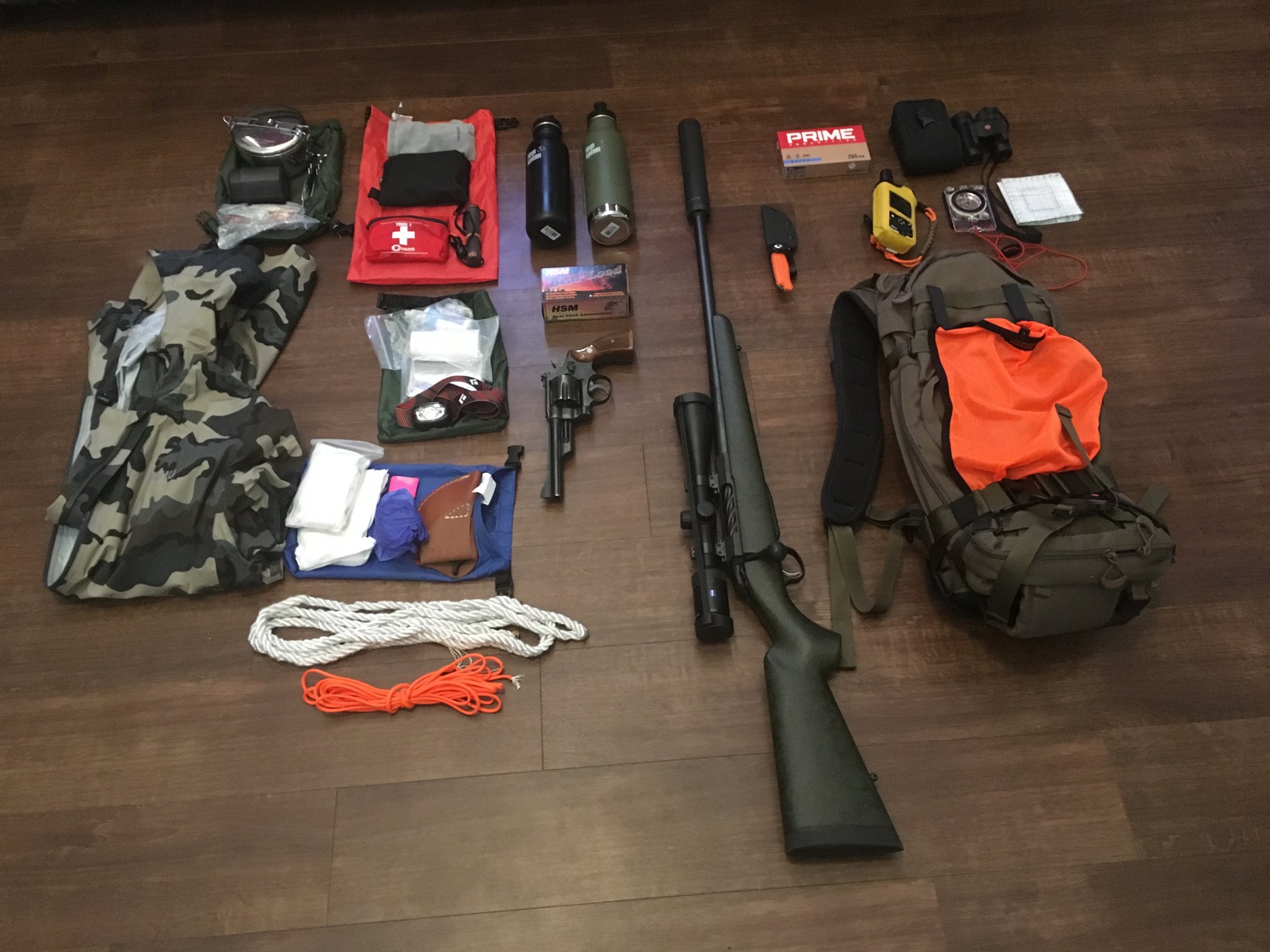

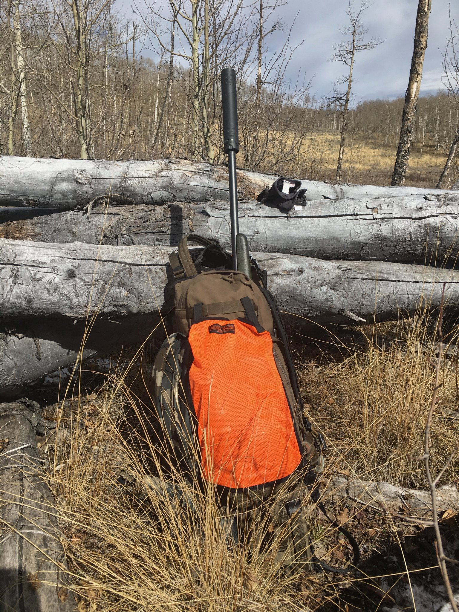

I hunt some pretty thick and steep mountains. I use a Vorn pack and have the rifle centered in my back as I traverse. I dont carry a bunch of gear, a day pack at best.
https://www.amazon.com/Vorn-Lynx-Hu...3MJF2R1RJDAQA5WBF&refRID=JYD3MJF2R1RJDAQA5WBF
Reactions: PFG and physguy88
View attachment 7005079View attachment 7005080

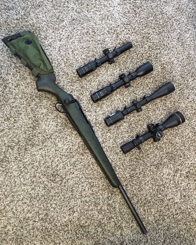

Very handy setup, Roggom. I'm building something very similar (dropping a CTR in the B&C Medalist). Going to run the long bolt stop option and the long tikka mags to seat 178gr ELDX's far out. Is yours a .308? Mine will wear a 3-12 LRHS.
How do you like the Vorn and how is it holding up?
I have gone through many packs, slings etc. For the terrain that I hunt I need two hands to travers the inclines. The Vorn it just the right size for me and my minimalistic load out. I like that I can just grab the barrel and retrieve the rifle from the side; rather than try to pull it up and over. Also no more rifle swinging around when Im climbing. The Tikka fits perfectly.

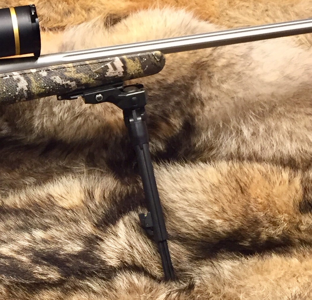

View attachment 7015196View attachment 7015197
can I get specs of your build. pretty much exactly what I am looking to do.
