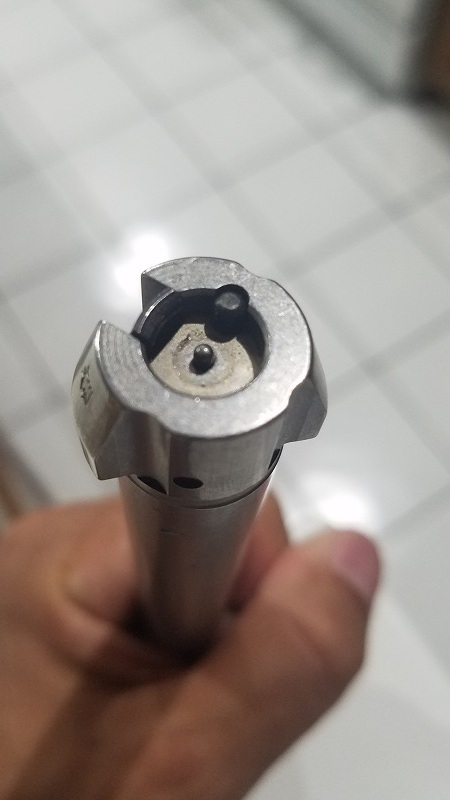

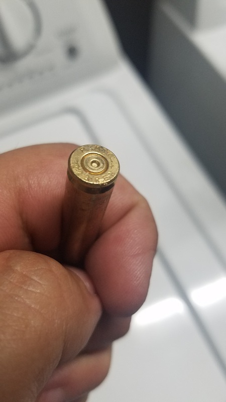

So I recently picked up a Tikka T3x Varmint in 223. Before working up a hand load I decided to shoot some factory ammo through it. I have Nosler Custom Competition 77gr and Black Hills 77gr. Neither load was showing any real signs of high pressure but they were showing "denting" from the firing pin which was way more than I've seen in either of my other rifles. Several of the Nosler actually pieced the primer (20% of the time). Firing pin protrusion on my custom 700 and Surgeon Scalpel for have right at .060" protrusion, while the Tikka has .071". Thats a big difference.
Anyone seen anything like this before?

I just bought the same rifle and have not seen dented or pierced primers. Since I load my own rounds I have been paying close attention during load development. All I have ever witnessed are the normal signs when I get on the high end of the powder charge such as primer cratering, flattened primers and some ejector marks. I might be able to measure how far the firing pin extends from the face of the bolt for you on mine this weekend?

I'm just about to send it off to get the firing pin hole bushed and taken down to a small firing pin size. I hate to do that on a brand new rifle.

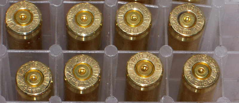

If you are seeing ANY pierced primers, you need to stop immediately and figure out what the problem is. Even if you are not worried about safety issues, the plasma coming out from the pierced primers will start to etch you bolt face, damaging and weakening it. It’s hard to tell how deep your primer strikes are but here is a bunch from my own Tikka T3x Varmint in .223 – Lapua brass and Wolf SRM primers. Pretty hot loads but have never seen any pierced primers. DSCN3903.jpg
I measured 0.069" from the top of the firing pin to the face of the bolt ( where the face of the case head rests). I do hope you solve the issue because these Tikka Varmints are very accurate and fun rifles.
