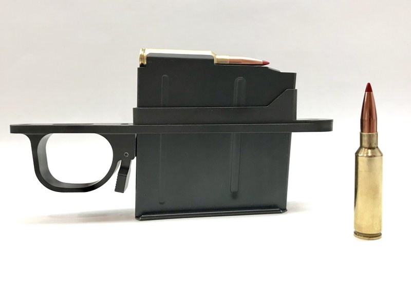

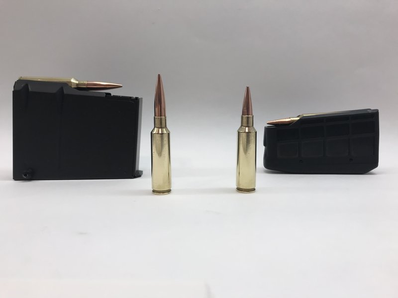

    We gotten this question a lot lately. Here are some additional options...

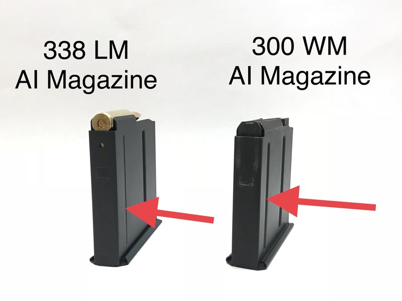

    Solution 1... Use a Accuracy International .338 AICS Magazine (3.715 length). The ribs are shallower on their 338 Magazine than their 300 WM Magazine
    Solution 2... Use MDT AICS 300 WM or 338 Magazines (3.715 length). The ribs are shallower on both of these compared to the Accuracy International 300 WM AICS Magazine.
    Solution 3... Use Sako/TRG 42 Magazine. The double stack mag accommodates the cases very welll. Essentially creating a long/magnum action CTR
    Our AICS Bottom Metal will fit in factory stock and accepts any 3.715” AICS Magazine. Our Tikka TRG Bottom Metal will not fit factory stocks.
