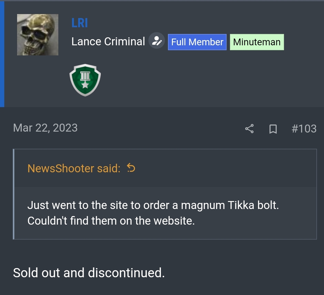

LRI we’re making Tikka replacement bolts I understand
