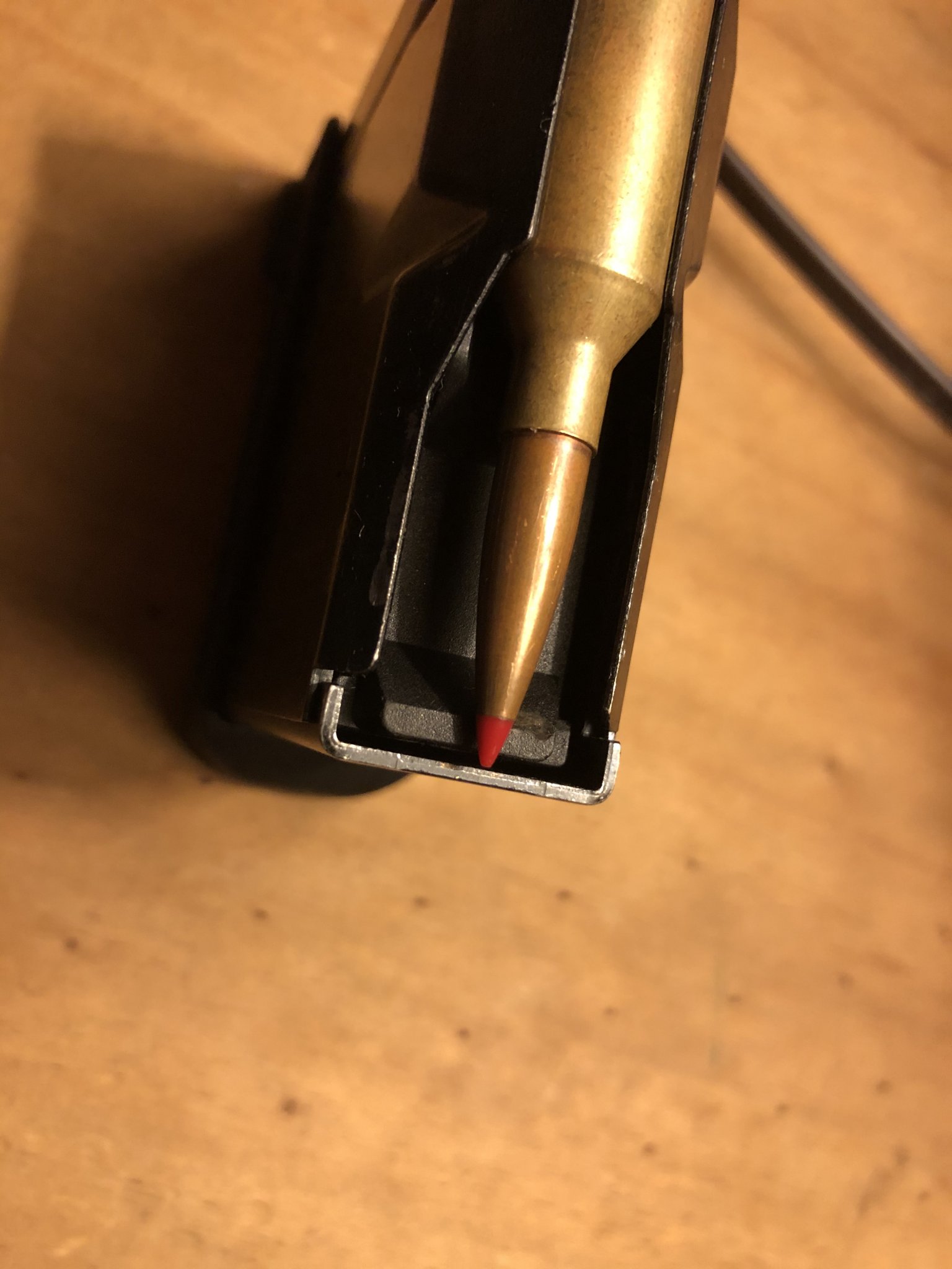

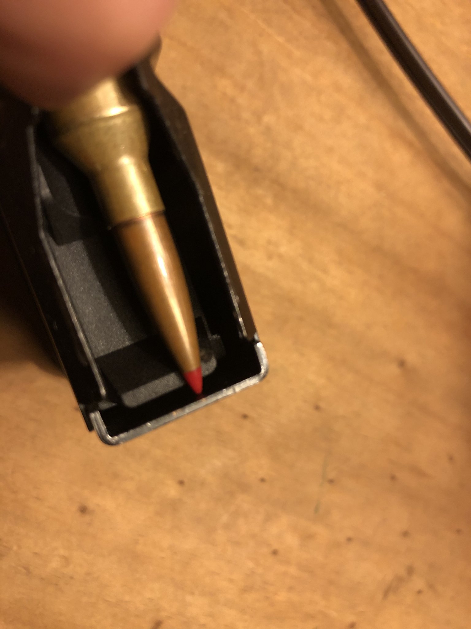

Factory Hornady 6.5 PRC 147gr ELDM fIts in CTR mags. There is enough room to wiggle the round back and forth. This would be the max OAL for the mags though.
In the first photo you can see the clearance. In the second I am pushing the round down inside the magazine.
That's tighter than I'd prefer. Recoil could deform tips. Any field debris could cause feeding issues. The problem with the prc is the long ass 188 freebore. This was intended for the heavy eld with long bearing surfaces. But if a guy uses Berger or Sierra bullets with shorter bto measurements, coal will exceed 3" quickly and not be mag fed unless you're a long way off the lands. A guy would be better off getting a 140 freebore chamber and seating the factory ammo another 45k deaper w/ a seating die. This chamber would be much friendlier to hand loads and mag feeding.
