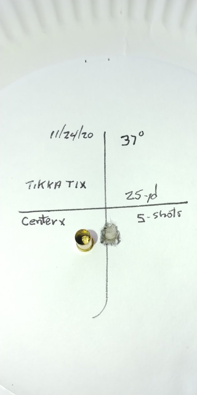

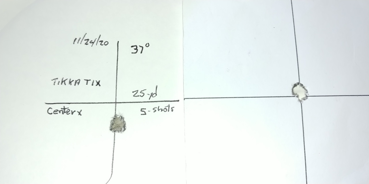

Got the KRG on the T1 X, 419 30 MOA rail, Vortex PST Gen II 3-15X44 FFP MRAD, Stock trigger. 25 yards Center-X. Took 5 shots to get scope sighted in. 2nd 5 shot group a bit low, 3rd 5 shot group after scope adjustment on the cross. Used magneto speed to gather velocities.
The bottom line is 5 sight in shots. The top 2 lines are the 2 - 5 shot targets in photo.
When figuring a dope chart for distance should I pick the highest vel info or add the info of all three together and divide by 3.
Didn't get a chance to shoot farther today, That will come later as weather permits. Spent 22 case in 4th pic.
