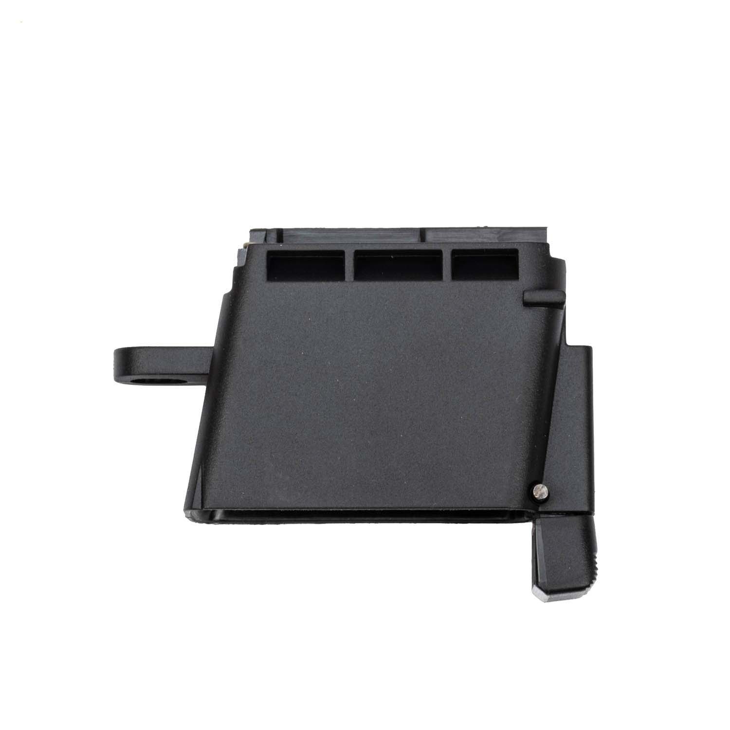

6 6.5SH Two Star General Full Member Minuteman Jul 24, 2020 6,703 12,353 Jul 9, 2024 #2 Jul 9, 2024 #2 platapus said: I have one in a KRG and need a replacement. I didn’t see one listed on KRG’s site or Anarchy Outdoors. Anyone know where to get a couple? Thanks Click to expand... Not seen that listed separately only as an assembly at a ridiculous price: Tikka T1x Magazine Guide Assembly, .22 LR (Pre '22) Check out the deal on Tikka T1x Magazine Guide Assembly, .22 LR (Pre '22) at MGW www.midwestgunworks.com You can try contacting Beretta USA but good luck with that https://www.beretta.com/en-us/service Your best bet would be measuring one and seeing what Wolff, Brownells or McMaster-Carr has that can be adapted. Reactions: platapus

chzhd Sergeant of the Hide Full Member Minuteman Oct 29, 2018 119 80 Mo Sep 16, 2024 #7 Sep 16, 2024 #7 McMaster-Carr McMaster-Carr is the complete source for your plant with over 595,000 products. 98% of products ordered ship from stock and deliver same or next day. www.mcmaster.com Spring TypeCompressionSystem of MeasurementInchLength0.375"OD0.148"ID0.106"Wire Diameter0.021"Compressed Length @ Maximum Load0.223"Maximum Load3.2 lbs.Spring Rate21 lbs./in.MaterialZinc-Plated Music-Wire SteelEnd TypeClosed These springs worked great. Here are the spec. in case McMaster changes the P/N. T Reactions: 6.5SH
