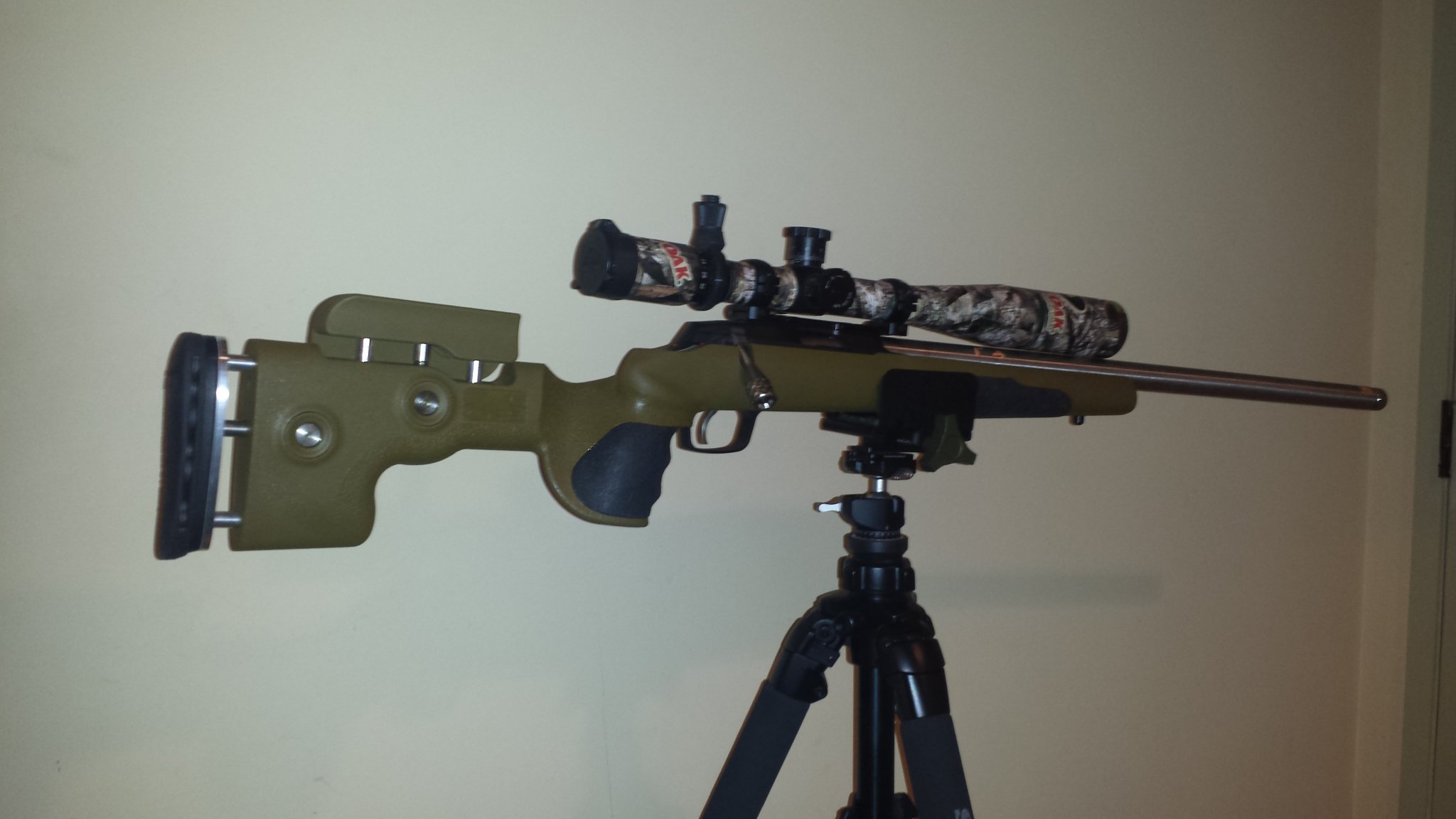

Mine threaded action barrel from my gunsmith open up the receiver to accommodate the 1" oad straight barrel @ 26" before theaded together for very stable shooting.I love long barrel so i go this route "LILJA CHAMBER" 2.I got 1" oad bec. the grs stock channel is 1.250" if i go thin oad barrel it looks like a toothpick and ugly looking for the stock.
Reactions: JKW70 and littlepod
