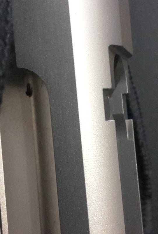

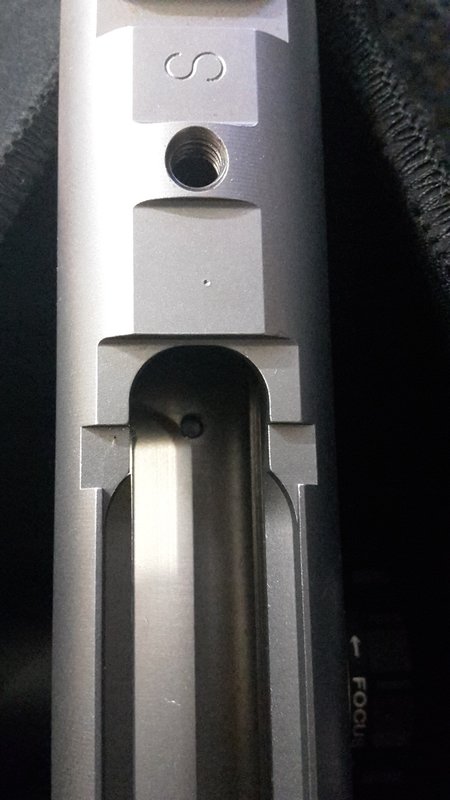

The CTR action has an addional piece milled out under the action between front of the mag inlet and front action screw hole. 5 min job on a mill or if you are ok with a small hand file. It's too clear the top of the mag follower ramp on CTR/TRG mags. It has no effect on being able to swich bottom metals and run AICS style or CTR mags. The Atlasworx dbm is the easiest fix to your dilemma.
Thank you all for the great feedback. I read all comments to suggest that the T3 action with the manner’s t4a CTR stock will work IF I change the bottom metal to. a CTR (either OEM or third party enhanced, like atlas) and then slightly modify (potentially) either action or bolt stop
Pics show milled recess on bottom on factory CTR action.

Thank you for the pics dino67 ... am I reading your earlier comment correctly that if I go with Atlas BM I will not need to touch the action ?
