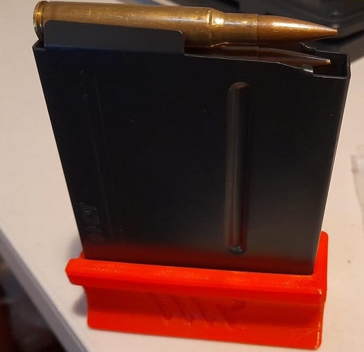

UPDATE
Dave Waters also did extra work and converted MDT 3.560 magazine into 10-round magazine (i.e. suits well PRS game). He 3D printed (1) mag extension, (2) follower and added (3) right size spring.
The same Dave Water' Tikka T3x DBM (100% drop-in) + MDT 3.560 magazine setup accomodates many popular short action (308win, 6xc, 6cm, except 6br calibers not tested yet) and long action calibers (300win, 3006, 6.5×55, etc)
