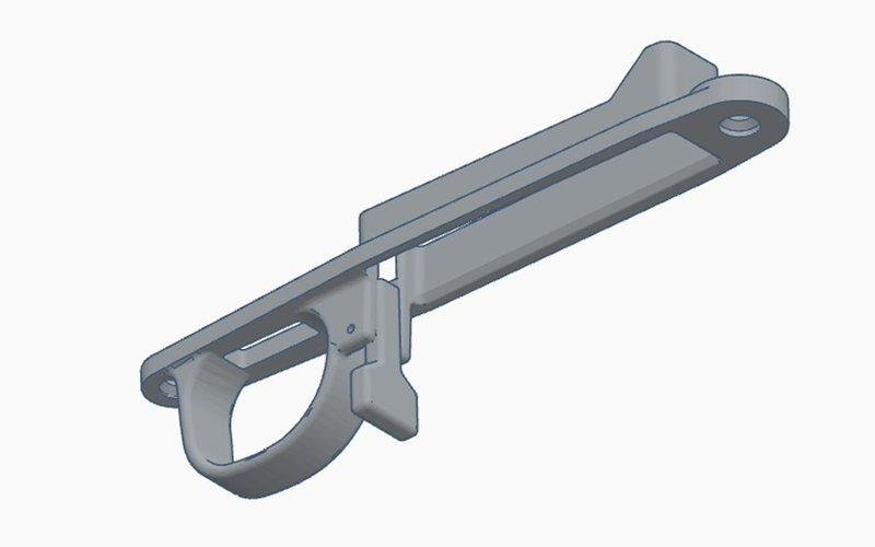

IMG_0261.JPG Well you are in luck. We are currently manufacturing a new patent pending design on Tikka bottom metal for long action calibers that will allow you to run an AI magazine in the factory stock and allows an OAL of 3.500". You can pre-order on our site.
