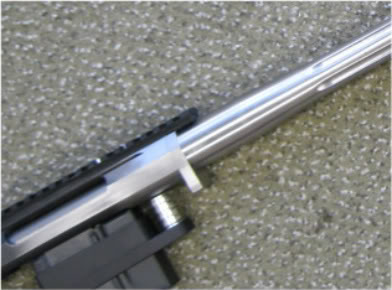

I agree... the aftermarket lug is best:
I owned a T3 in 300WSM that after turning the lug every time accuracy degraded it was rotated (so a total of 4 surfaces) and it was toast under 1000 rds. The aftermarket drop-in steel ones will help, but they wont be as solid as what's in the picture. If you're running the stock barrel, you probably won't notice though. But if you want to squeeze every last bit of accuracy out and are going to the expense of a top shelf cut-rifled barrel.... go with a good lug.
