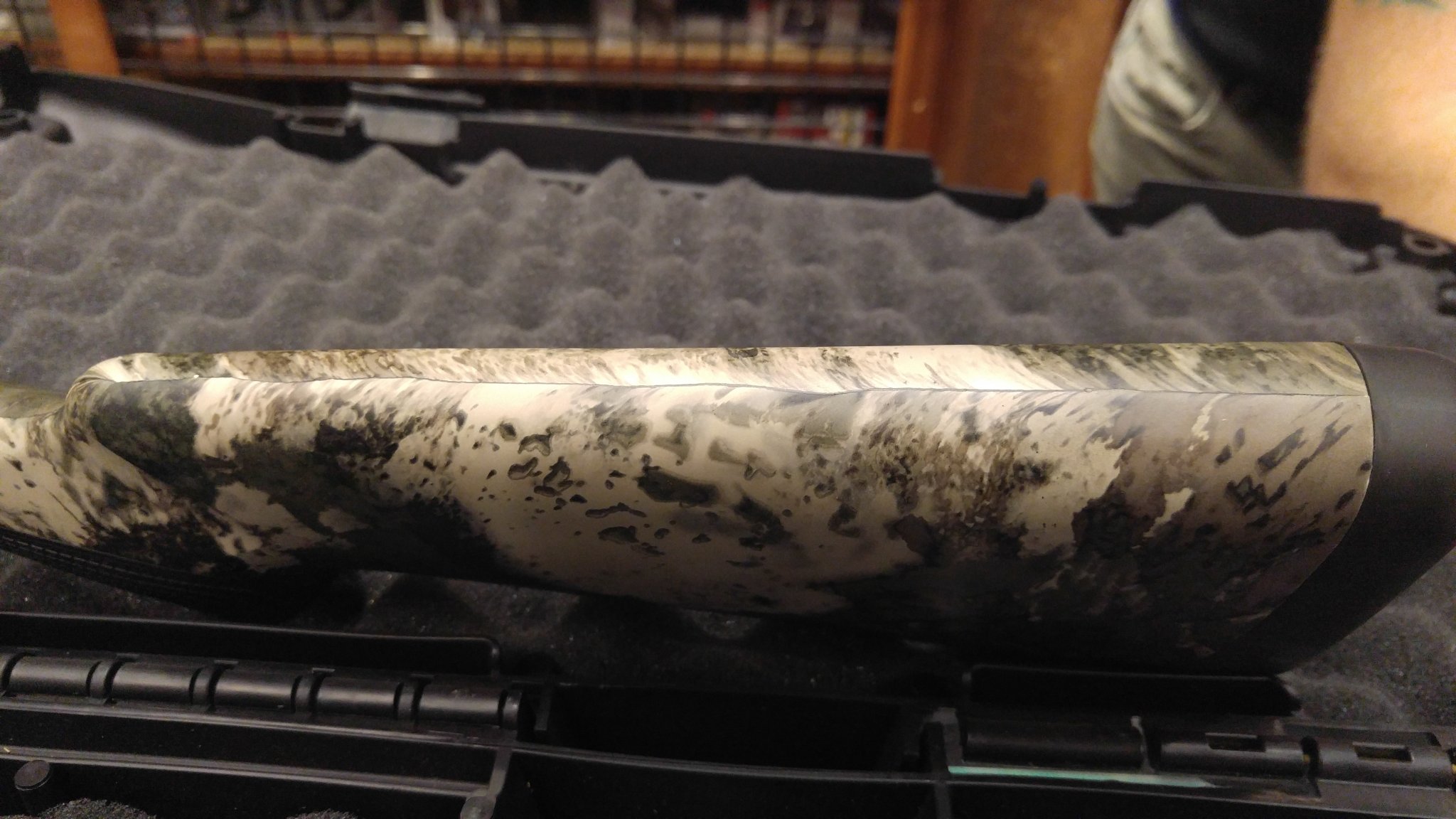

I bought a Tikka T3 Lite in 6.5 Creedmoor from BassPro on the 23rd as my Christmas present to myself. About a week later, I finally mounted the scope and took it to the local range to perform barrel break in and sight in. After 19 rounds, I was passing the cleaning rod through and felt something give. I looked down and saw a crack in the top of the stock from the end of the bolt shroud to the butt pad. I immediately took it back to BassPro, who sent it off under warranty. I just received the call from BassPro that the rifle was back and ready for pickup. I asked the sales rep to tell me what they did, expecting a new stock. To summarize, they stated they found no defects with the rifle and test fired it satisfactory. The crack is only cosmetic in nature and not a defect. I'm rather PO'd and have no real recourse against them except to start flame spraying the customer service department. Do you guys have any suggestions or POC's? Am I out of line and expecting too much? I could accept a scratch or ding if I dropped or banged the rifle into something. But this is a failure of the paint scheme which is easily detected and felt by your fingers and your cheek weld, so it has to be fixed. It's a brand new rifle, duct tape shouldn't be the answer. Open to suggestions.

Also, is it really a crack or just a seam in the paint? And how the hell did you do that with a cleaning rod?

I'm picking the rifle up from Bass Pro tomorrow and will post the letter that was included with the return (supposedly from Beretta) and try and get some better pics of the crack. At this point I have to assume BP sent it back to Beretta. When this happened I thought it was a crack in the mold seam on the top of the stock. However, it may just be the paint seam. It happened while pushing the cleaning rod through, no unusual amount of pressure was being applied. It wasn't from contact between the rod and the stock and wasn't from contact between the jag and the stock. I was holding the stock with my left hand and pushing the rod through with my right hand when I felt the crack. I may have had some side loading on the stock while holding it, but still not anything significant enough to cause the issue.

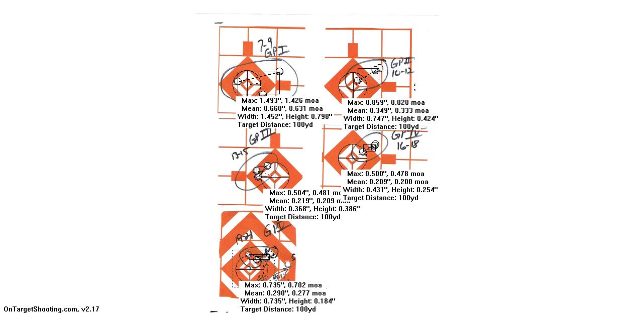

BassPro was actually helpful and was willing to full refund the rifle. To make a long story short, I compared the "cracked" stock to 3 other new Tikka T3X's with the same camo treatment rifles at the store. 2 had the same "crack" and the third did not. I flexed the stock on the third a little and sure enough, the "crack" opened up. I came to the conclusion, right or wrong, that the "crack" was the seam from the hydro dip process, which opening up when the stock was flexed a little. I ended up taking the original rifle home with me and used a littl 1500 grit emery cloth to smooth it out. Shots 1-6 were for sight in after scope mounting. The next 5 groups are below. The first group was >1 MOA, but the rest were respectable for a hunting rifle, with off the shelf ammo. And yes, I was still tweeking windage between groups 2/3, 3/4, 4/5.
