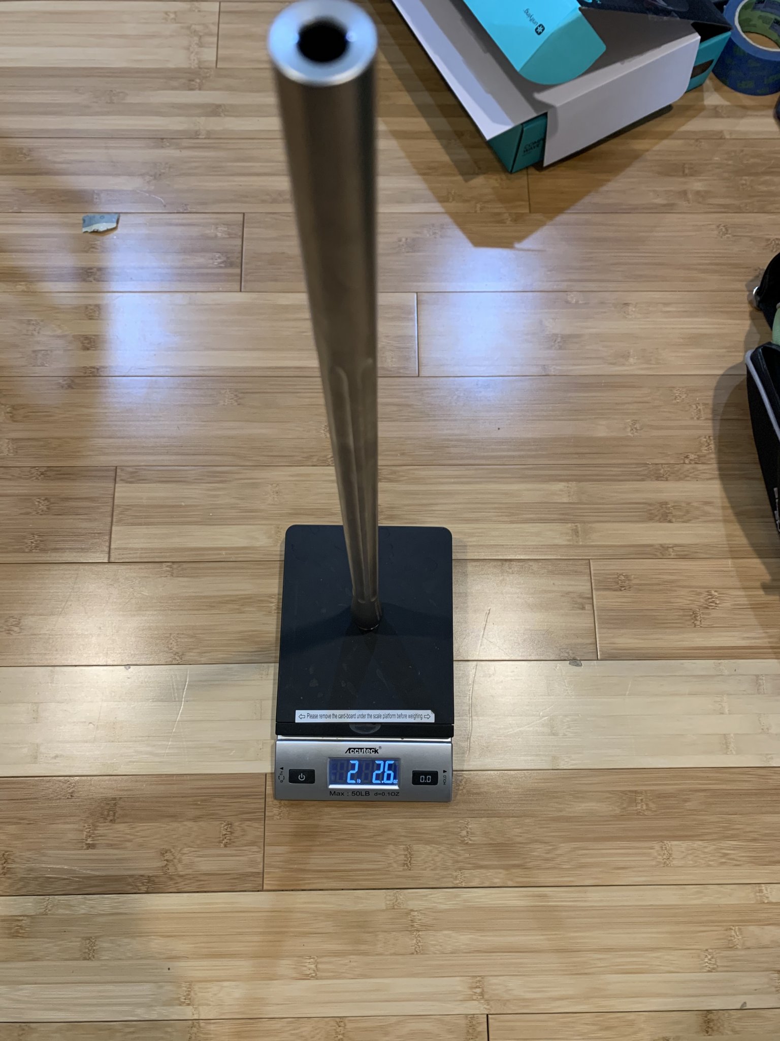

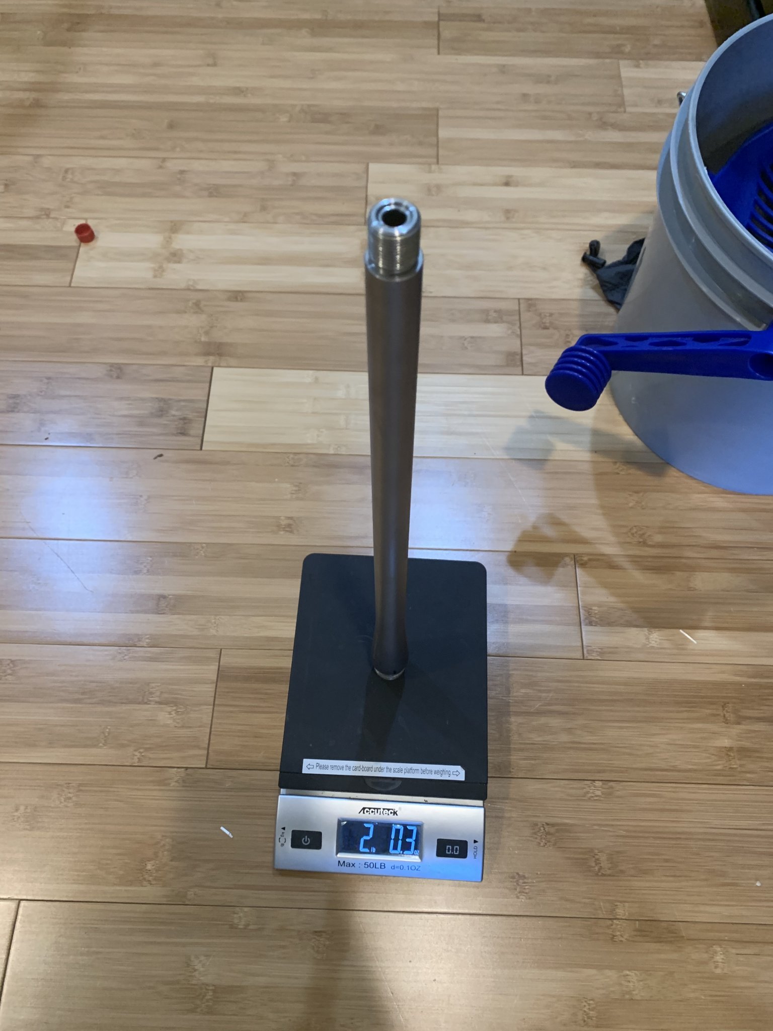

    I weighed my Hardy carbon barrel when it arrived and it was lighter than the sporter barrel it replaced, can't remember by how much. The recent Proof carbon barrels we had fitted seemed a bit heavier... sorry no figures to support. My nacked Rem 700 (with rail) in a 700 gram PSE Evolution stock with 20" Hardy carbon weighs 2.8kg = 6.2lb. Our Tikka with 22" Proof carbon barrel in the same PSE Evolution stock comes to 2.9kg without rail, 3kg with rail. Both in 6.5CM with AICS mags. Goal was a very easy to shoot fully adjustable rifle for our small deer out to 600m.
    I was very sceptical of carbon barrels and refused them for many years, now I prefer them over pure steel barrels mainly because they seem to shoot nicer. There seems to be a good vibration/noise dampening. I even built a 300wm with a thinner 24" proof carbon barrel in the same stock that weighs total 4.1kg including 4-16x50 PMI S&B and is a dream to shoot even 208gr.
    We have Tikka and Rem rifles side by side. Top 300wm bottom 6.5CM 20" Hardy carbon barrel. Second pic the Tikka with 22" Proof carbon.

    20" 6.5 Creed CTR Tikka Factory - 2lbs 15.9oz
    Proof Carbon Sendero 22" 7PRC Tikka Prefit - 2lb 7.2oz (9 ounces lighter than the fluted 6.5PRC barrel it replaced)
    For clarity for anyone reading this that doesn’t know, until just recently the 6.5 PRC were only offered in the roughtech/veil lines with the heavier d18 contour barrels. So 3# wasn’t the lite or fluted superlite contour.
    The counter point to your carbon barrel hate is that unlike a steel barrel you can shoot a ton more through it before it starts to walk, if it even does. So you can have both a range gun and a super light hunting rifle. So if you're buying a single barrel and hanging a can on the end, carbon is the way to go.
    I would never buy a lite or superlite anyway as I have everything threaded for cans and just would never consider one of those light barrels for that application.
